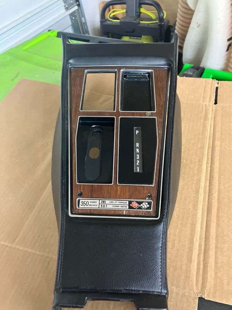

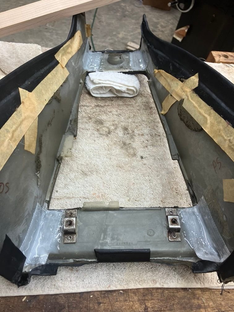

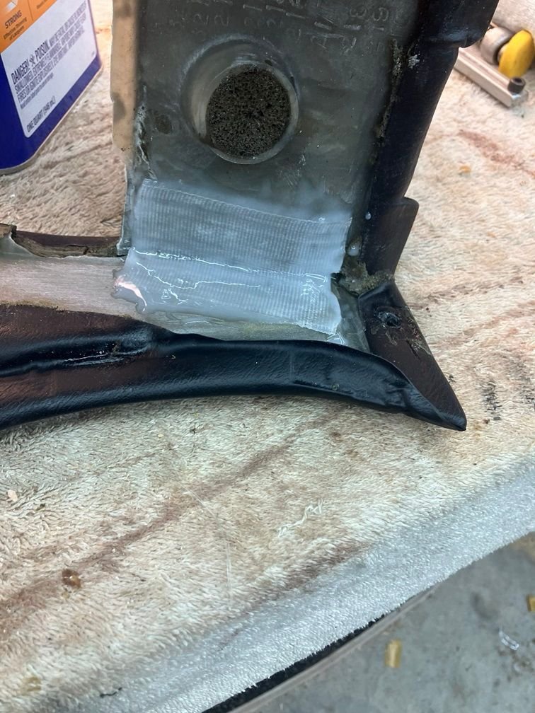

The passenger door window motor is intermittent but at some point the PO took the car to the dealership to get it looked at. In an attempt to troubleshoot the problem the dealer mechanics really busted up the console. It was broken in all 4 corners. By all outward appearances it was in great shape so to save it I went with some fiberglass strips and boat epoxy. It worked, there is no flex in the repair at all. JB weld probably would have done the job too.

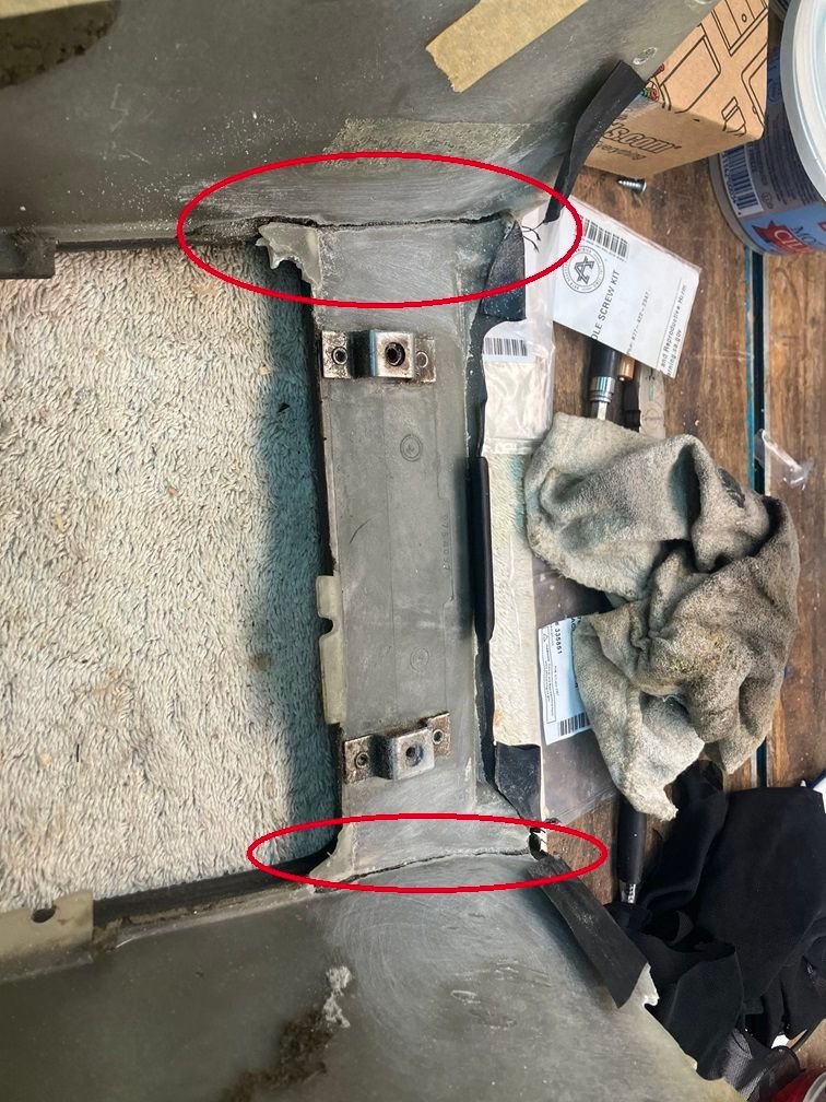

I didnt even realize it was broken until I took it all apart to address some other issues. I got it finished using the console repair kit from Zip (I think) with more epoxy and some small screws. The repair worked, there is almost no flex at the joint. I'll replace the walnut insert before I re-install it.
