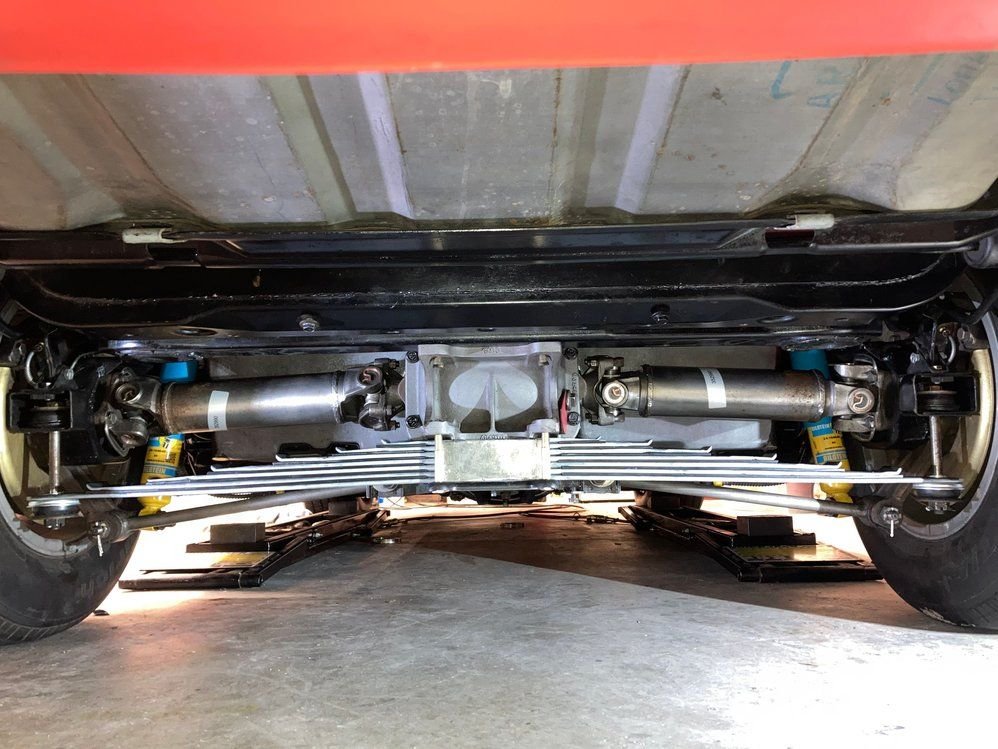

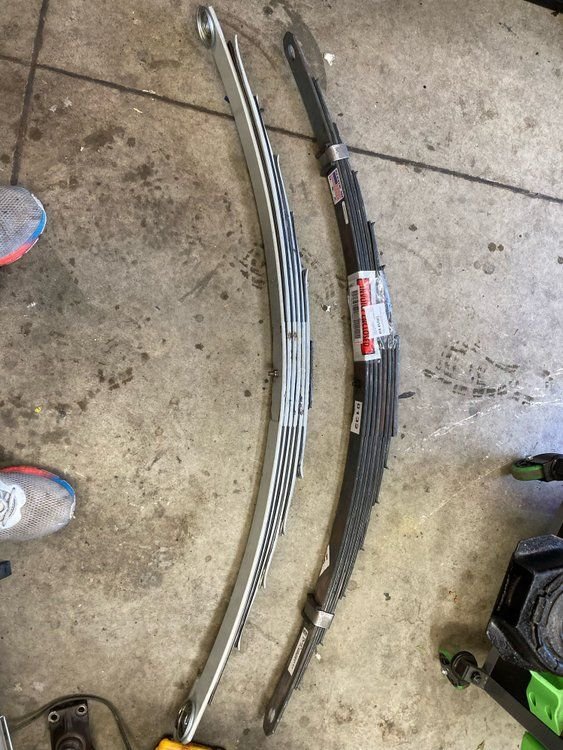

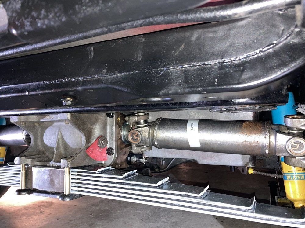

i went steel gymkhana option oem spring (6 leaf originally) from original 9 leaf. It is also much lighter than the original 9 leaf spring. At the time steel was significantly cheaper and available.
here is where i got mine a few years ago if you go that route.
https://www.corvetteforum.com/forums...-spring-2.html
Note the gymkhana spring is also narrower so you need OEM spacers
