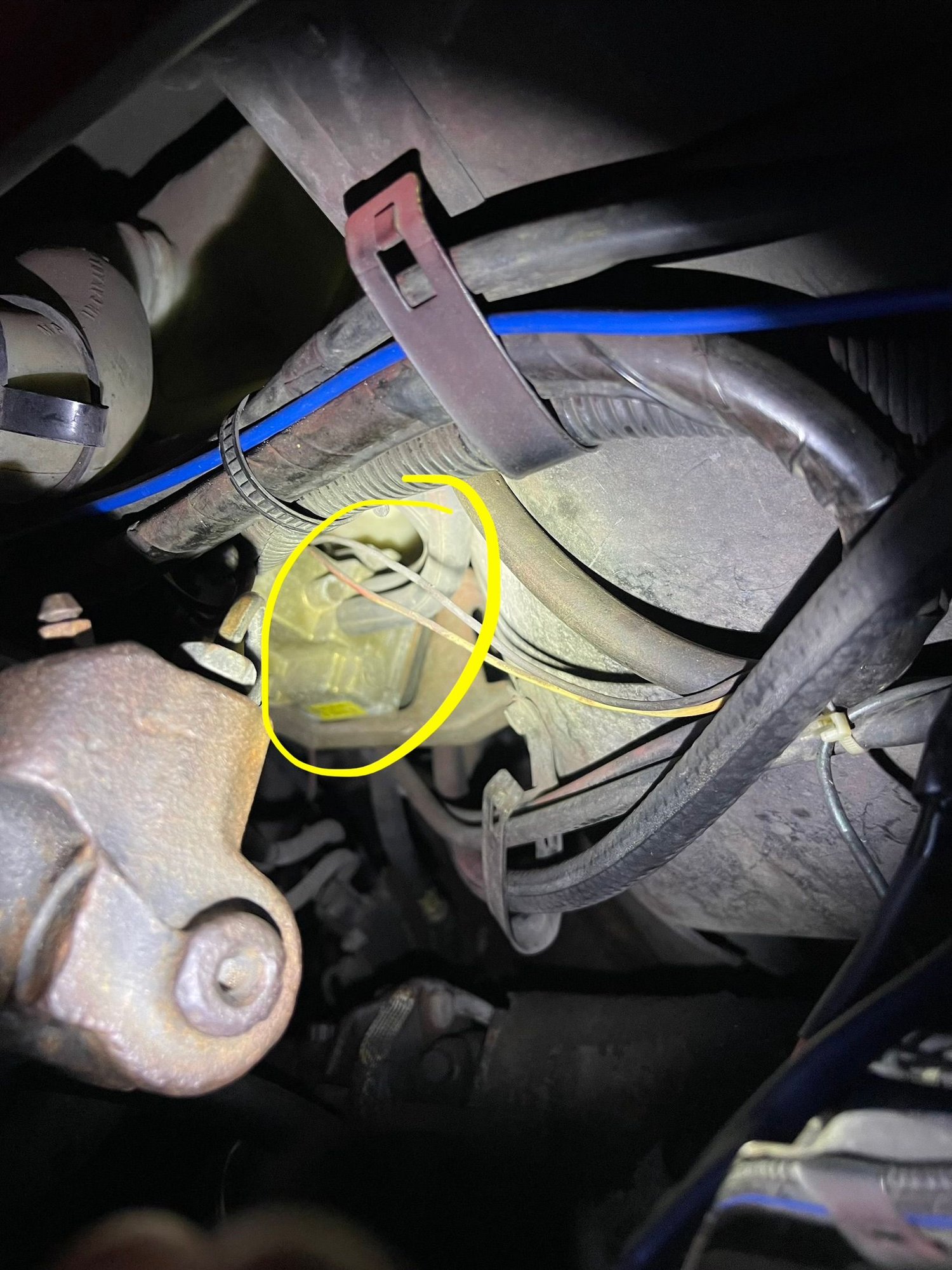

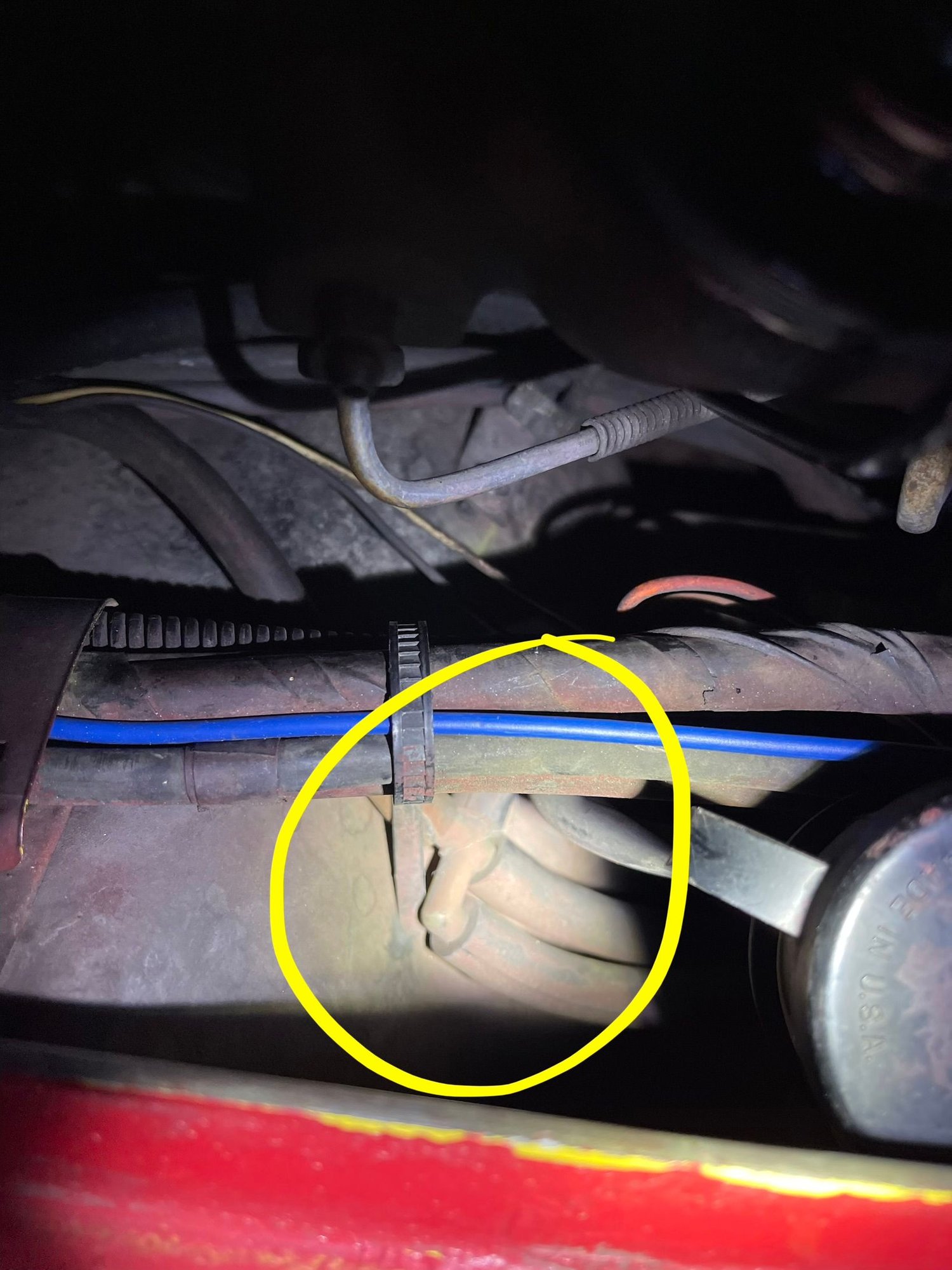

1979 l-48 corvette This vacuum line runs along driver fender, toward front of car. Where do I connect it?
It’s coming from canister under fender
Where do I connect this line? It’s not connected.
Comes from cruise control ports.
This line has a yellow tab. Not sure. Where to connect?
It comes from this tee fitting. Above cruise control.

driver headlight goes up strong.
passenger light barely comes up, have to pull rest of way.
cruise control does not work.
wipers work flawlessly from what I can tell. No fluid will spray out tho, for wipers.

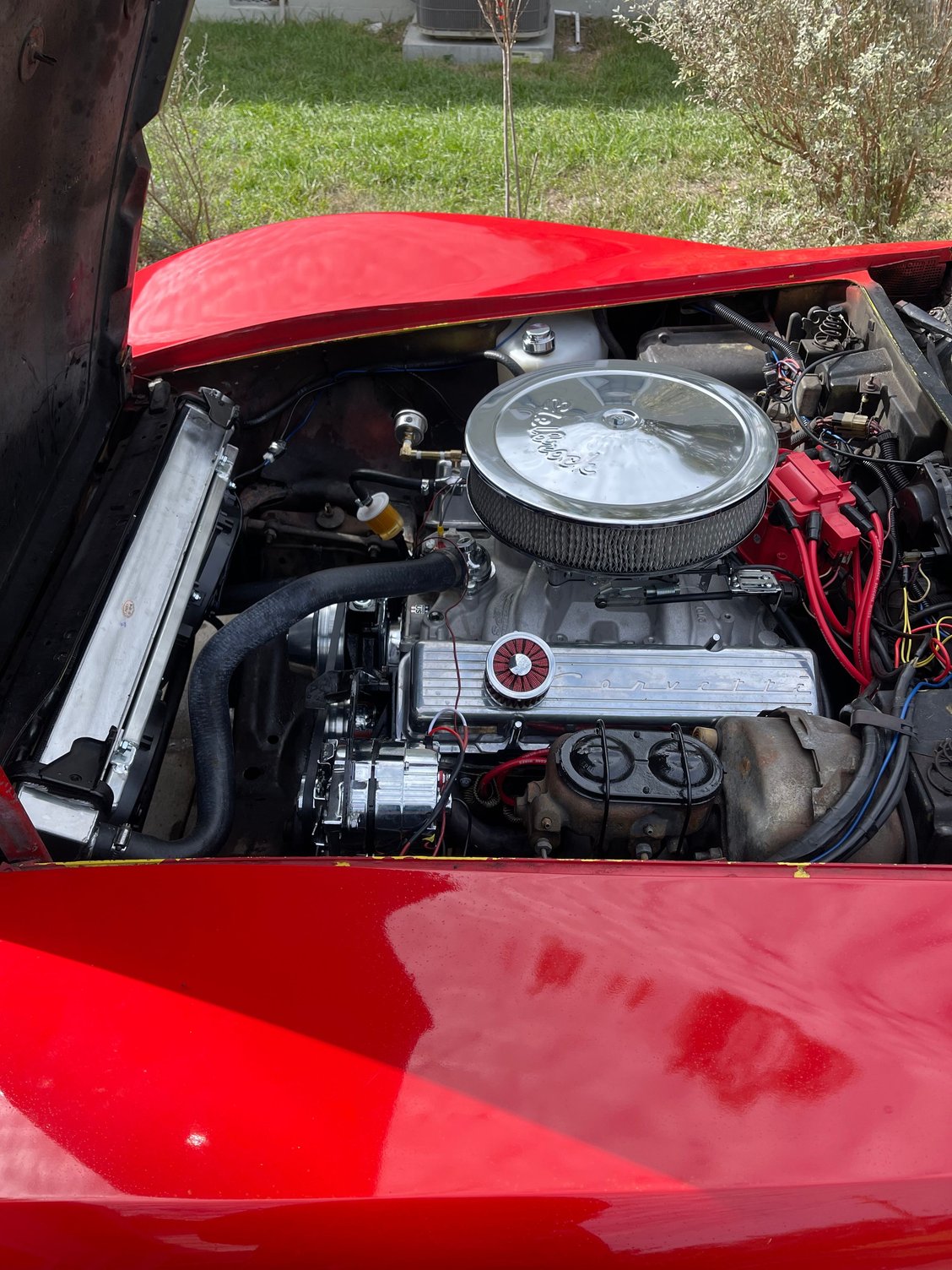

Car does not have working AC. Took old r12 components out to shave weight. I will add a picture of top. Lots of aftermarket components.

Those look to me the Cruise Control vacuum hoses.
You are missing the Servo but the Transducer is still there.

yellow tab hose goes to cruise vacuum pod which is gone from vehicle.
other hose goes to manifold source.
3rd hose I will re trace later today.
that comes from canister and go over diagrams. Again.
I believe I figured it out.
is there any reason for me to hook the manifold cruise control hose back up?
probably not because the vacuum servo is gone.

The stock intake manifold on a A/T transmission car there was a 3 way "T". One port went to headlight switching and HVAC controls, one port went to A/T Modulator valve, the 3rd fead the CC. Just cap off the CC port. There is one hose of the CC that had the wires from brake switch wrapped in vinyl tape that unless you pop the rubber grommet out of the firewall or just flush cut it it might just have to remain tucked away someplace?
