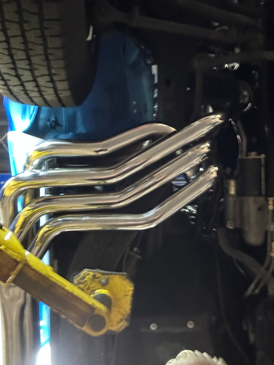

Hello all, first time utilizing the Corvette forum.
I have a 79 Vette, 440 sbc w/ Brodix Dragon Slayer heads. I upgrade my suspension this winter to Ridetech's suspension kit (front/back). I had to cut off my existing exhaust system to install new components and found out that exhaust would fit due to bracket bolted on the rear dif. Got me thinking to install side exhaust....been conducting a bit of research and having hard time coming across side headers that work with angled plugs and raised exhaust ports. I was looking at Doug's headers, D380-SS but when I gave them a call, they Rep cited they won't work on my setup. While doing my research, I came across 1-2 guys on this Forum that mentioned Doug's headers do fit without major issues. Just wondering if anyone has any input on the direction I could take. Seems like no other manufacturer out there that produces side exhaust for the setup I have.
Any input would be much appreciated.
Thanks.

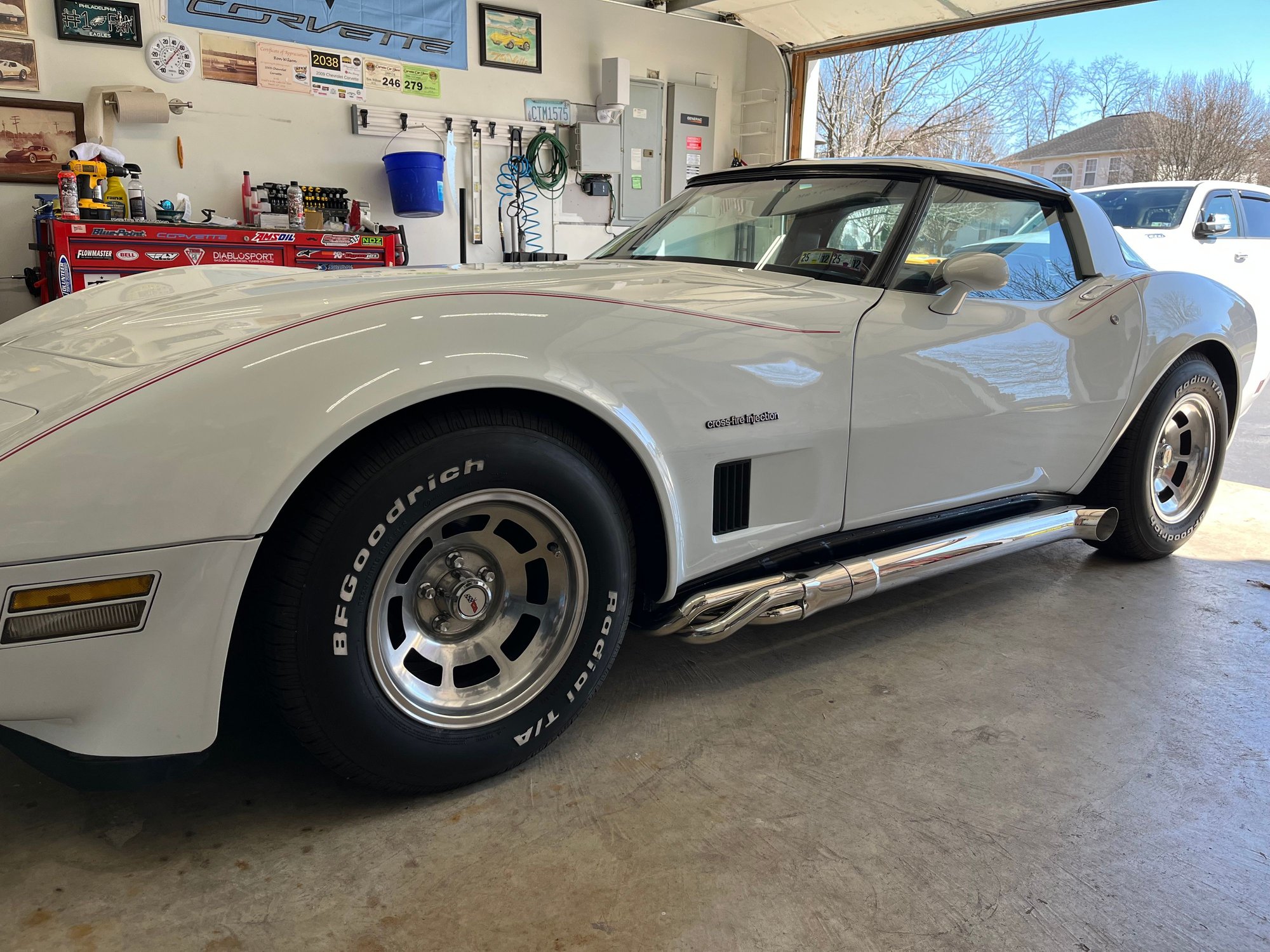

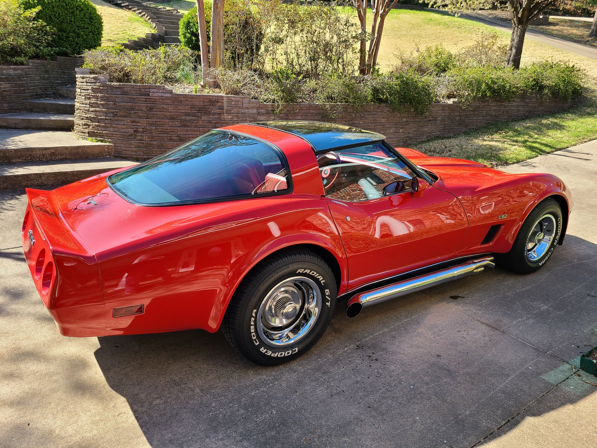

I’ve got the angled plugs, raised port heads (GM SP350/385 crate motor) in my 82. I used these same headers and sidepipes with zero issues. These are the only photos I have right now. If you want I’ll pull the cover off it and take engine photos of angled plugs.

Looks pretty damn nice, I appreciate the photos! Couple more questions: 1. What type of clamp did u utilize to connect header to side pipe? 2. U have any type of insert in the side tube? I've come across some forums citing Sweet Thunder and Spiral Turbo Specialties baffle.....any thoughts?

Raised ports, but straight plugs here. No issues either.
The pipes themselves have a built in clamp on the inboard side to tighten it against the header collector. As for the inserts I’m using 776-D950 glass packs, the “medium” option. I think it sounds pretty good, but definitely wouldn’t want to spend any serious amount of time with no inserts at all.

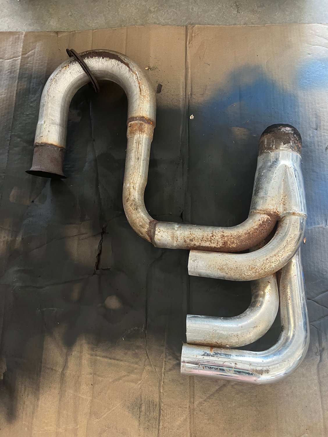

So I just ran across this thread and want to show you my side pipe setup, I don’t like it, I think the po did a pretty shady job just to add a set of side pipes. I feel like this is restricting a lot of flow….I would like to replace this setup with Doug’s headers. It’s a 79 with a 350 crate motor with vortec heads, any thoughts or recommendations would be appreciated.
thanks,
Buzzard

correct Redneck, I have raised port aluminum heads with angled plugs which Doug’s said wouldn’t fit, but they fit fine. No issues with any fitment in engine bay.
My cousin owns a shop so he installed them and did not use T bolts in frame , he fabricated the rear bracket off side pipe to bolt to a bracket he made and welded that to frame. So mine are basically held on with the headers at engine and the rear bracket off side pipe . So a year in zero issues.
