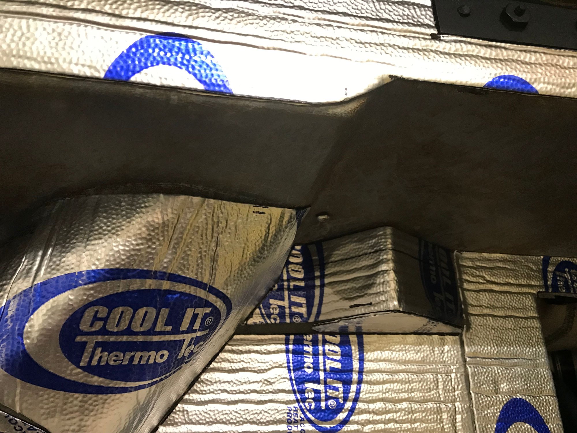

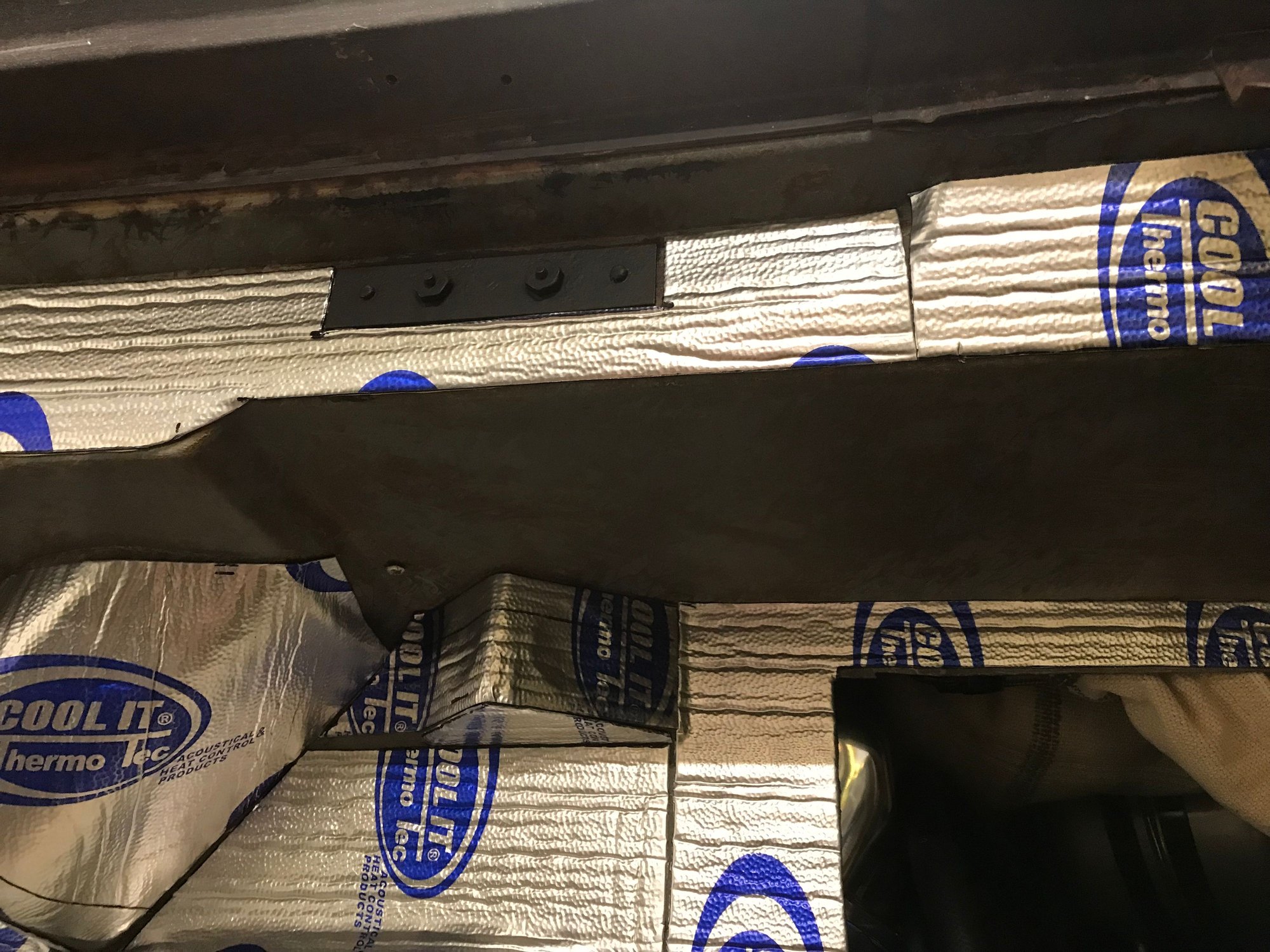

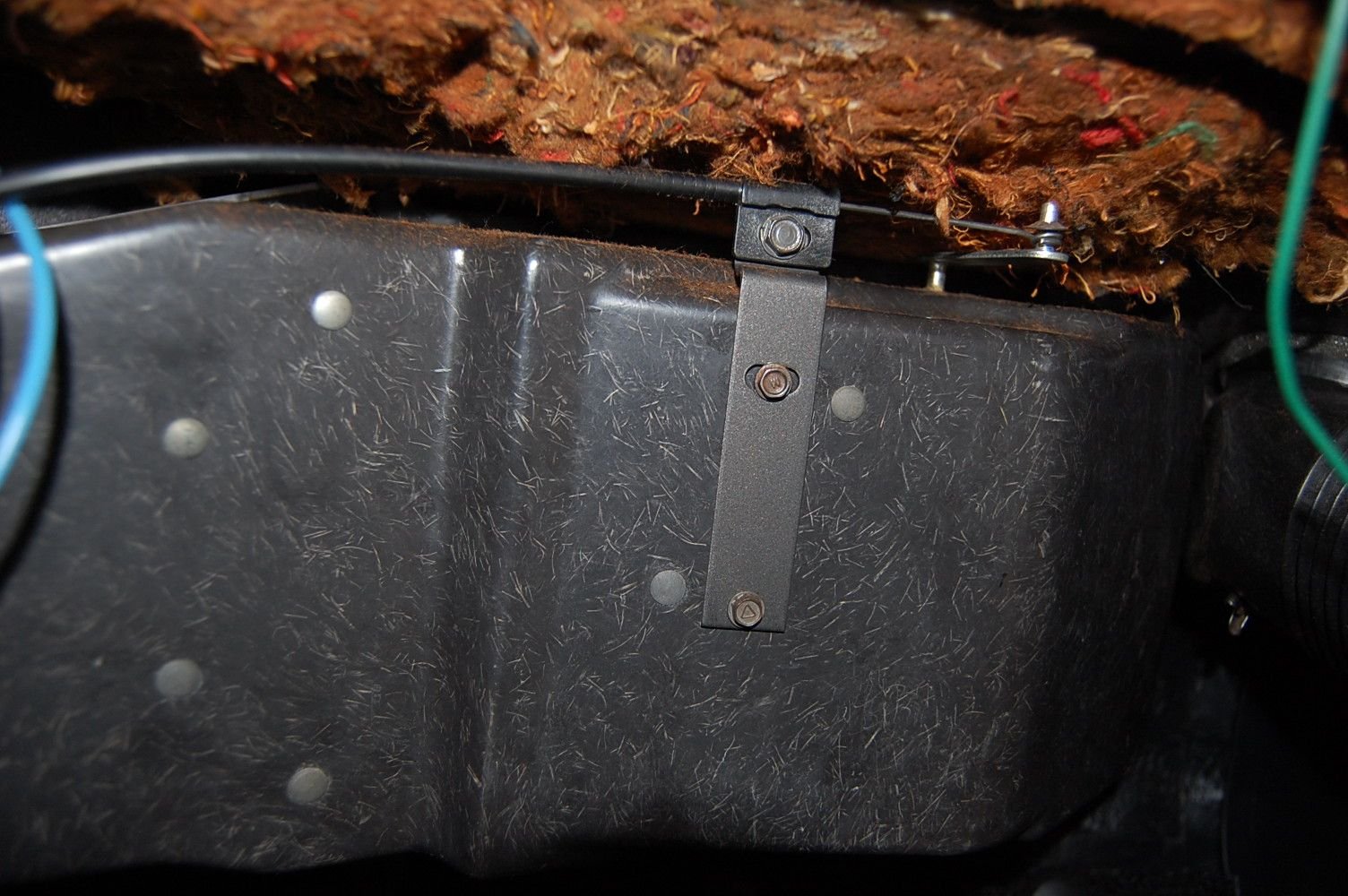

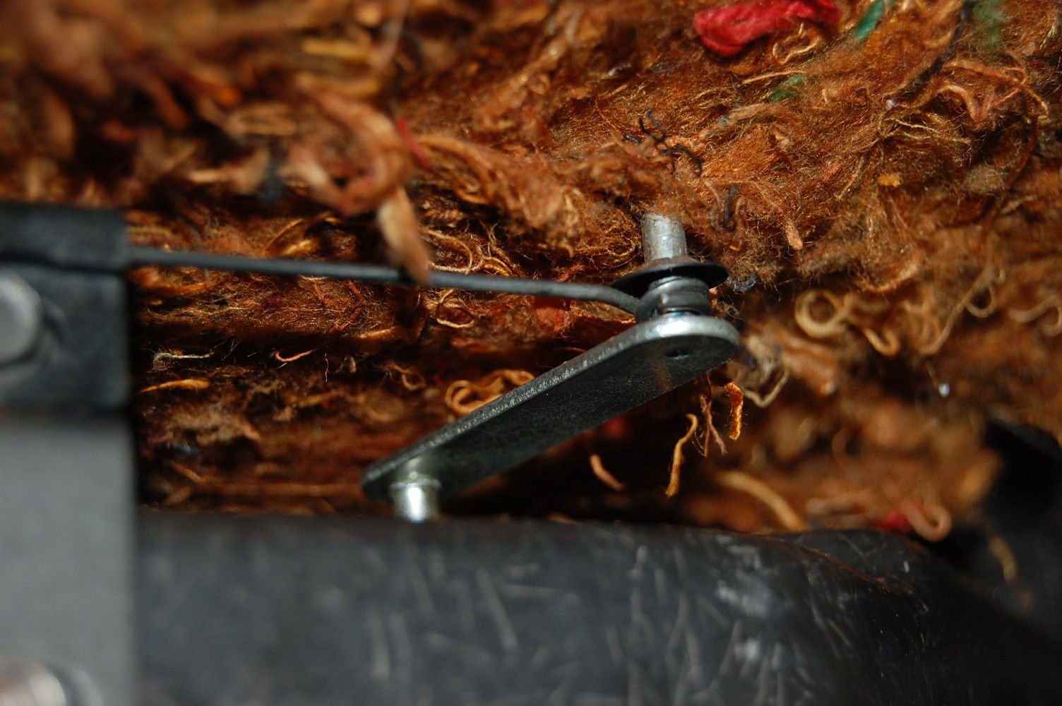

These are the areas under the wiper tray I’m wondering whether they get insulation or not.

Hello Greg,

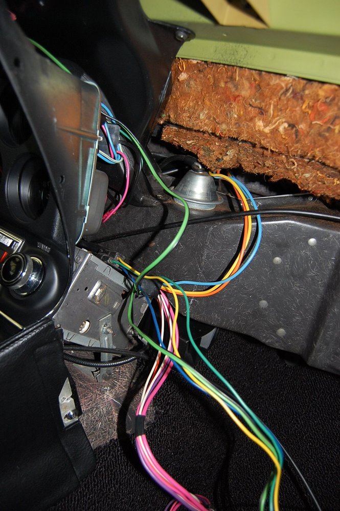

I have only a couple photos showing the jute mat in place.
Sorry.
Regards....

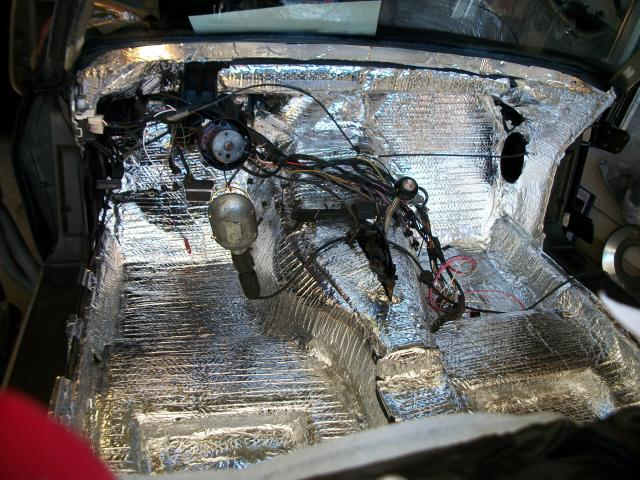

Nowhere near original but it insulates and sound deadens very well,,,1/4" thick...two layer would turn the cabin into an Igloo. I insulated EVERYTHING....
iNCLUDING the underside of the deck lid...then cover that with headliner material to hide the foil.

Originally Posted by Alan 71
Hello Greg,
Sorry.
Regards...
Thanks Alan.
Those pictures show me exactly what I was looking for.
Thanks again.

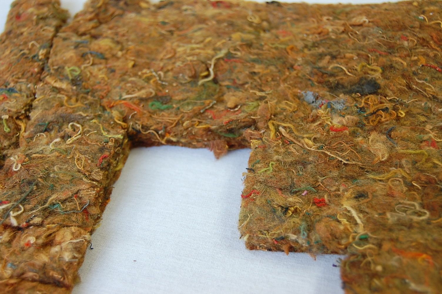

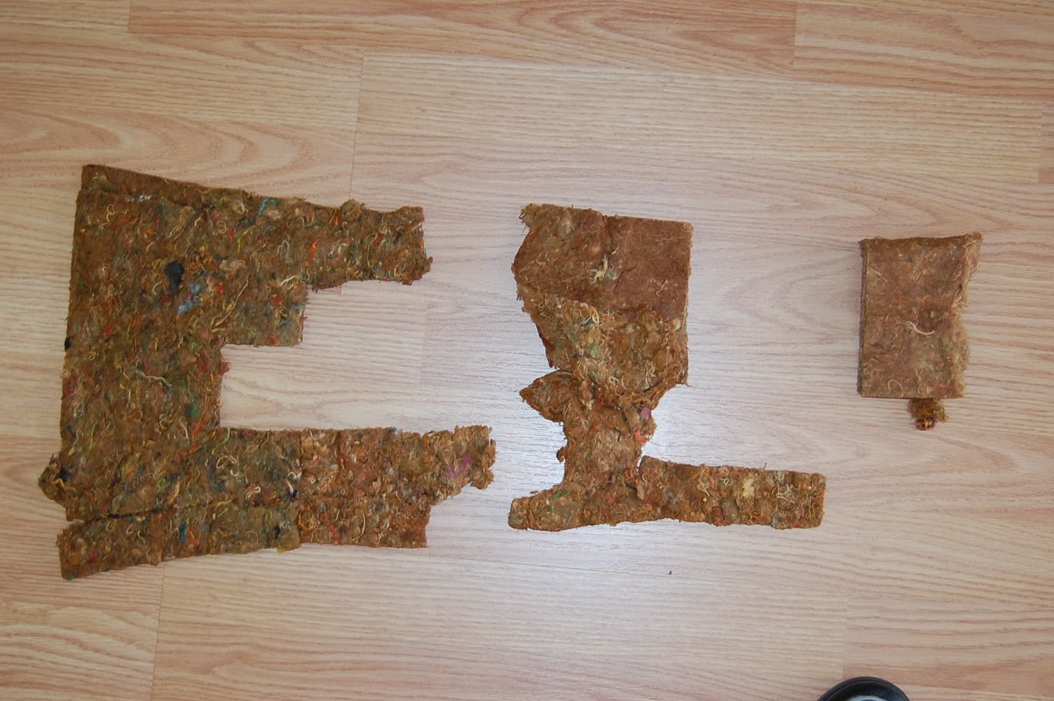

Here's a picture of the jute insulation that was on the top of the transmission tunnel.
Die cut but still somewhat torn and ragged.
Regards....

Thanks Alan!
Those shapes look familiar.
For the past three days I’ve been up under the dash with pen paper and a measuring tape making stencils for the firewall insulation.
I should be finished attaching all the pieces today.
Then I can start taping all the seams and edges with aluminum tape.
Sometimes I’ve felt like a pretzel so it’s a good thing I’ve kept in shape.
I’ll post a couple pictures when I’m all done.

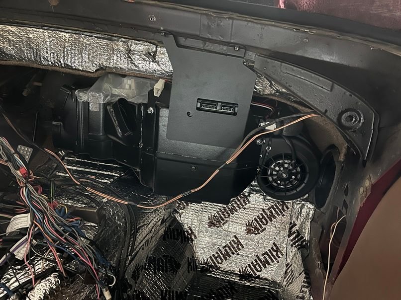

Greg,
I looked at some photos when I was doing my VA and I have a 1/4" carpet looking padding under the wiper bar area right where the VA main unit sits and I didn't have any issues with the install. You should be fine with the stuff you're using. Hopes this helps.

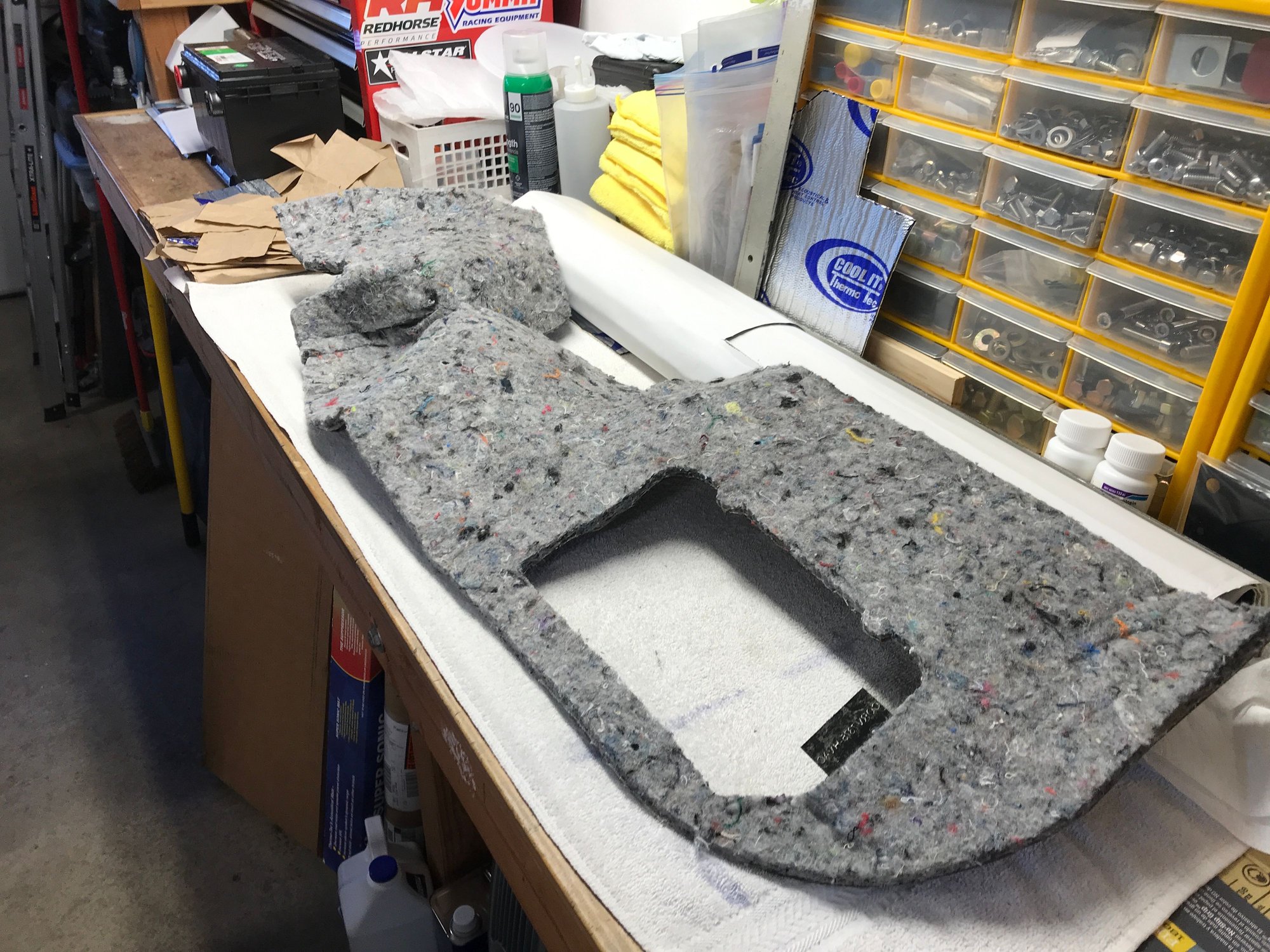

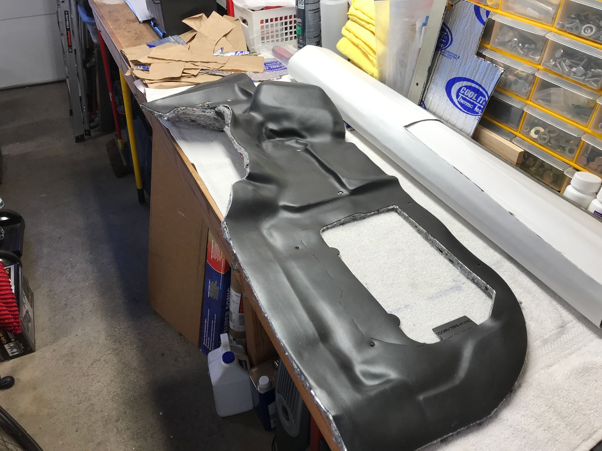

I also purchased this piece of reproduction firewall insulation from Corvette Central.
It came with the separate piece for under the brake/clutch pedals which got cut apart trying to get it fit.
I won't be using this piece and can’t see throwing it away.
If anyone wants or needs it for a 73, just claim it and it’s yours.
It works for non ac cars and has the areas marked for the cut outs for ac cars as well.

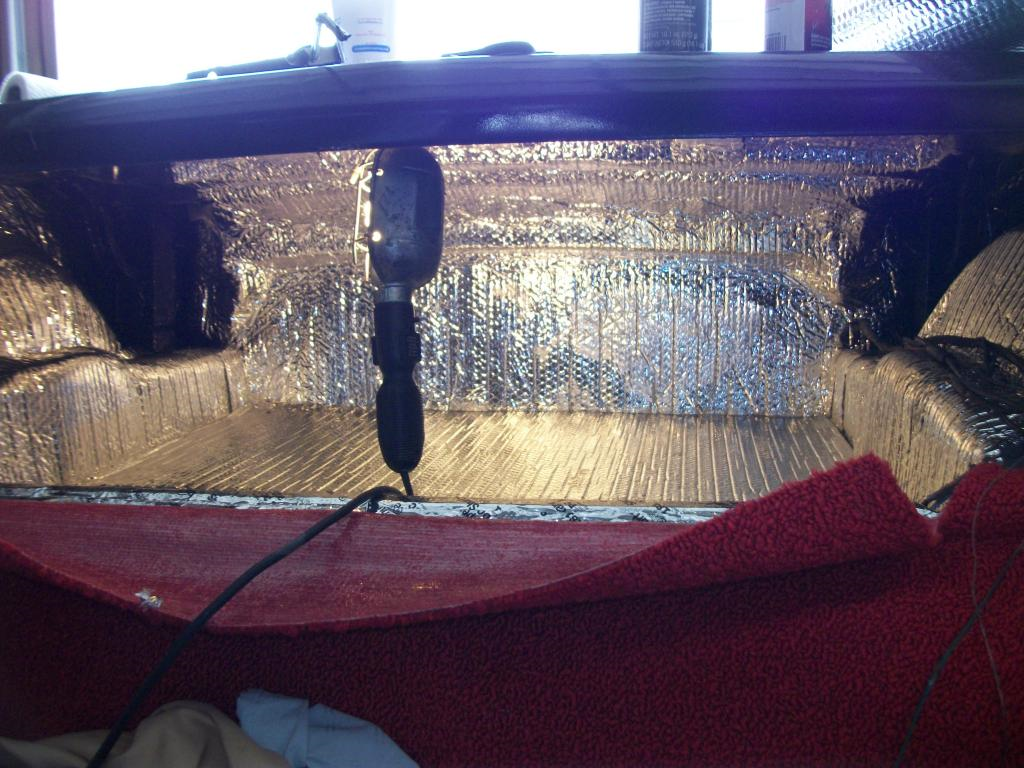

Thanks for taking the time to do that.
It does help so I won’t worry about getting things to fit properly.

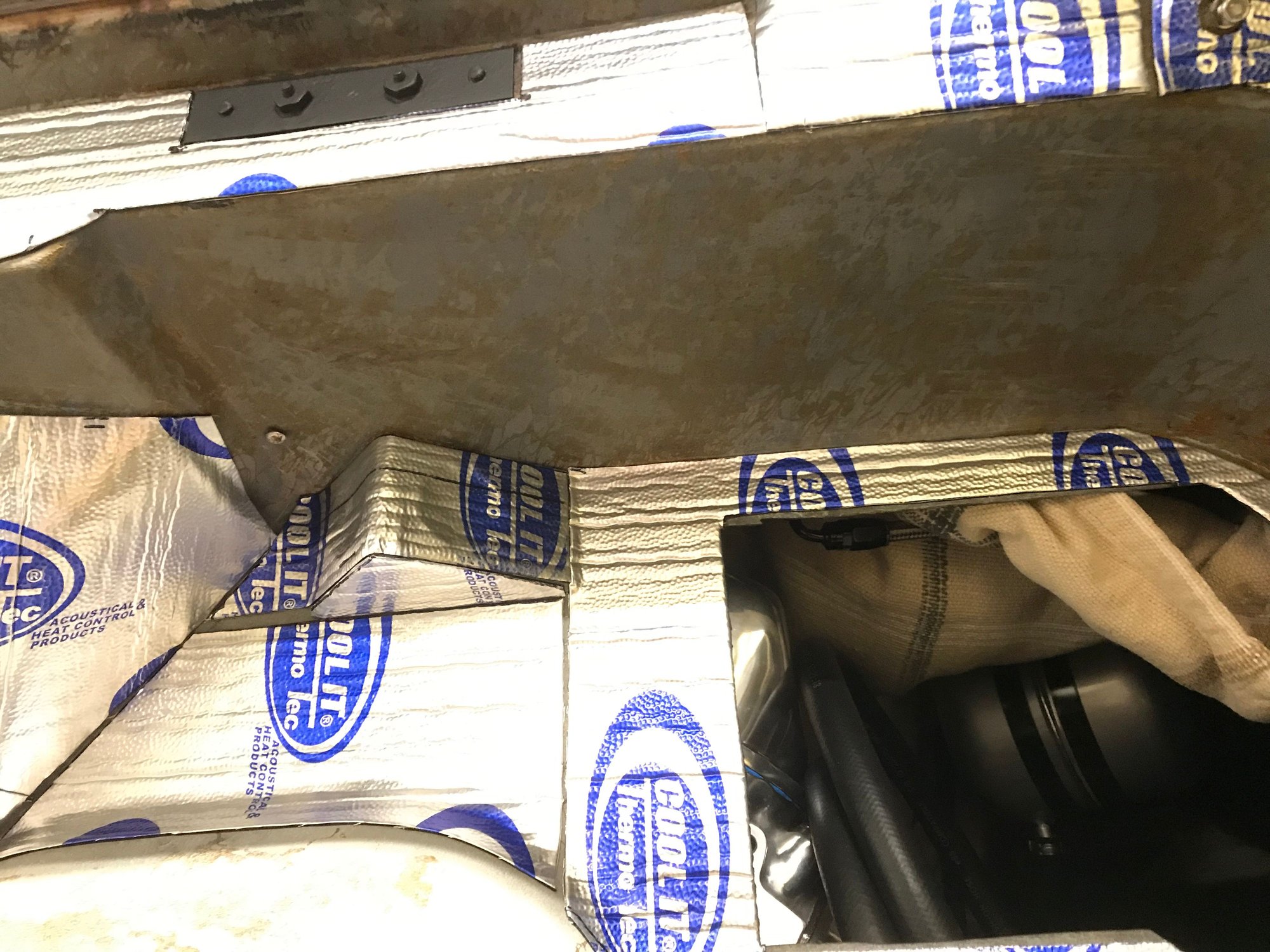

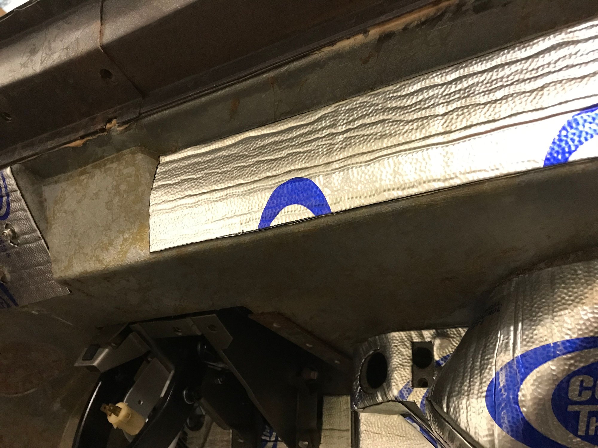

Here are some more images when I did mine. Kind of shows what you're in for.
To Upper Firewall Insulation Installation Question?
