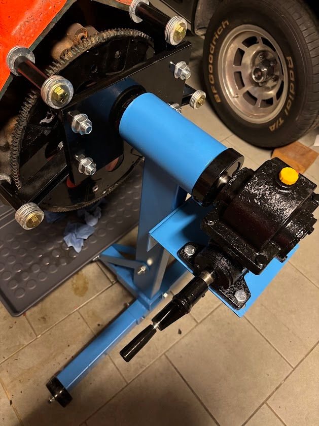

I put my engine on a stand some weeks ago. The stand has a special handle with a geared rotating head to rotate the engine.
It has a 400 kg (880 lbs) capacity. The bolts are grade 8.

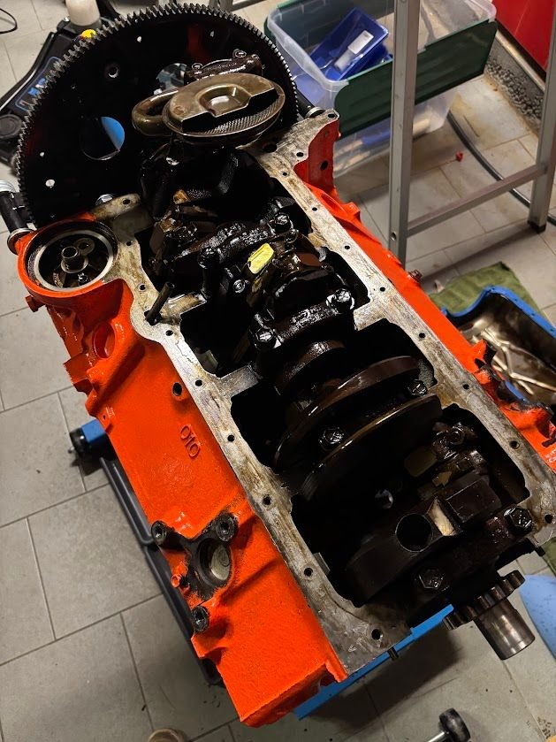

I'm somewhat hesitant to turn the engine. It's a Small blok 350 but without the fluids, heads and intake etc. but it seems so dangerous to turn it.
Is this really that safe?

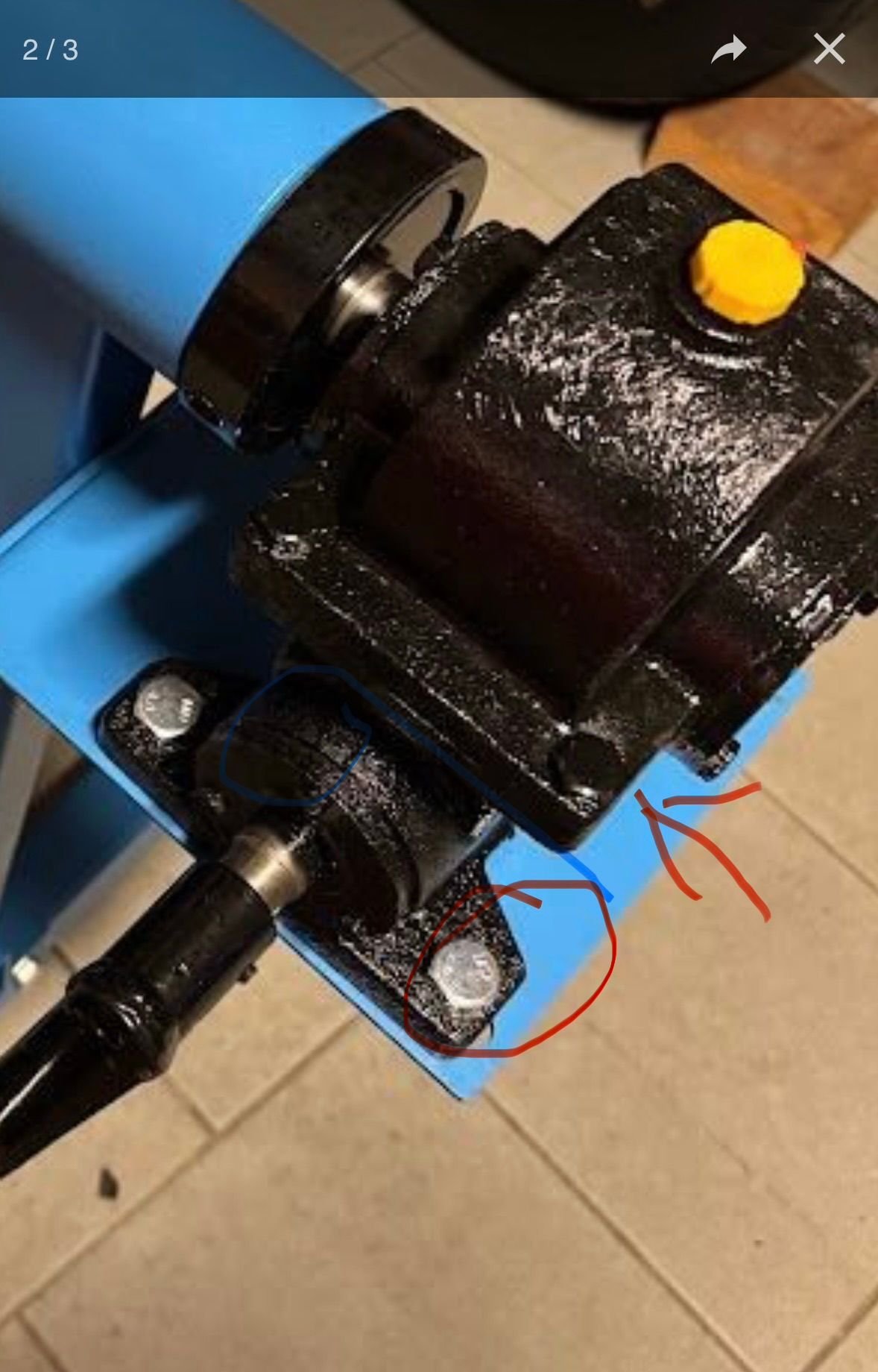

I marked two spots on the picture I would be concerned about. One is the rear bolts where they go through that thin plate. Lot of weight load there. The other is the actual crank housing. Looks like it is put together with some smaller bolts.

For what it's worth, some of the bolts and nuts visible in your photos are NOT grade 8.

first, the 4 small bolts holding the geared assembly down are not taking the full weight of the motor. the bearings inside the shaft around the mounting plate shaft are taking the weight.

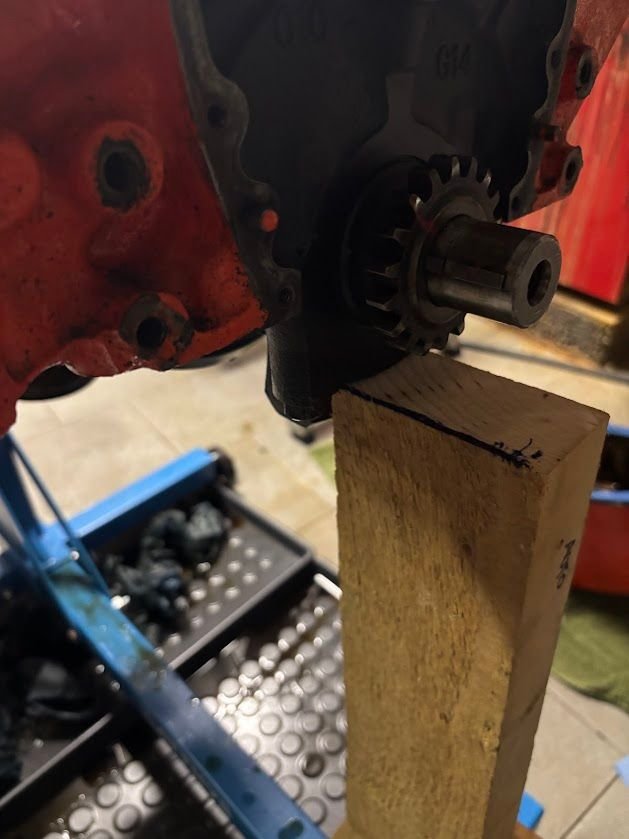

I decided to use a jack and some blocks of wood to 'let it rest' on the front bearing cap (Not sure that's the right name). (Just a little bit to give me peace of mind when working on the engine loosening bolts, forcing parts, etc.)
When turning, the woodblock is removed. And when in place (for a longer time). I install the wood block again.
