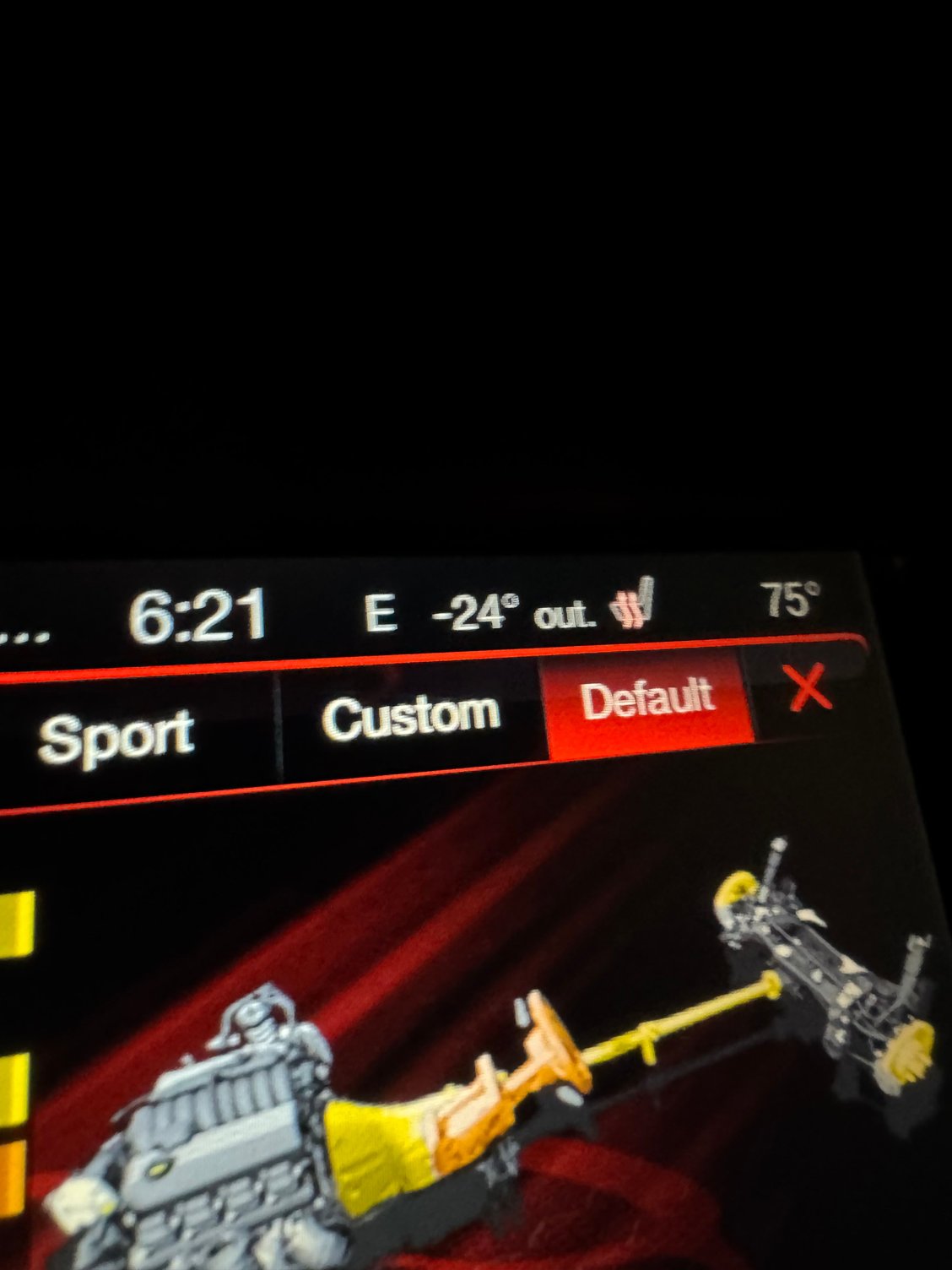

-24....OUCH.... that's gotta hurt

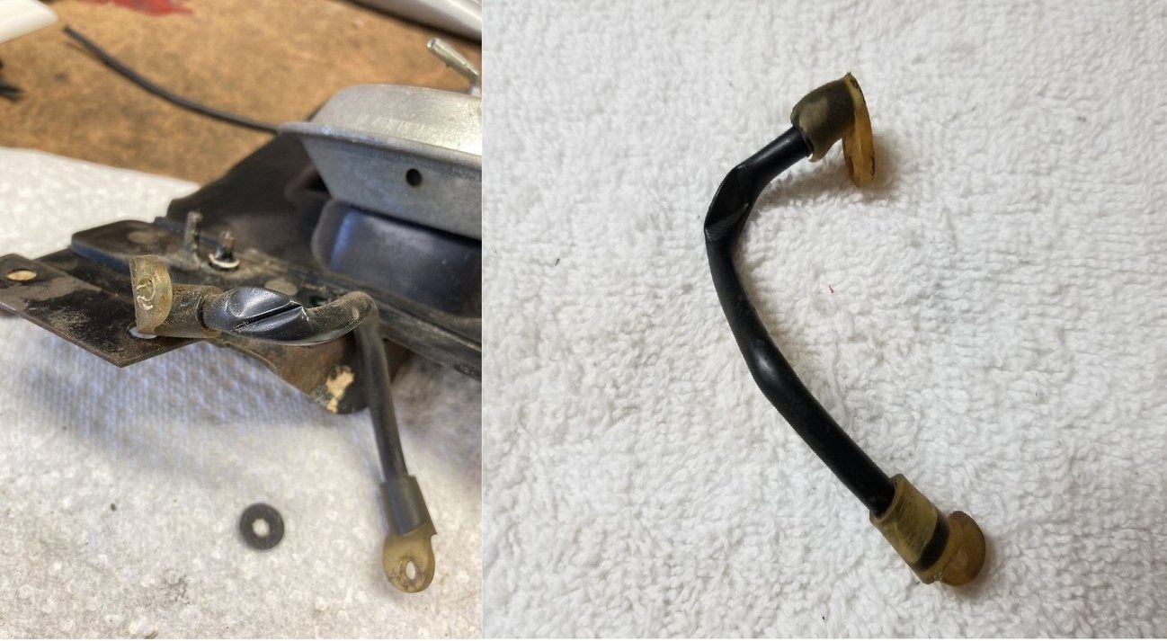

I noticed the recirculation accuator was not working so removed. The vac hose on the blind side was pinched closed, probably installed that way from the factory and never worked.
Are you talking about this short hose?
If so yours is the 3rd that I know of...
Smashed in almost the exact same spot...
From a 1979 & my 1977 in the photo below...
Old Feb 7, 2026 | 06:13 PM
greaser2's Avatar
greaser2
Posts: 56
Yep, exactly what mine was.
