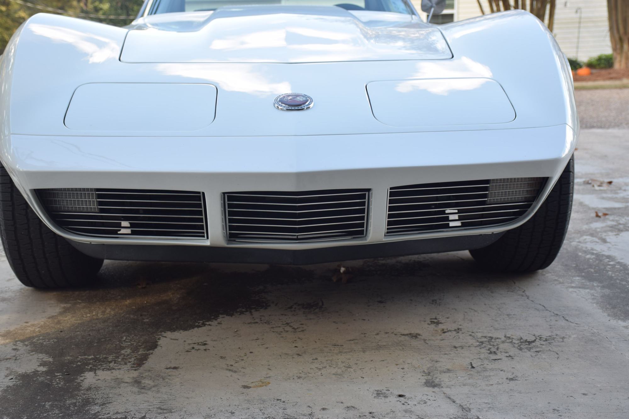

I replaced mine with Tru-Flex even a lot of others have had problems, I diidn't. As mentioned above, make sure that you fit the bumper and not the body.
Mine fit fairly well and needed fitting on the pasenger side mostly as seen here:
After fitting:
Now after 11 years:
