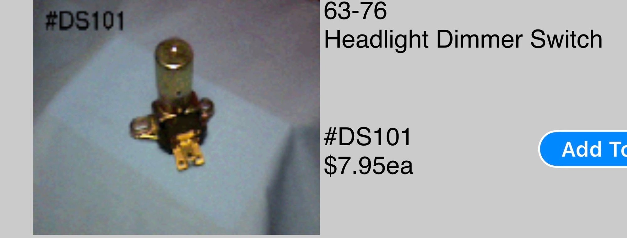

Hello, I hope this is the appropriate place to post this thread, but my headlights went out and not sure what to replace. I was driving at night and all of a sudden all 4 of the raised headlights went out. I know there isn’t a fuse in the box under the steering wheel for headlights, so is it the headlight switch next to the wheel? The **** still functions for raising and lowering the lamps, the dashboard still lights up and nothing else went out. I can still use the foot operated high beam lights but it requires me keeping the foot on the button the entire time. I preemptively ordered this part, so let me know if you think it’s the right one ! Appreciate any and all help

From your description, you are getting power to the dimmer switch so there’s nothing wrong with the headlamp switch. I would remove the connector at the dimmer switch and clean the contacts. If you have a multimeter, check the continuity between the input pin on the dimmer switch and the output pins (one for high beam, the other for low beam). Given you have high beams, albeit with the switch depressed constantly, you’ll have continuity on one and not the other. I suspect you have a faulty dimmer switch.

The switch the OP is looking for fits 63-76.
Bair’s Corvette has it for $7.95.

Your local NAPA shop may also have it. Jerry
