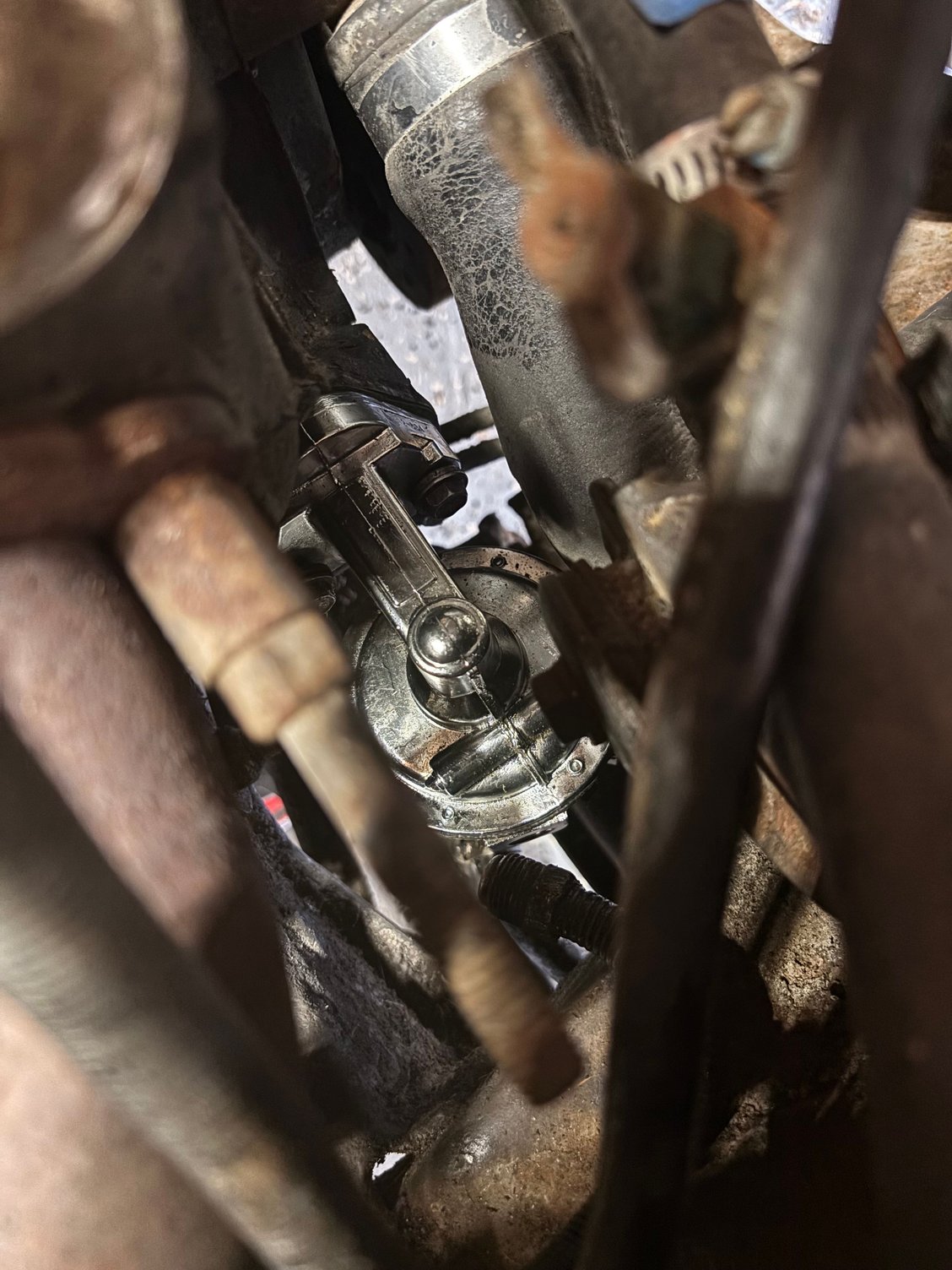

I just got a Holley mechanical fuel pump for gen 1 sbcs, but it seems like there’s no space to route the fuel lines, since the connections almost hit the frame, does anyone have any tips on how to run them?

Maybe a view from below? I can't see a thing.

Did you purchase a fuel pump to fit your year of Corvette? Or did you purchase a generic Hotrod 350 Chevy pump?
Just because a part fits a Chevy, doesn't mean it fits your Chevy!

Yeah, it’s probably that, I just looked up 1st gen 350 fuel pump on summit and got one

Just a note on fuel pumps, I saw above you ordered the newer style. Your fuel pump appears to be the bolt-on cup style that ran through '66. In '67 Corvettes went to crimp cups which are smaller -- and probably allow more room for connections. These were used on the last of the 327s and 427s.

Get a stock replacement pump from NAPA. Fittings are on the bottom and it works great. No need for chrome down there.

Yeah I just returned it a little while ago and got an oem style pump.

If you loosen the screws that hold the 2 parts together it rotates. I had the same pump on my 80 with a small block. After I rotated it the lines fit perfect.
