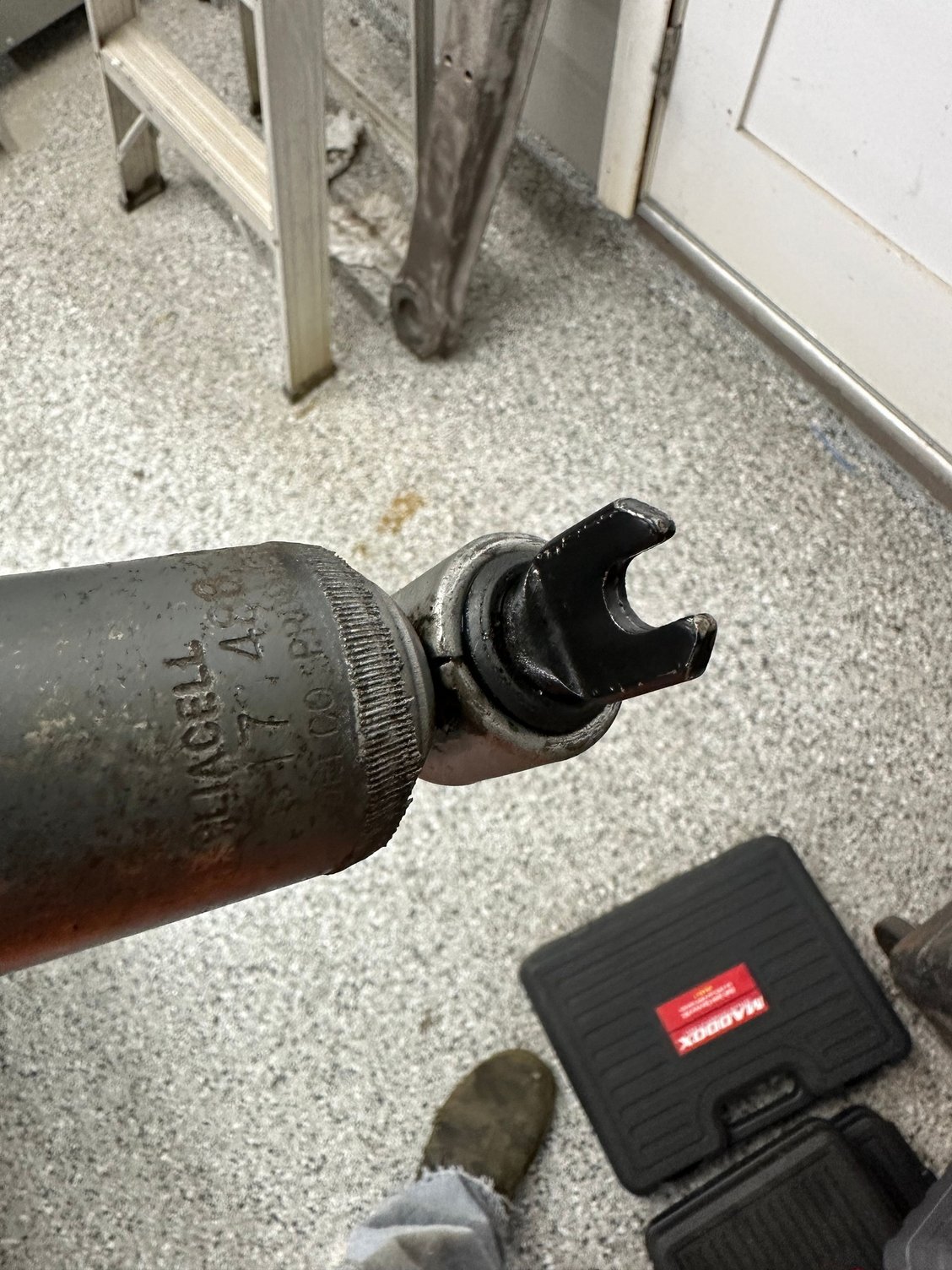

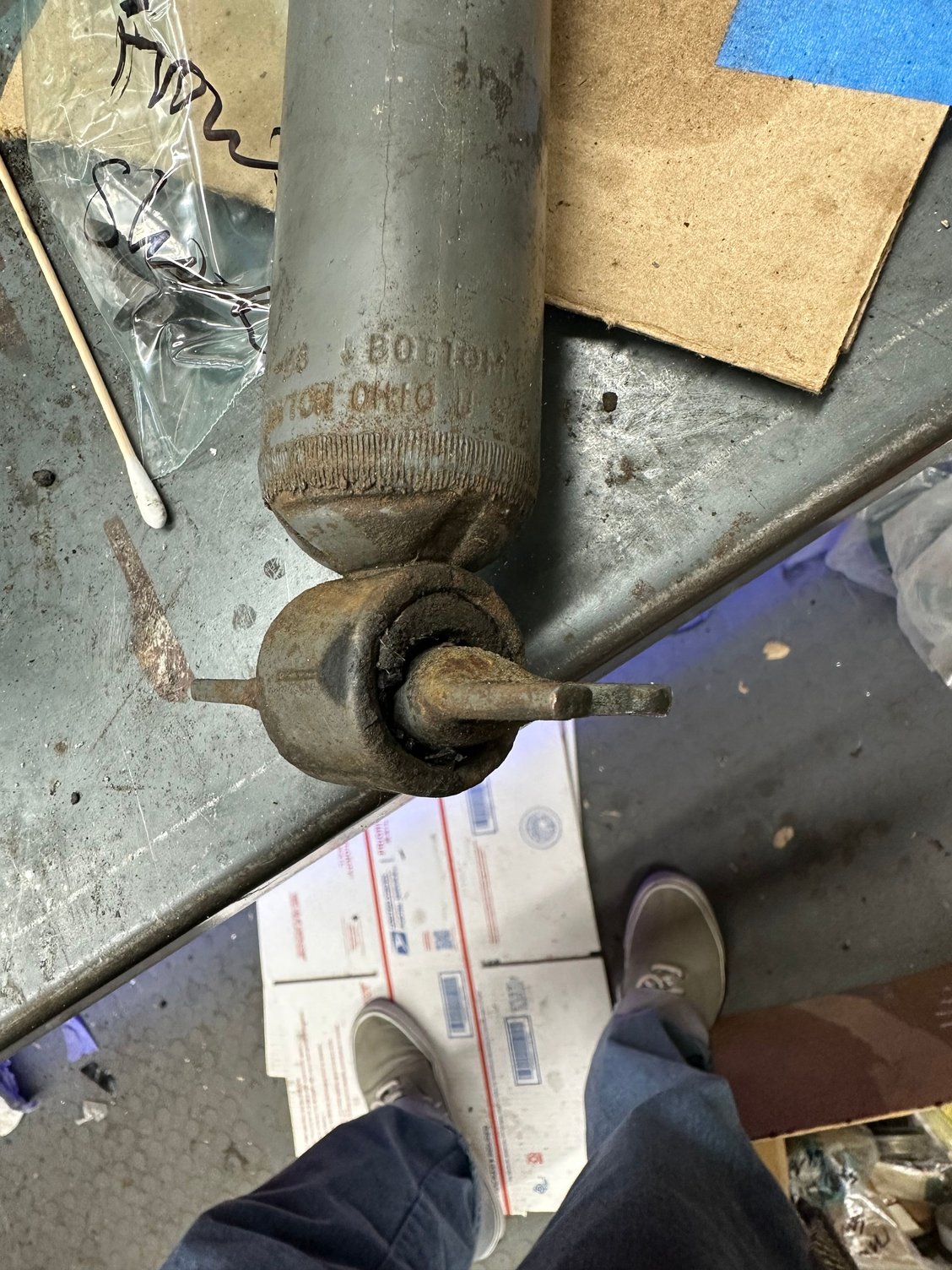

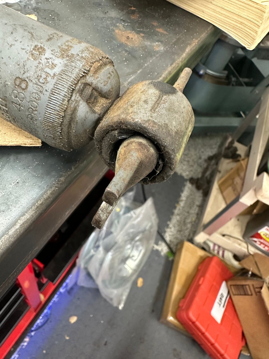

I should probably have my Man Card revoked for this, but curious how these lower rubber bushings on the front shocks are replaced?
Is it a single bushing or one on each side?
Thank you

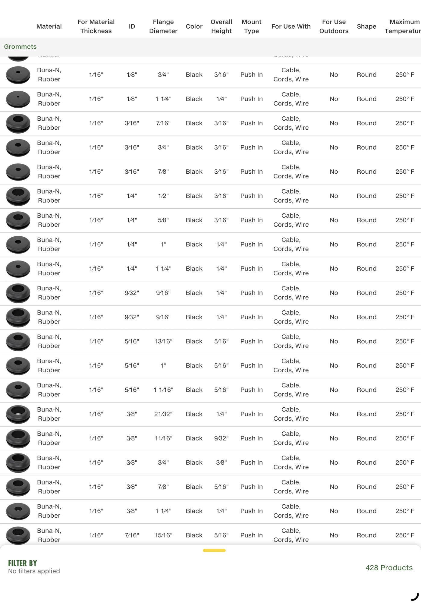

Mcmaster carr might be a solution?

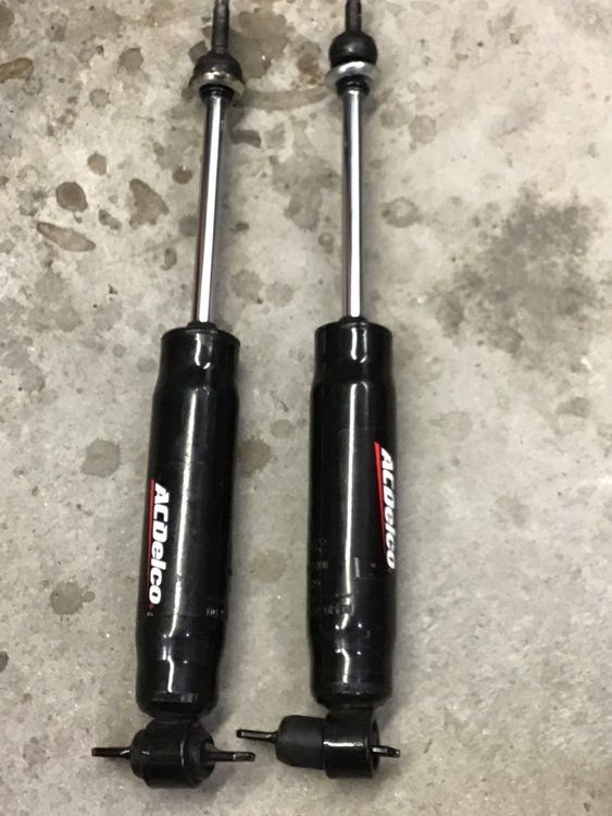

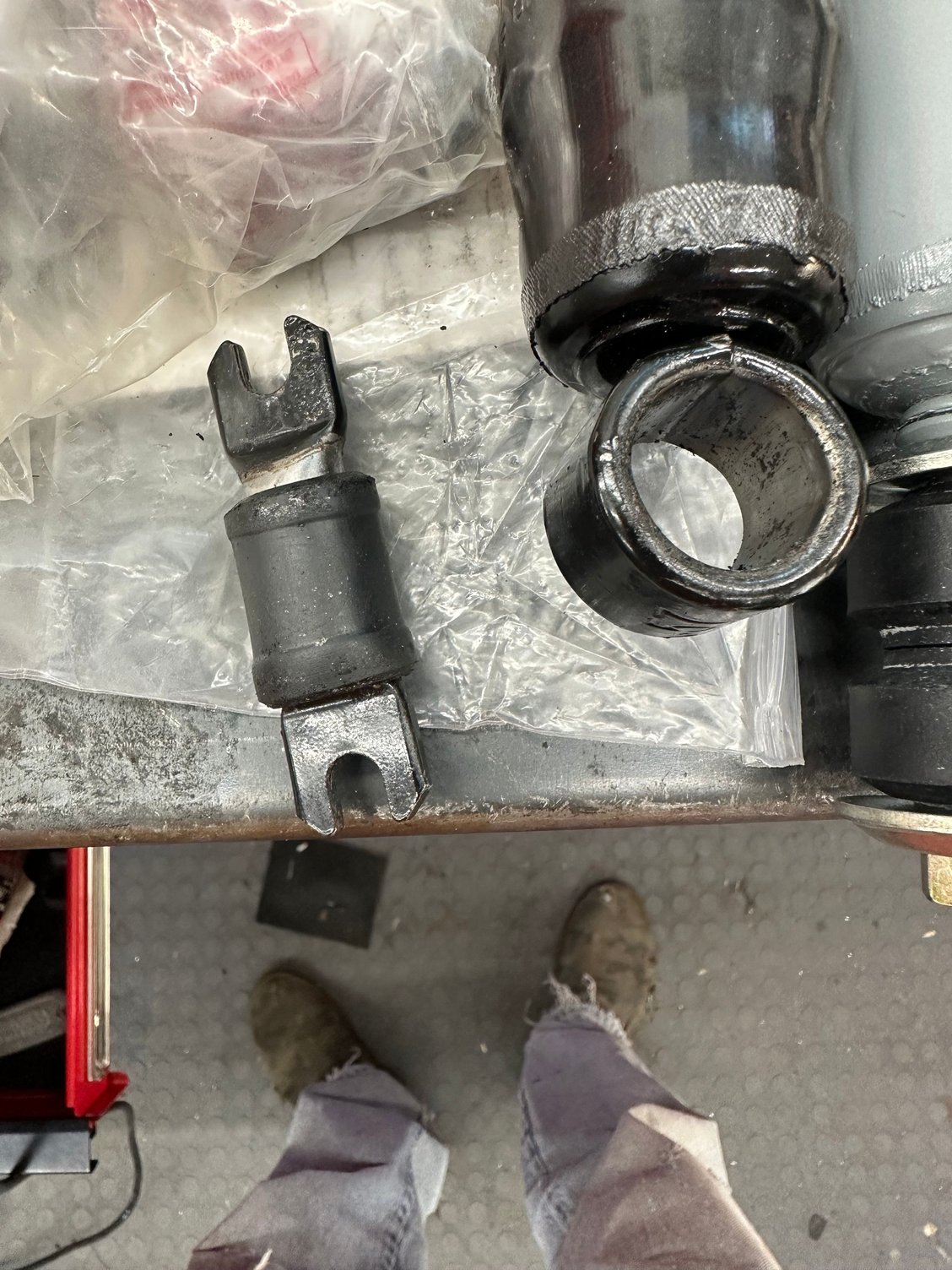

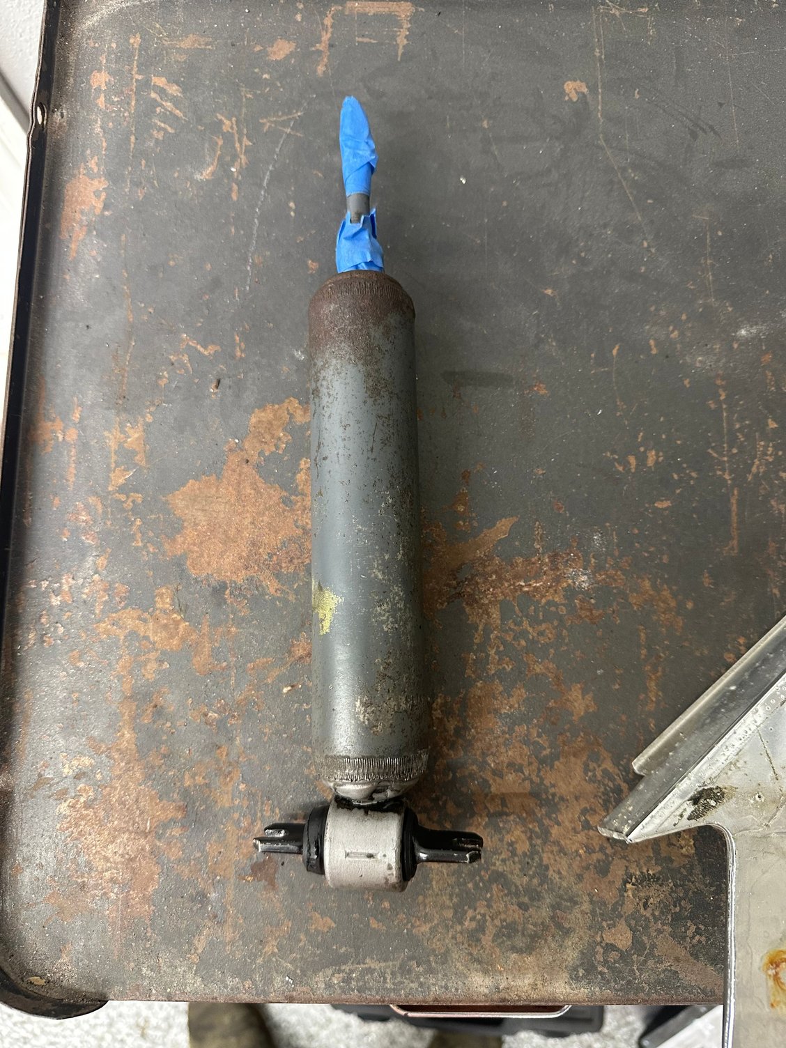

I thought I would post my solution for the lower shock bushing replacement.
I was rummaging around my storage and found some new inexpensive delco shocks I had bought about 10 years ago for my 1971.
I pressed the whole assembly out of the new shock with my press using a socket.
Then pressed out the old worn out bushing from my 68 shock.
Used a little WD 40 and then pressed the new bushing and mounting tab/fork into the 1968 front shock.
Turned out good, not perfect, but better than the old one.
