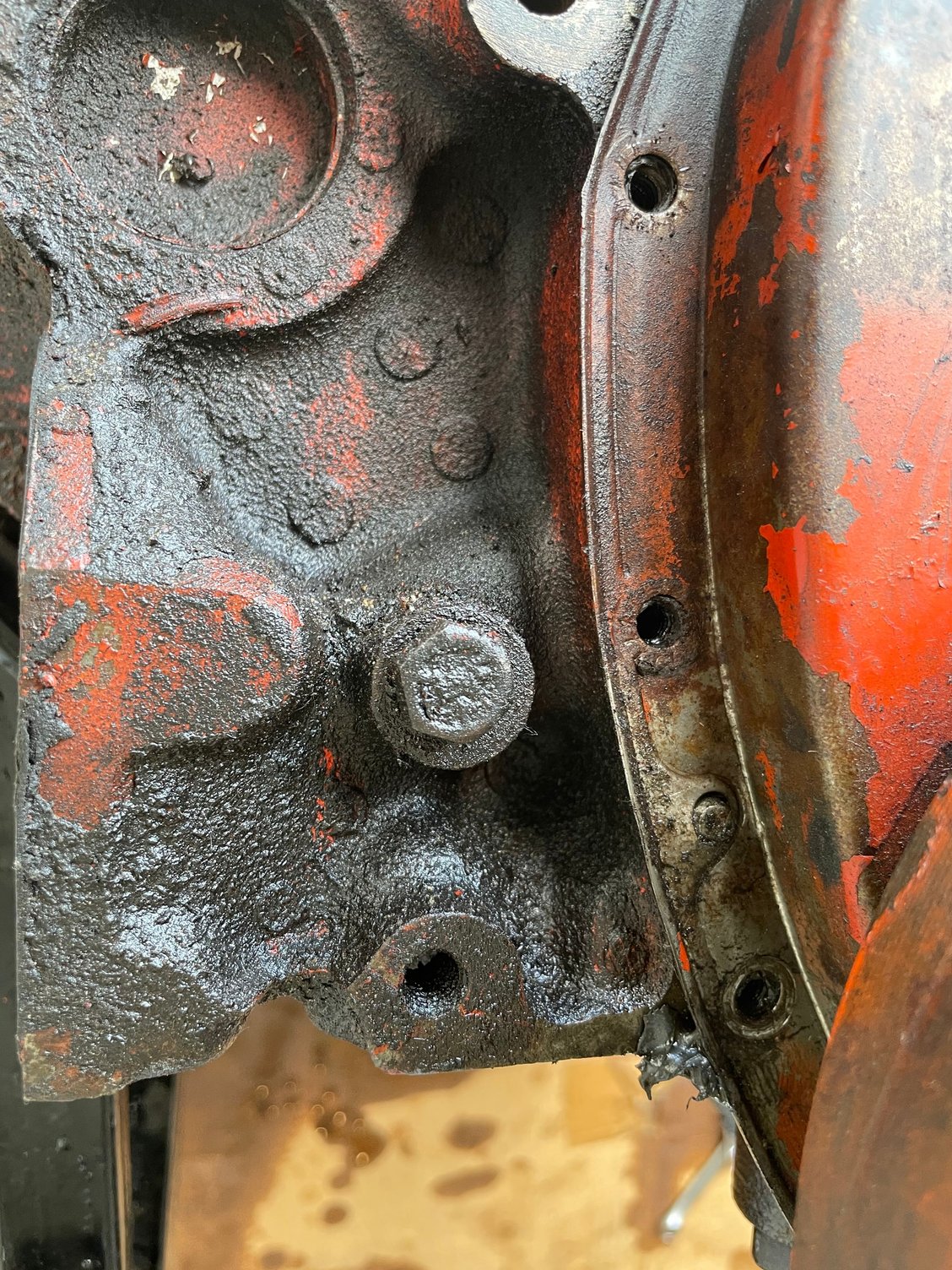

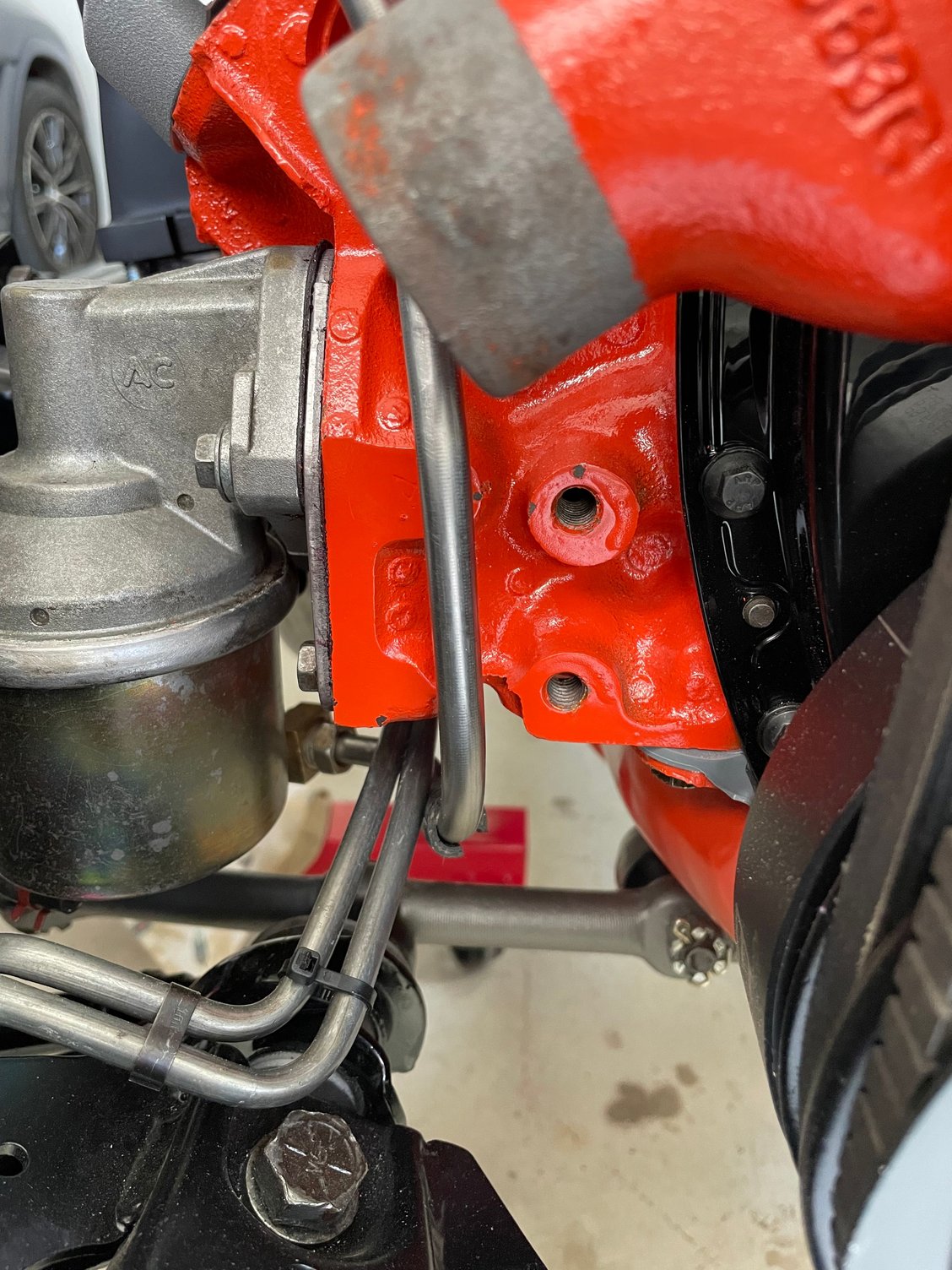

Putting things back together and had couple tapped holes on front that before tear down one had a bolt and the other one appears to have been empty. I can see the top one gives access to fuel pump rod and would help holding it in place when putting fuel pump on (wish I had noted that before). The bottom one appears to be a blind hole but not certain. Is it blind and did it/does it have a purpose? Mostly curious but also want to make sure. tks

The lower hole is a blind accessory bracket mounting hole. The upper hole is open right into the interior of the block, and is used with a longer bolt when replacing the fuel pump: You stick the fuel pump pushrod up into the block, and then gently screw a long bolt into that hole to hold the pushrod in the "up" position while you mount the fuel pump. Then, don't forget to remove the bolt and re-install a short "plug bolt." If you don't put a plug bolt in that upper hole, you'll blow engine oil right out that hole under high rpm WOT engine operation.

Yup, that what it looked like but wanted to be sure.

some genuine race cars/boats also use those holes (along with those on driver side of timing cover) to mount a "motor plate" that is used (in lieu of side mounts) to secure block in chassis.
