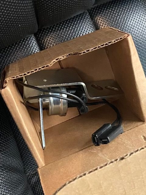

Curious what part your using to "REPLACE" your 68 brake light switch with ? It's a one year only part & nothing aftermarket will work unless modified ( 69 ) . Careful of catalogues that list 1968 parts as 68 - 72 or 68 - 82 they are 99% wrong & totally useless / clueless when it come to everything & anything 68 related !!!

It took a while but I sourced the correct one. Thanks!

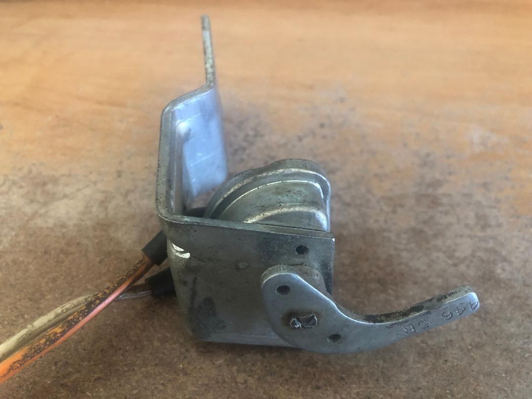

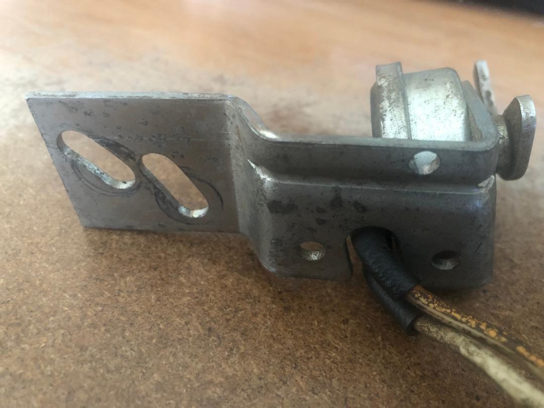

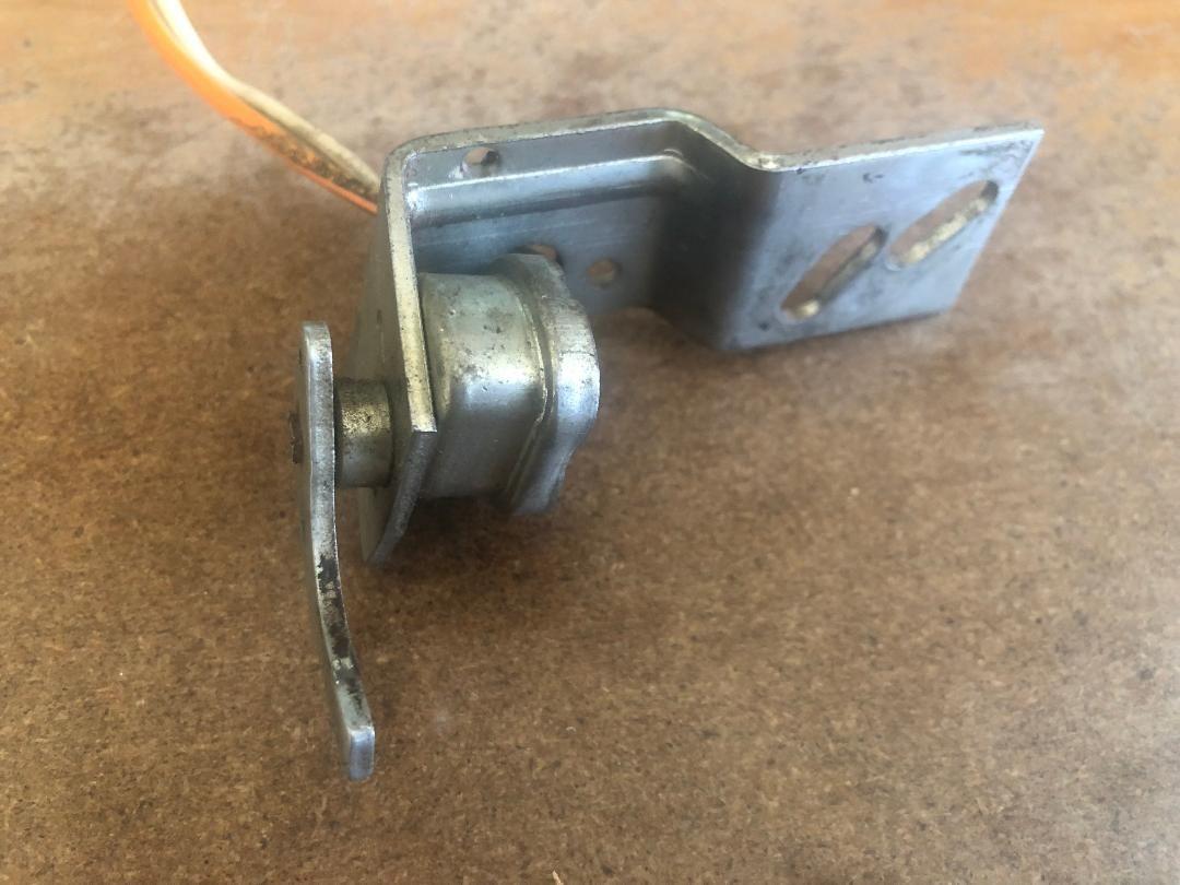

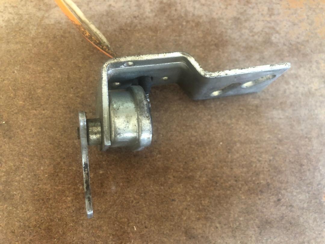

That switch doesn't look CORRECT. Until you get it out & match it up it's hard to tell, I hope not ! I wound up returning several because they were all wrong. NOT one catalogue / distributor had a clue what they were talking about. I bought the last one from Top Fight, because it was printed as 68 not the typical 68 - 72 or 68 - 82 like most BUT that one was incorrect as well. I wound up with a 69 switch & wasn't happy that a brand new part had to be heated up & bent / drilled ( as stated above ) and the pig tail had to be cut & extended to reach. The pig tail, should measure 10" long every one that I returned was only 5". WHAT A JOKE !!! The correct original 68 switch is pictured below. Where did you get yours ? Let us know how you make out. On my previous 68 after changing the brake light switch it turned out to be a faulty "TURN SIGNAL SWITCH " ( had no brake lights ) go figure. Welcome to the 68 one year only curse / GOOD LUCK !!
