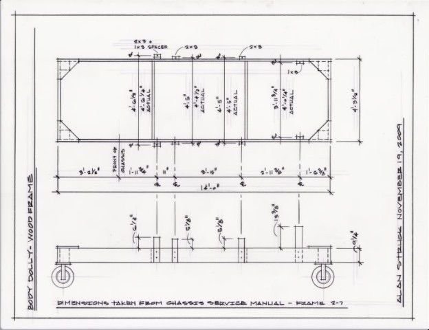

Hello,
Maybe this plan?
It supports the body at the body mount locations.
I believe a couple others have been posted too.
Regards...

Hello,
The front crossmember is the proper place to put a front upright support.
It's not on the drawing and can't be seen in the photo.
Regards.....

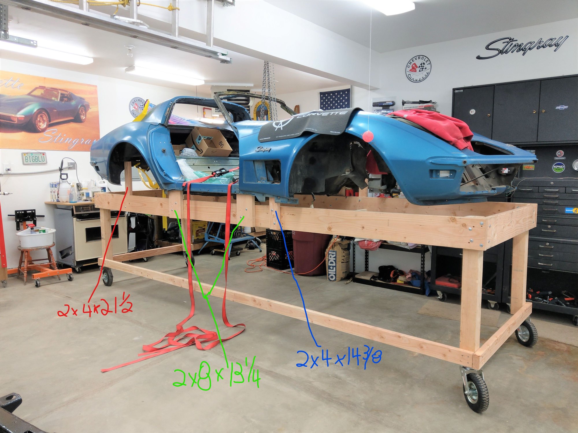

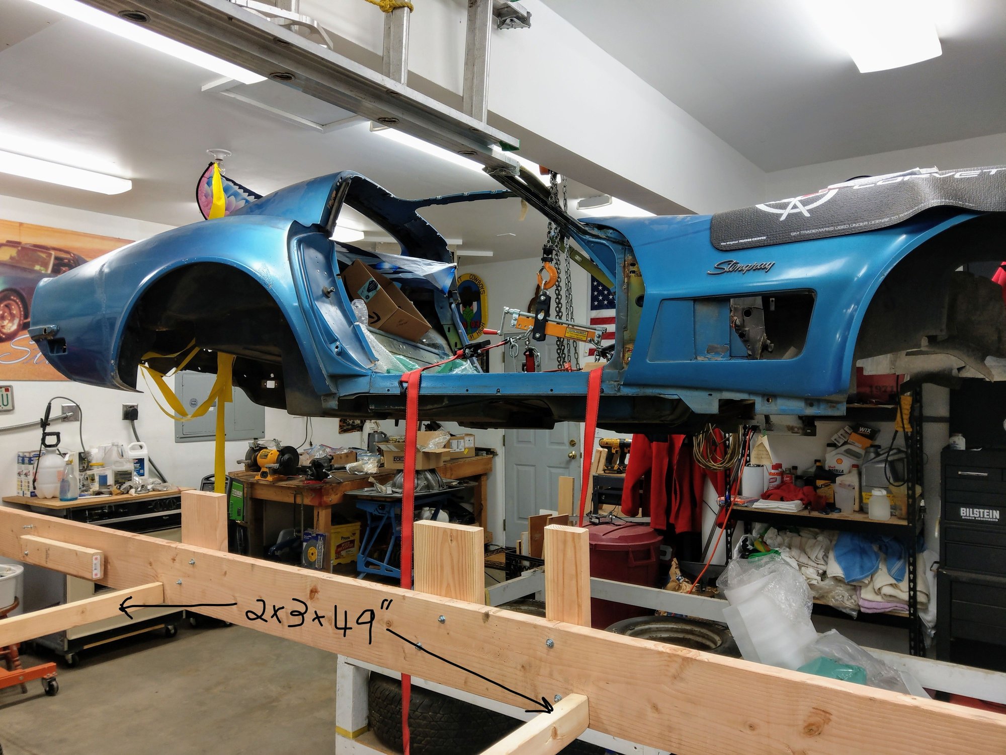

FYI, you can raise the height of the entire dolly by using 4x4s at each corner to raise it to your desired height. This allow you to work on the under side of the body or store your chassis or spare parts underneath.
This height allowed body to stored over the chassis with engine & fuel tank.  Be sure you have the needed vertical clearance,
This height allowed body to stored over the chassis with engine & fuel tank. Be sure you have the needed vertical clearance.

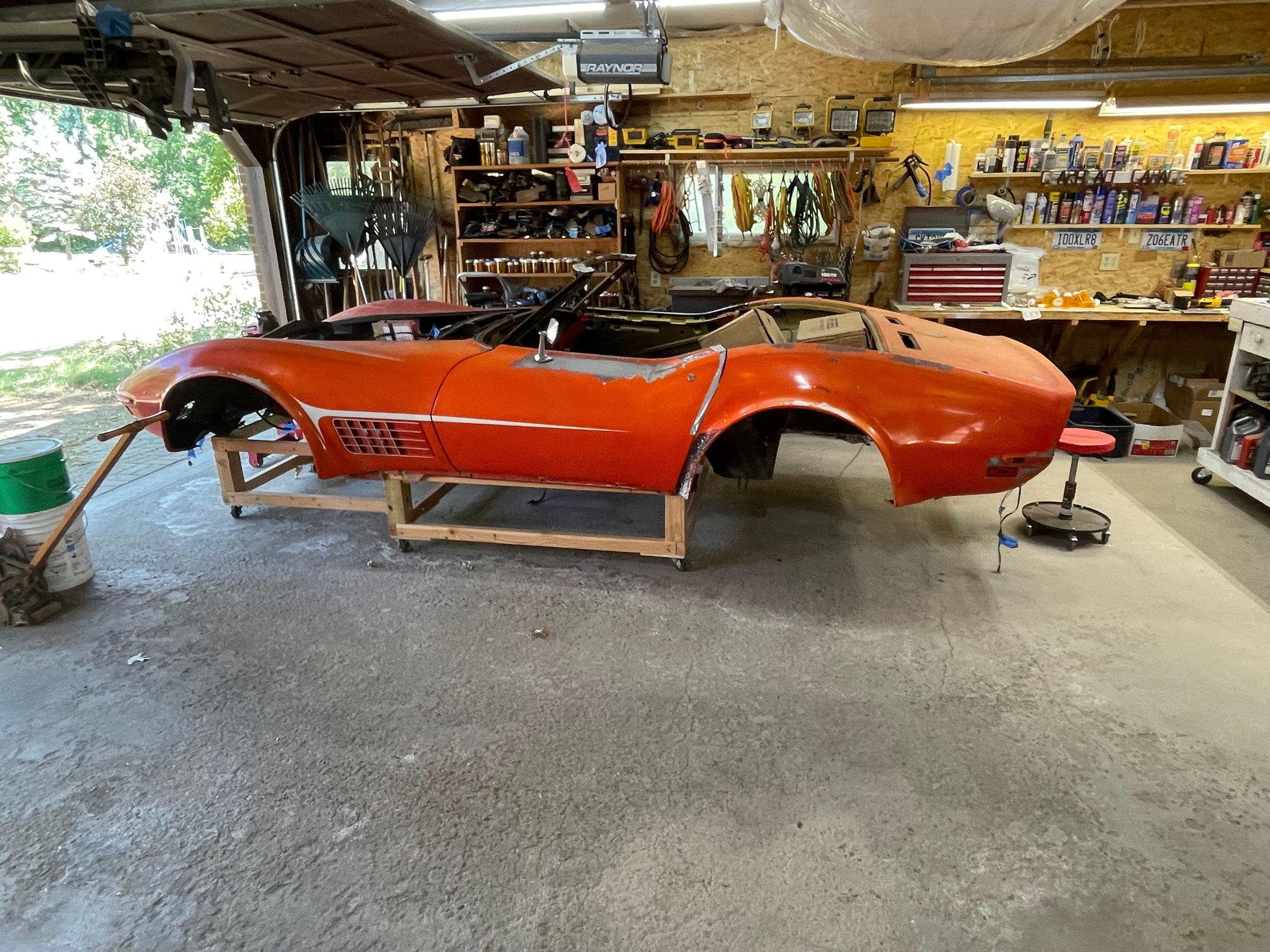

Upright placed under each body mount. Support for the nose was added later

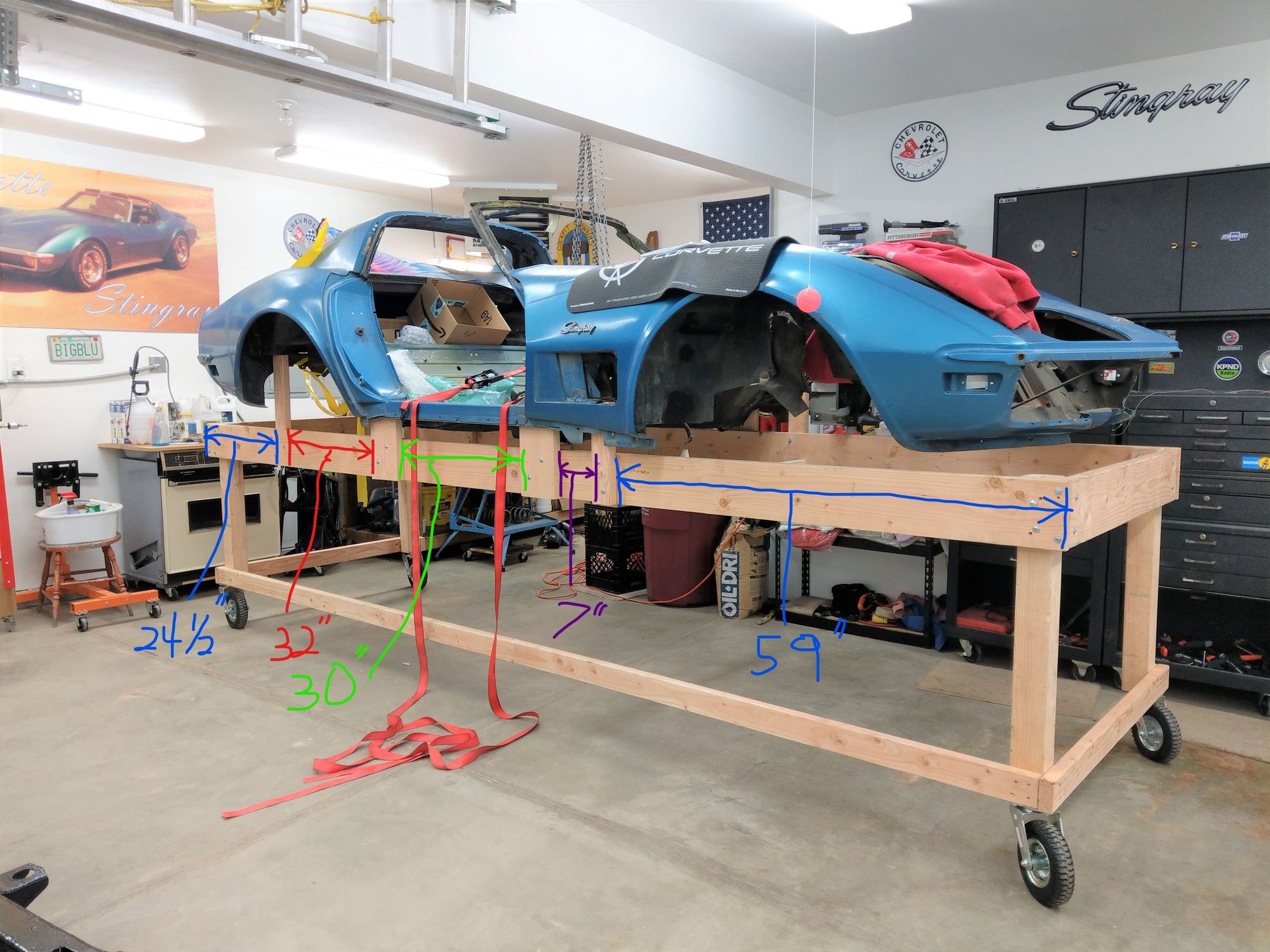

Upright spacing for my 71 coupe

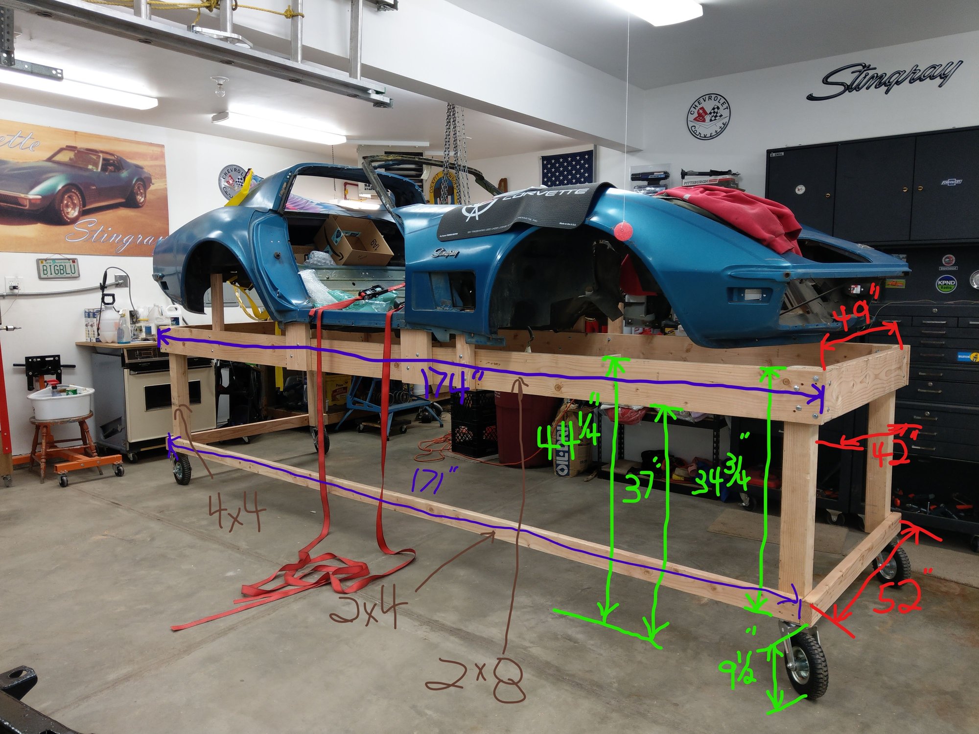

Bracing to help rigidity.  Note uprights can be rotated out of the way one at a time to work on the body mounts themselves.
