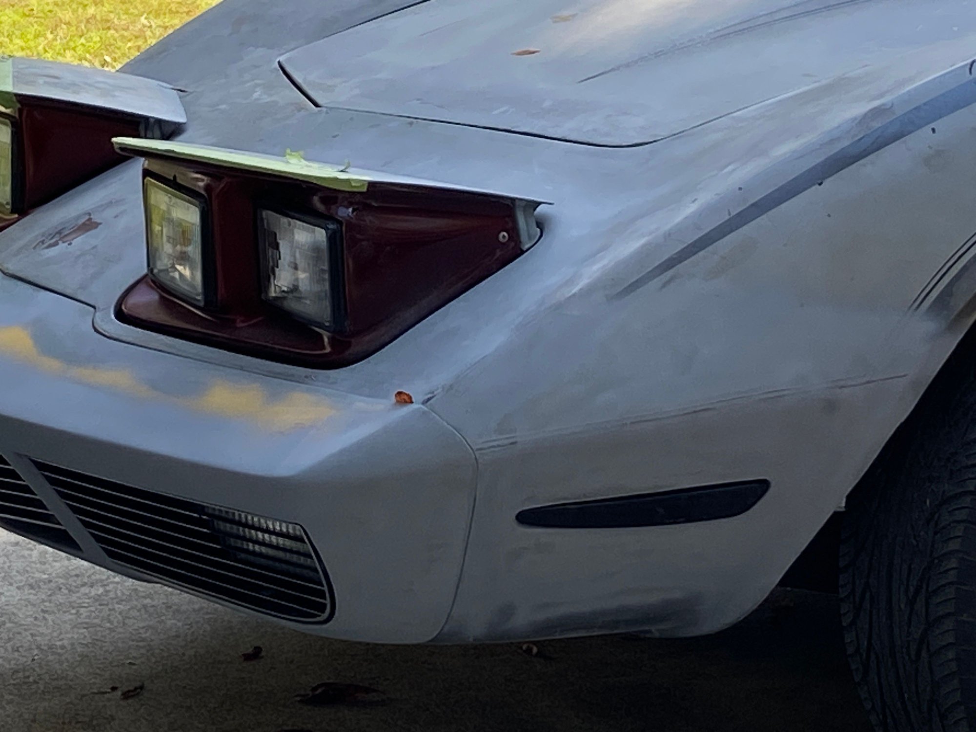

Does anyone know if side marker lights from any other year/gen Corvette will fit or can be fitted to a 1970 C3? The body work with fender flares is being done now, so the side marker light openings could be modified to fit a similar side marker light.
Just a thought. Has anyone tried this?

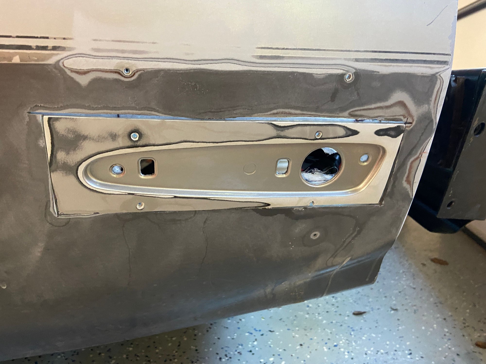

Since you are doing body work now, I will throw this out to you. C6 markers. I got the idea from a place called Heartland Customs. I picked up the rear housings from wrecked qtr panels but the front housings are part of the front bumper which is not made any more so you can guess how much those would coast. SO I made a mold, using the OEM marker lights, then made the patch and fiberglassed them in. The hardest part was getting them level. I also have C6 mirrors on the car.

Awesome work using the C6 lights. That's a project above my pay grade, but I really appreciate you sharing it with me.
