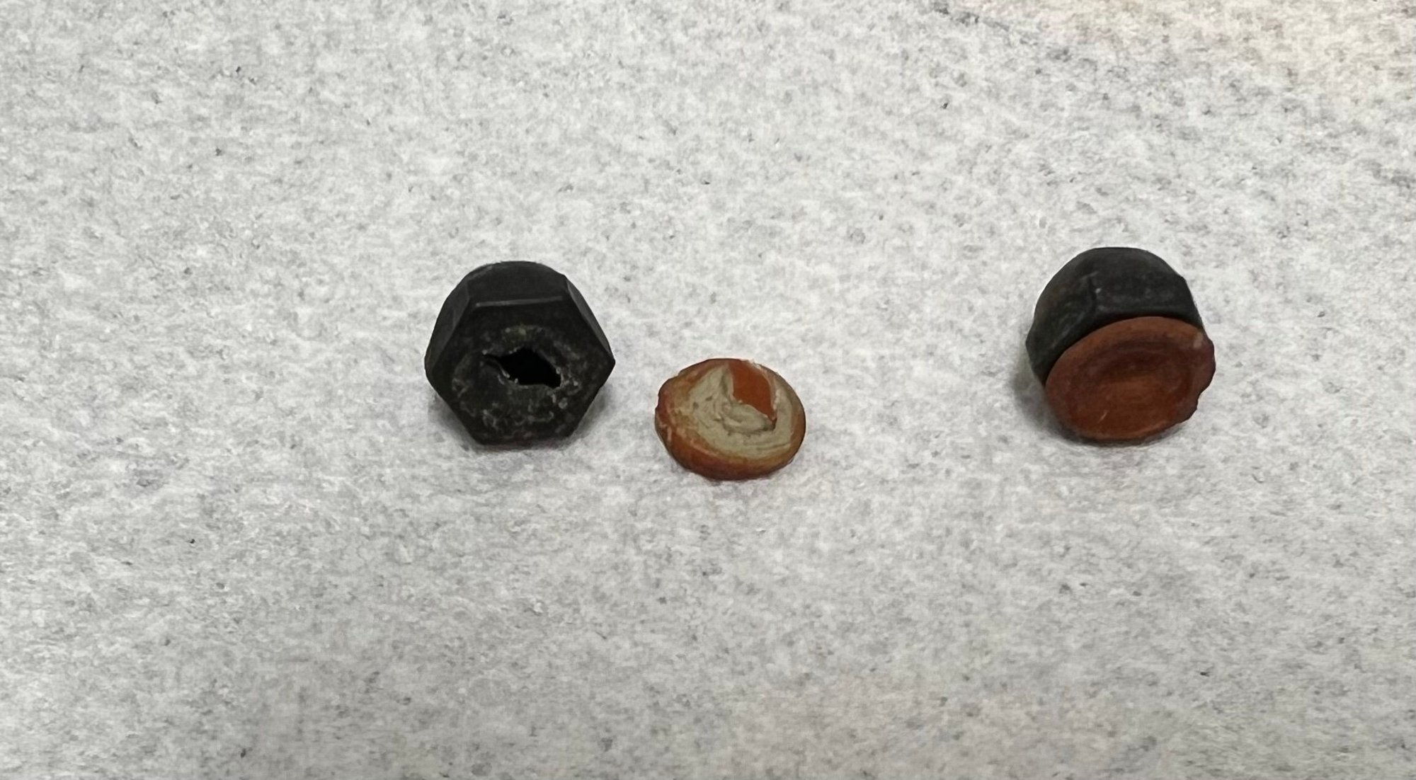

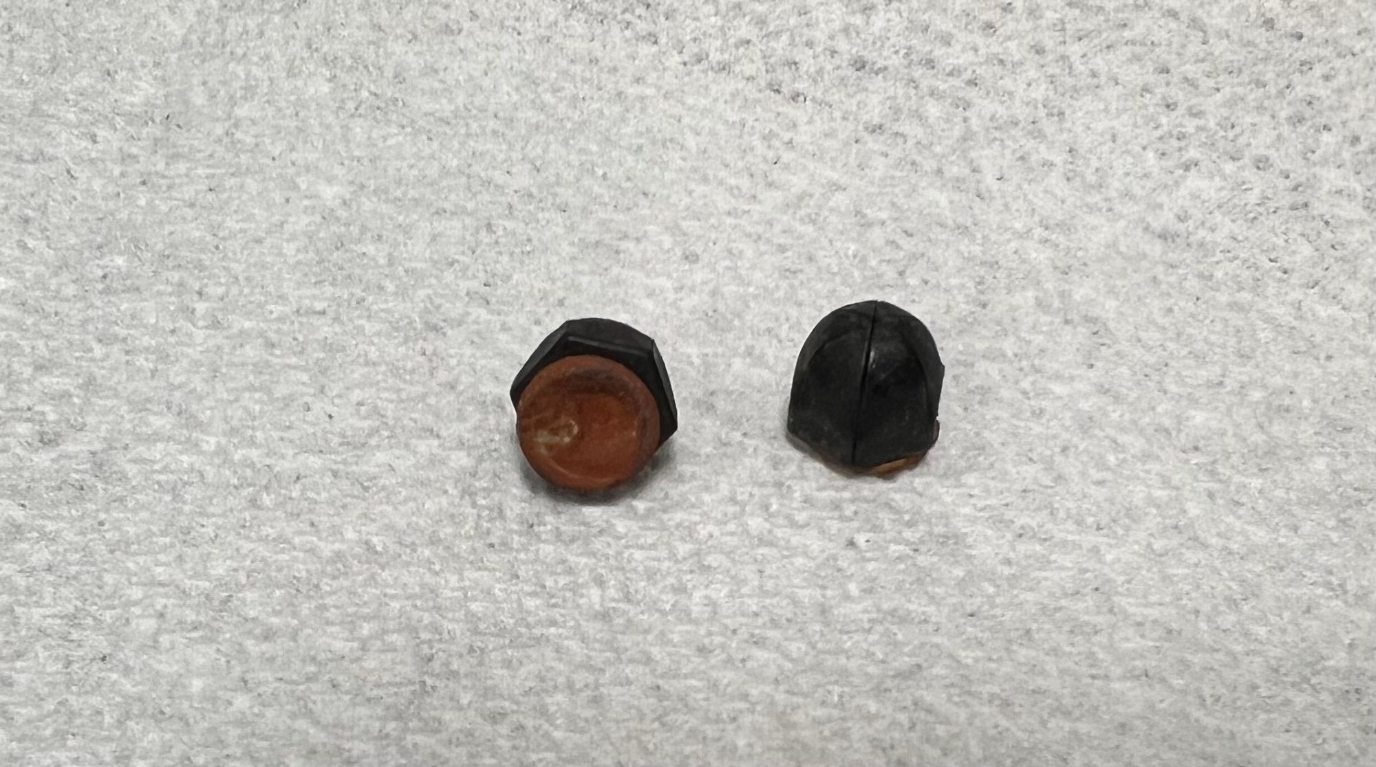

Photos of NOS nuts… Dimensions listed above are 3/8” high, 7/16” hex base, 3/32” hole (circular part of opening). Nuts are black (looks to be painted). Sealer has a red coating, but the base appears to be gray.
Regards,
Stan Falenski

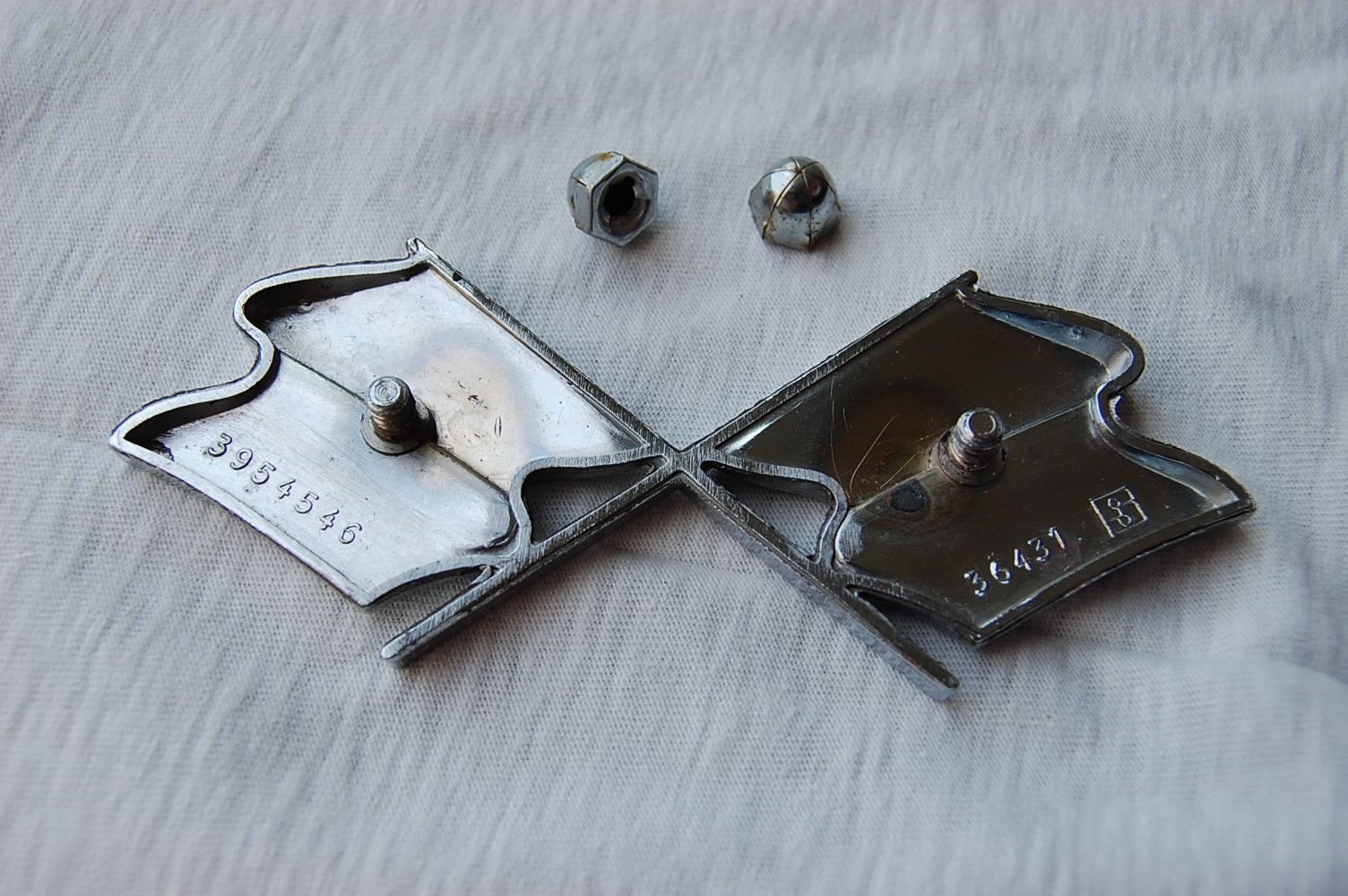

Here's a photo of the PAL nuts used for the Crossed Flags on the the gas door.
Mid-Jan. 71.
I don't know if there was sealer on the posts or not. Sorry.
Regards...
Note the studs on the flag emblem are quite different than those on the rear panel letters....
