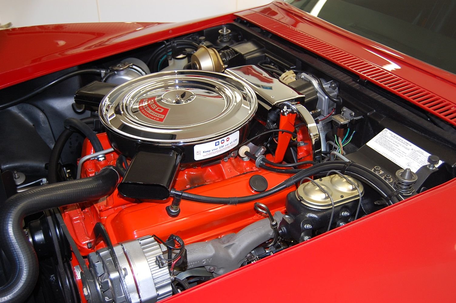

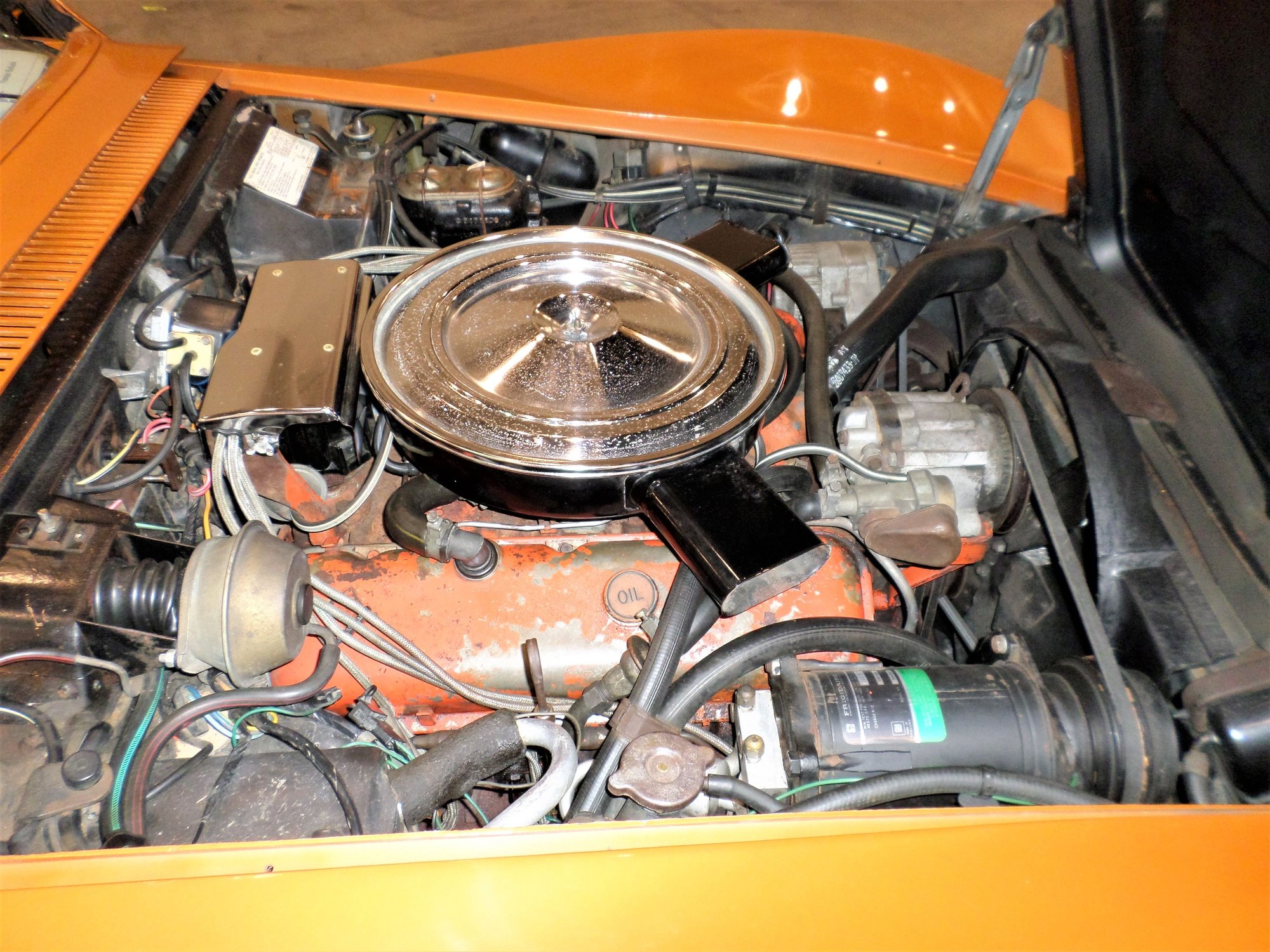

For 1971 production the base and LS5 engine's the air cleaner unit was a 'closed' type with 2 snorkels. There was a service information sticker on the side of the base.
However the Lt-1 and LS-6 optional engines had open air cleaners with silk screened instructions on the underside of the lid.

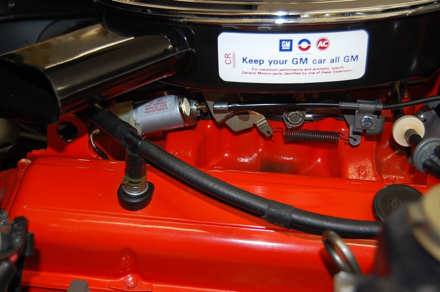

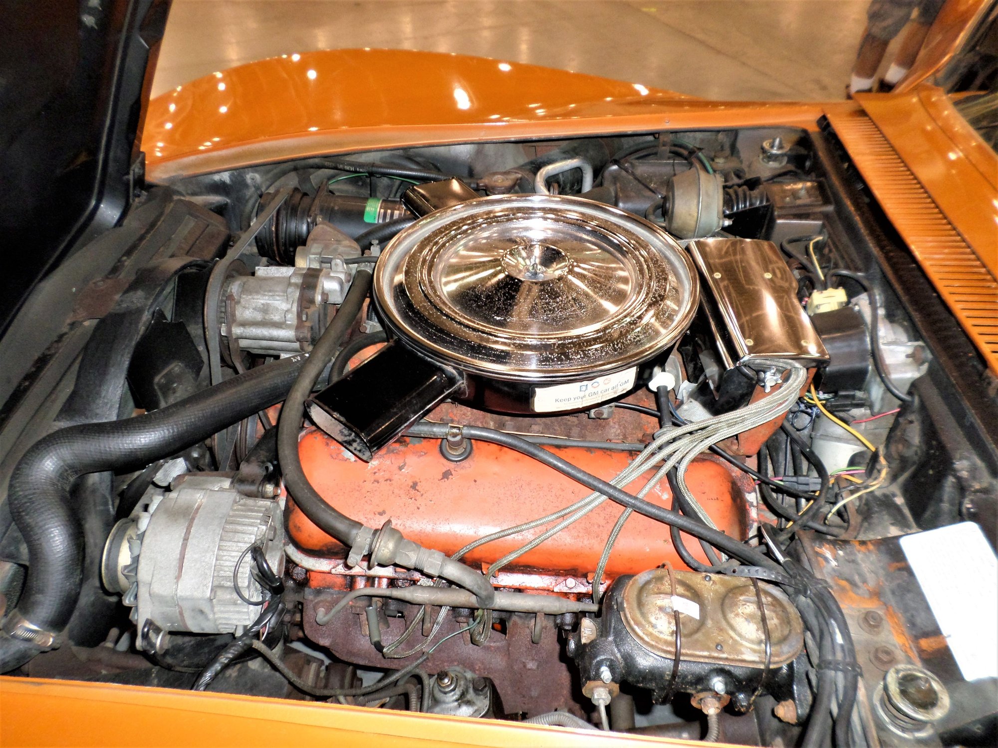

The 71 closed air cleaner didn't have the silk screen instructions on the lid.
The sticker I described was put on the side of the base on the driver's side.
Regards......
