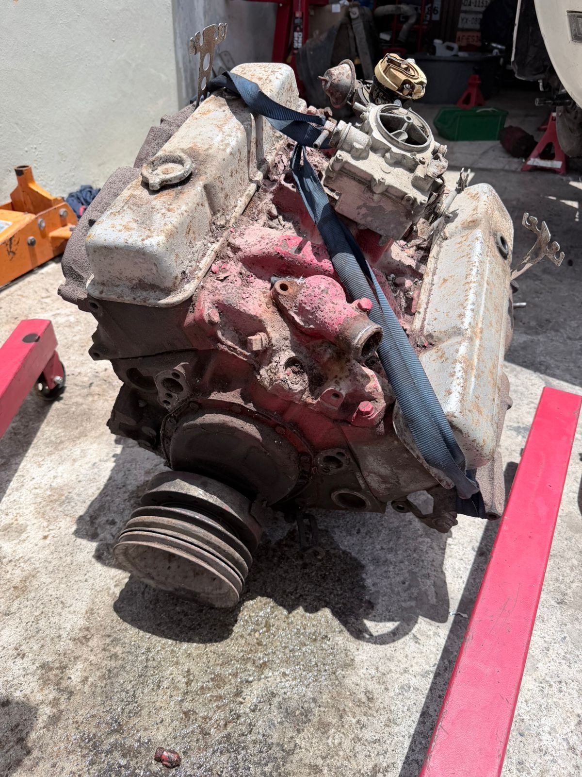

Just updating the post.... We started taking everything apart, removed the engine and trans from the car, and took the engine to the machine shop to work on that. It's a 327 from an earlier Corvette, apparently, with a 4-speed Muncie from that same Corvette. But the engine block and everything are looking good, and we can save it and use it.
We decided to separate the car from the chassis so we can work better, sandblast everything, and do better work.
Some more pictures:

What is the engine code stamped on the pad in front of the passenger side cylinder head?
Old May 15, 2026 | 12:05 PM
acostaraymond's Avatar
acostaraymond
Joined: Apr 2026
Posts: 15
On one side, it has: 3858180 and on the other side it has: to 422 hch

IF I am reading my lime book correctly HCH came from a 66 Passenger Car (PA) and it had a PowerGlide and 4 barrel at 275 horsepower.
I have the Lime Book but am not really knowledgeable so feel free to correct me if I messed something up. That carb on there doesn't look like 4-barrel, eh?
"HCH 66 327 275 4B(Holley),PG PA"
Try to get some pictures o the frame after you remove the body ...... I'm really curious about how it looks. Sure looks like a lot of work to me.
Did the 69 have flares or not?
Yes, this car was extremely modified over the years, the 68-72 corvettes are rare here in the dominican republic.
you are correct and that intake+carb is not from that engine.
also the front klip or whole body is from a 1972 but the vin is from a 1969. Lol
but I have to work with what I got! I was thinking on removing the flares and add the correct side skills.
thanks

I hope you realize that all 1969s small blocks were 350s. Last year for the 327 in a Corvette was 1968.
Also, all 1968-1972 Corvettes have hidden windshield wipers, under a pop-up door.
