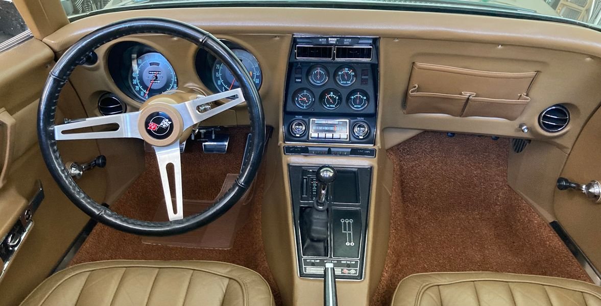

Here is what a stock 69 interior looks like except for the leather cover on the steering wheel.
Considering that your car was built in Nov 69 it might be possible that they used some or a lot of 1970 parts that were waiting for the 70 series to start.
That might explain why so many part look like a later year. That might make it easier to get it useable.

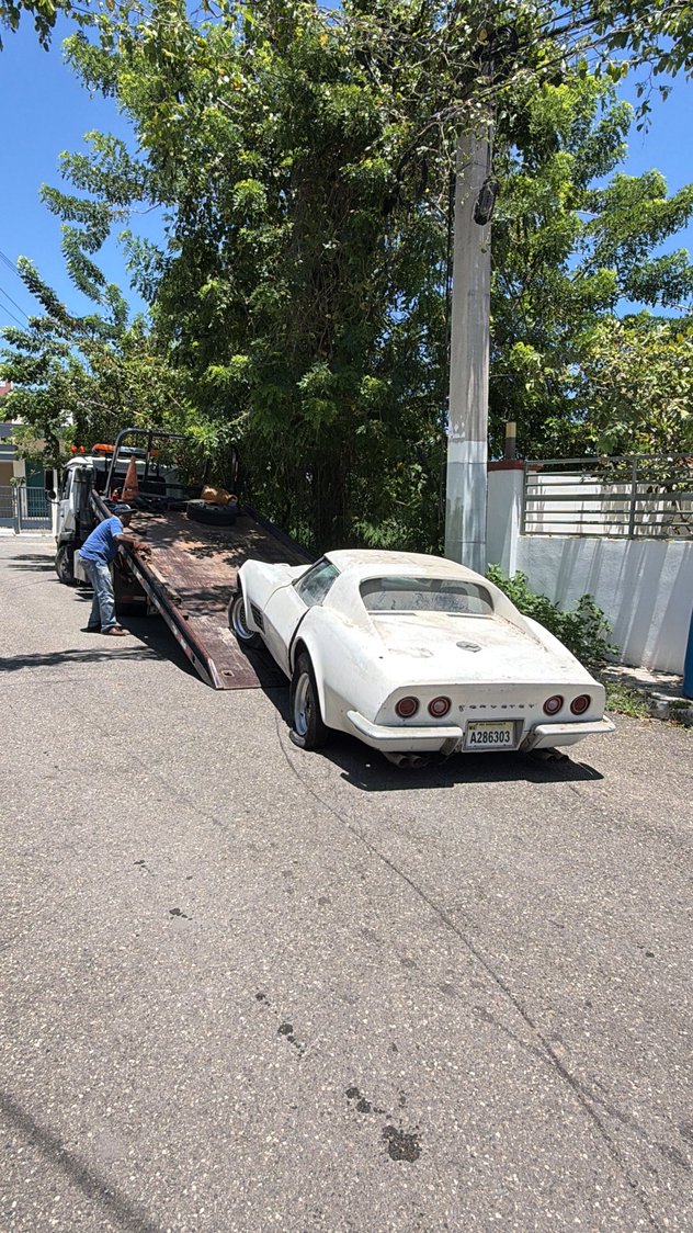

1. The grill/bumperettes for the 70+ front end appears to be missing some parts in it's center. Don't know how stable it might be without those important parts.
2. The 70+ wheel opening has a small flare behind the wheel. But your rear wheel opening which is a 69 is missing the flare.I don't know if this might be an issue for you

Rear flares...I'm confused.

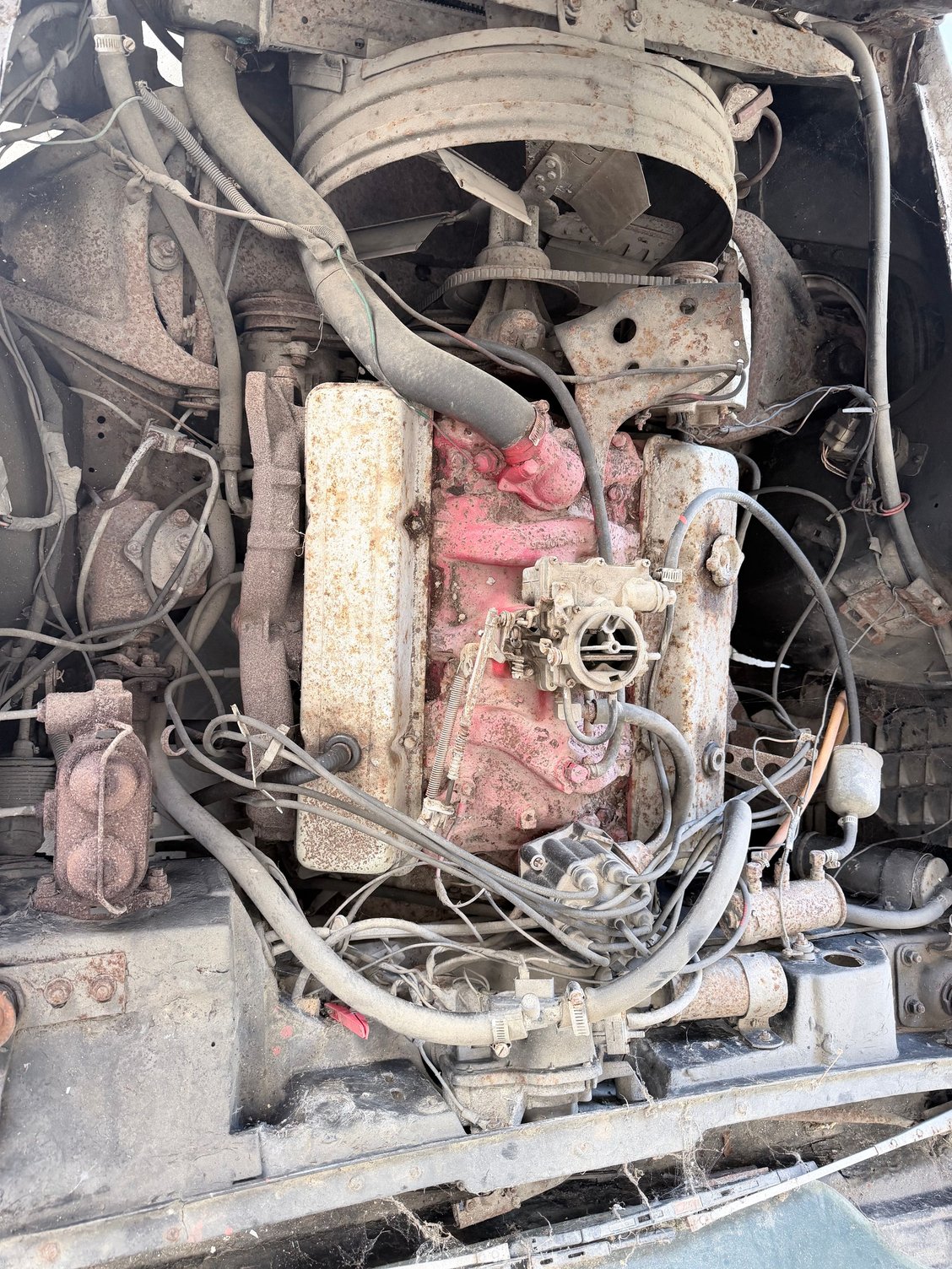

Based on several photos you posted, i'm UNCERTAIN about rot / rust . You say the frame & bird cage are in great shape. There is an extensive amount of rust showing in these 2 photos, including but not limited to the chunk on the passenger seat, ebrake, engine compartment, & whatever that badly rusted piece is on the drivers floor. I can't see the frame, trailing arm kick up area, birdcage bolts behind the speaker grills or the windshield molding & wouldn't be surprised if many of these parts & areas are SEE THROUGH. Whatever material is on the floors may be hiding the Famous FRED FLINTSTONE DESIGN. Labor maybe cheap in the DR, but you will need what looks like a huge amount of money for parts. The DR is a very, very, wet, harsh humid environment conducive to rust. 900 BLACK IS SPECIAL !!
Hope for your sake it works out & you can save her. All the best to you. Keep us posted & the pics coming.

The original rear exterior photo made me think ...no flares.
But the later photo does show rear flares.
Rebody????

The engine compartment photo is quite ....depressing.
