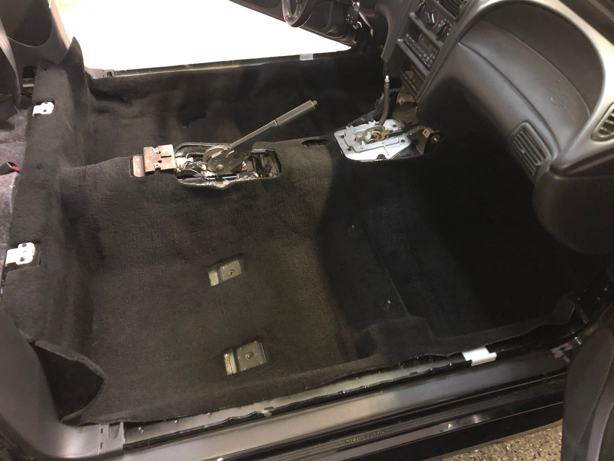

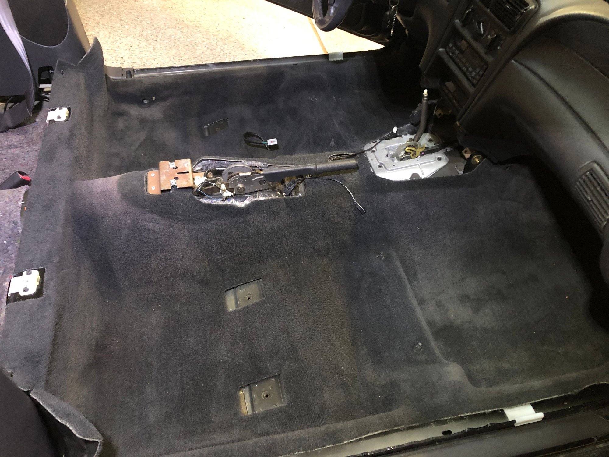

I’ve had good luck with Rit dye as well. My son and I dyed the charcoal gray carpet in his Mustang with the carpet still in the car. We used the liquid dye mixed with some really hot tap water and some vinegar. We spayed from a spray bottle to coat the carpet, and a brush or sponge works well to make sure it really gets into all the fibers.
Old May 6, 2026 | 10:20 PM
Ron71's Avatar
Ron71
Joined: Mar 2003
Posts: 891
Likes: 165
From: Oswego IL
I found some photos of when we did it.
Before:
and after:
