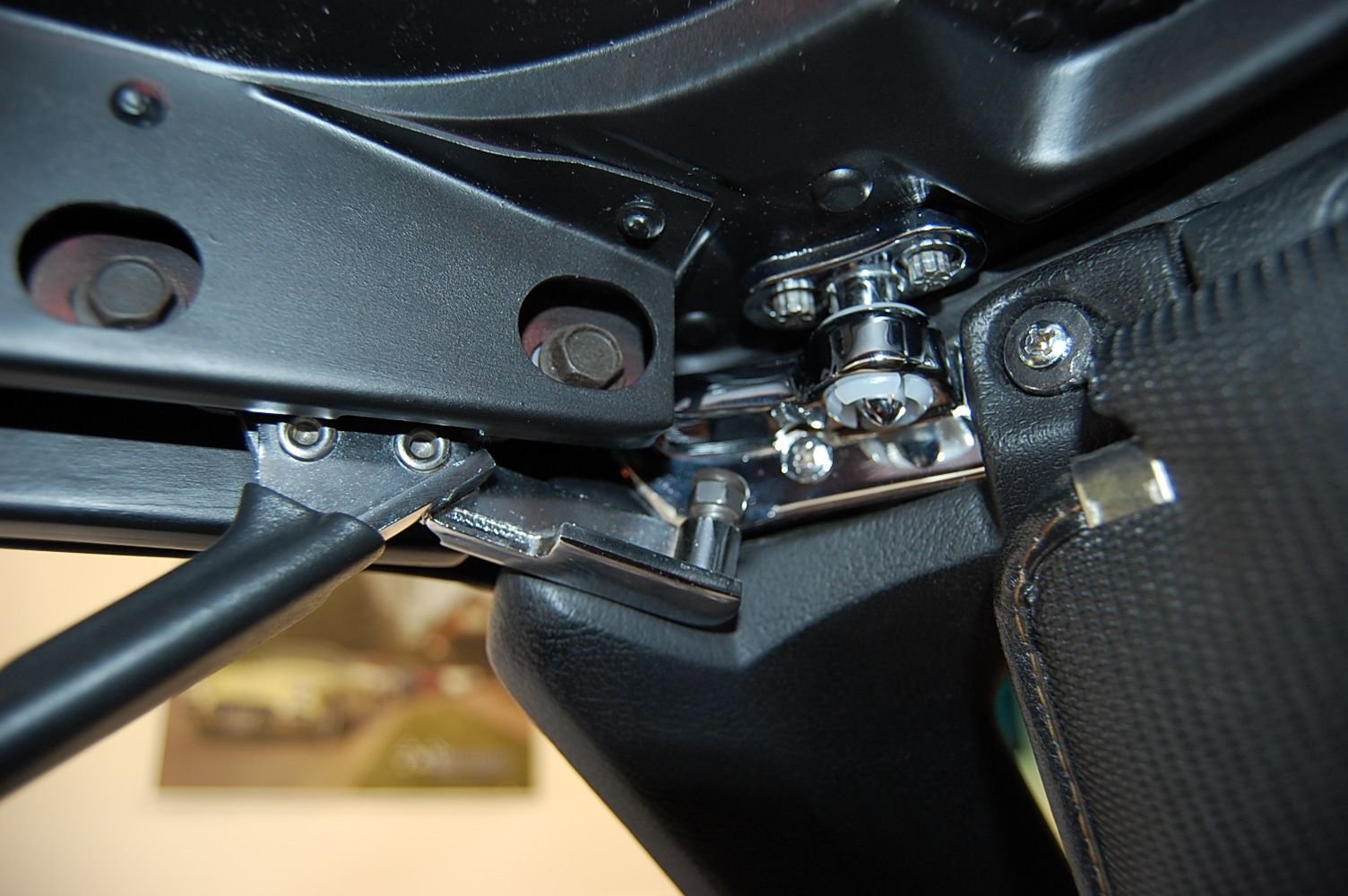

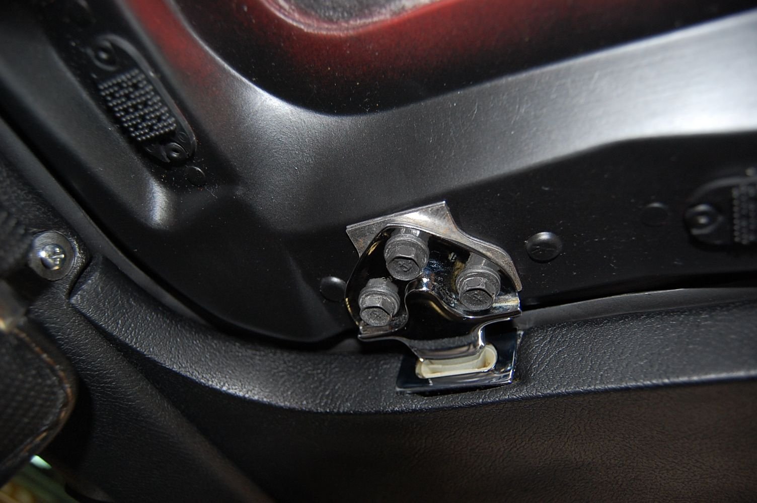

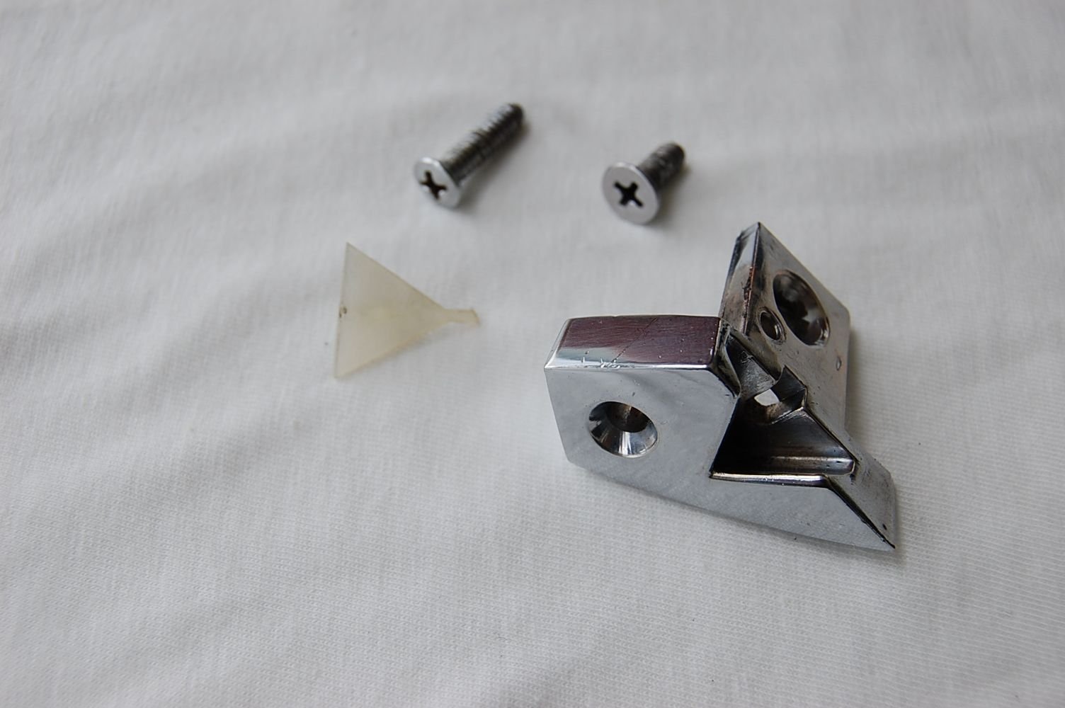

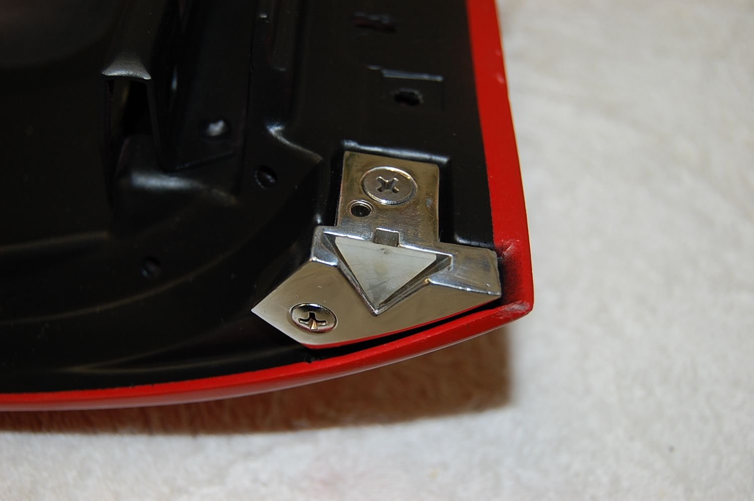

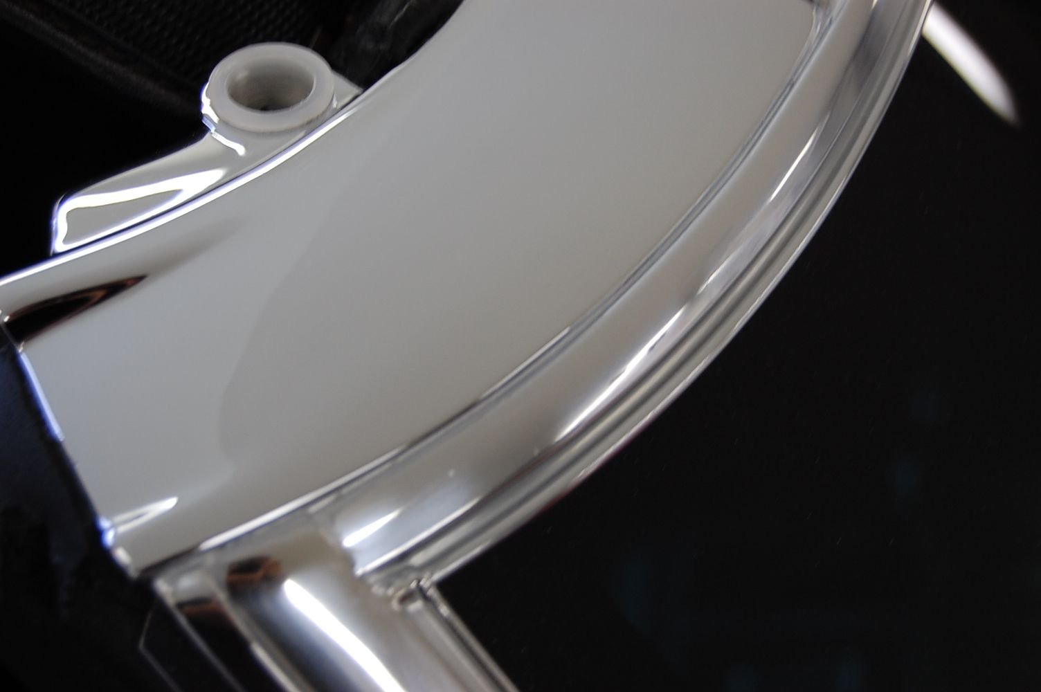

Hello,
Are all the plastic and rubber bushings in place?
If not that may be part of the noise you're hearing.
There should be no metal to metal contact.
The 4 locks should hold the roof panels VERY firmly in place.
Regards......
White nylon bushing.
Triangular white nylon.
White nylon bushing and rubber bumper.
Rubber bumper.
