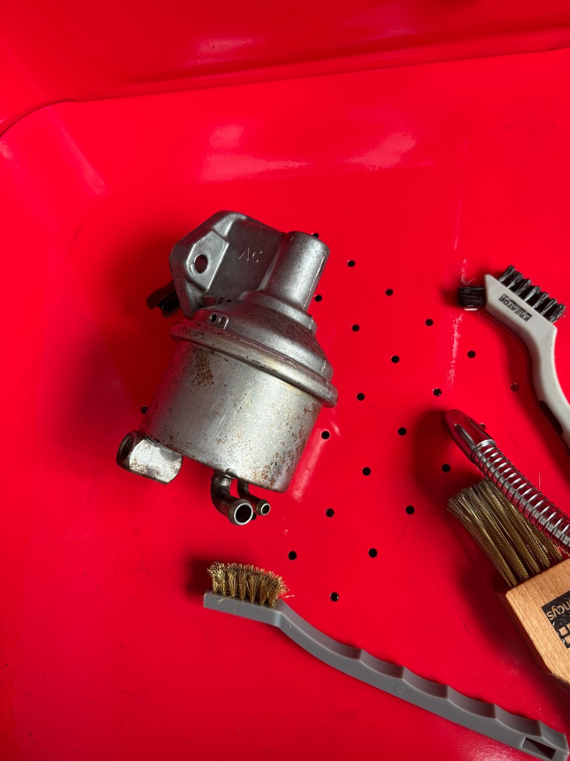

Hi everyone
What would be a good paint to use for the OEM 1977 fuel pump?
I know it came from the factory bare, but mine is rusty in some spots. I already cleaned it up some years ago, when it was mounted, but the spots always come back.
I want it to have a clean cast look.

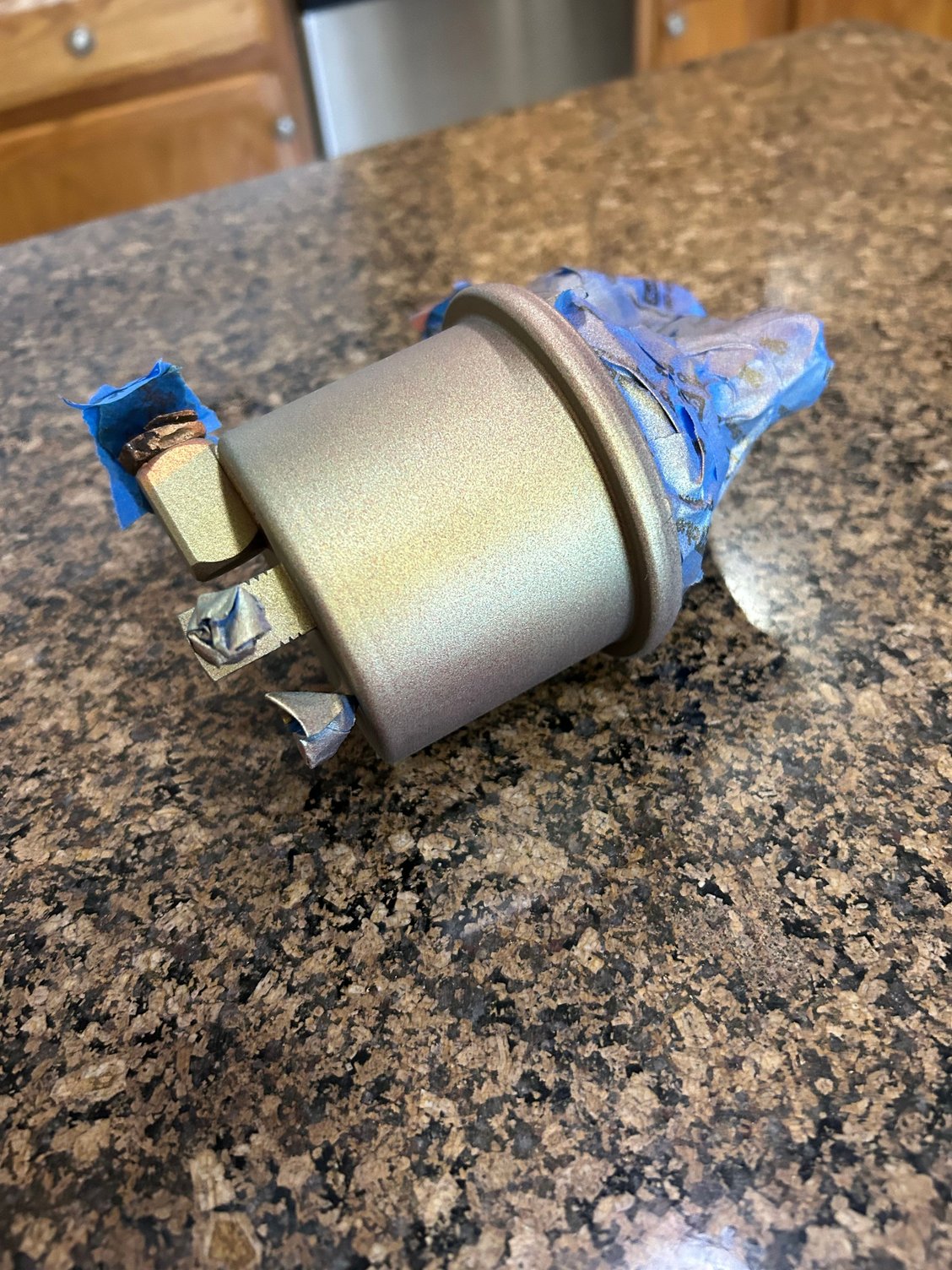

Hi N,
Here is a pic of an old fuel pump I had.
. Pretty close

Originally Posted by Kaper220
Hi N,
. Pretty close
What paint did you use?

It’s a dichromate spray paint from Eastwood. A bottle of Gold, red and green .

Hi Alan,
You are absolutely correct. This is only temporary. Really for show.
Thanks
