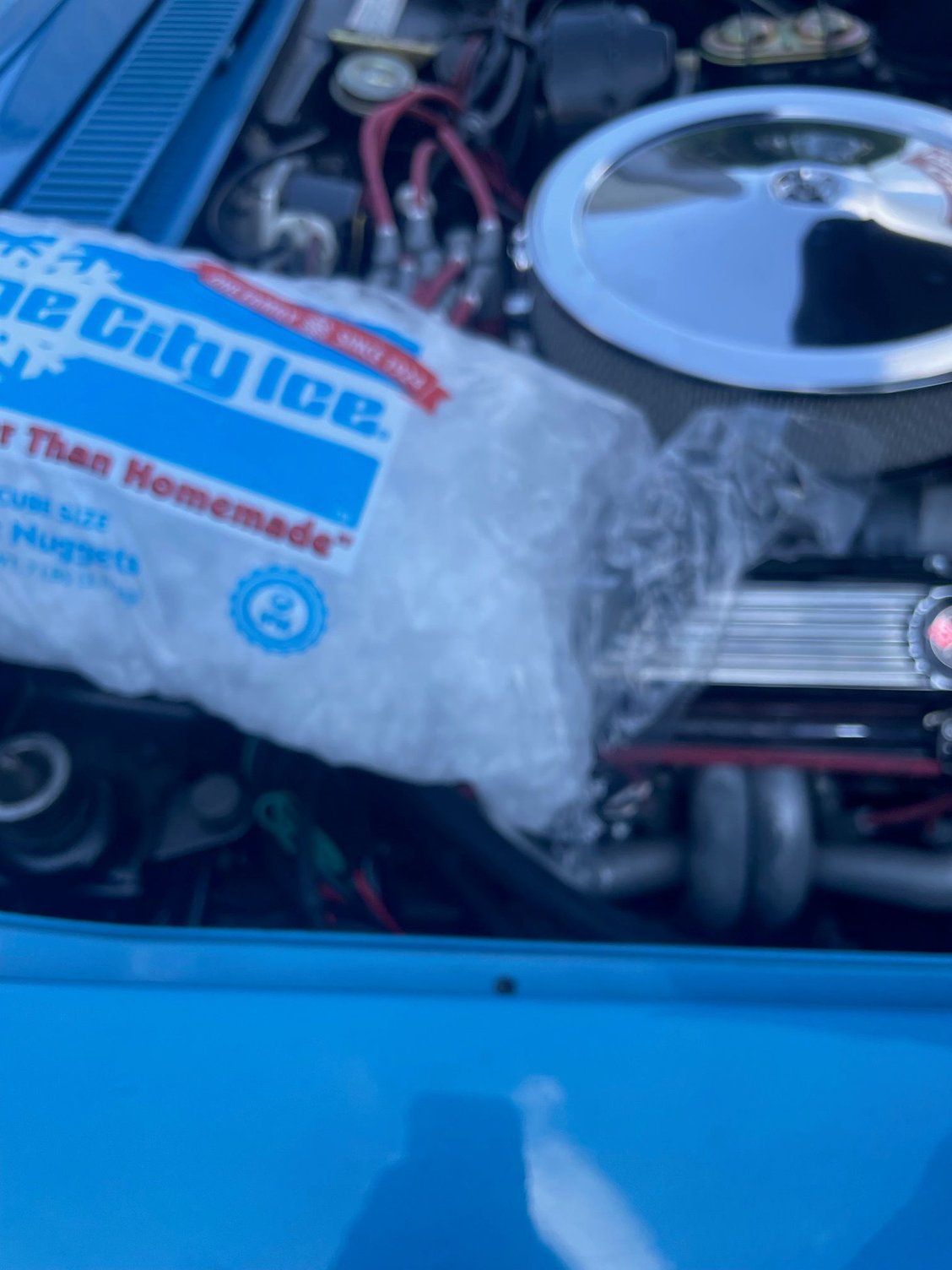

After a week long differential rebuild I took it out for a couple quick test drives. Second drive was about 15 miles and I stopped to grab a drink. Came out, car started and made it a couple blocks before it started to misfire. Pulled into another store parking lot. Opened the hood, fuel was in sight bowls, so not fuel problem. Then touched the brand new coil and it almost burnt me. Unbolted off the manifold and hung if off the wiper door actuator. Bought a bag of ice and cooled it down in about 10 minutes. Started up ran fine and drove back 10 or so miles home with no problem. I'm assuming when I stopped for a drink all the heat built up under the hood enough to overheat the coil. My engine runs nice and cool all the time. stays at 180 and goes close to 190 in the heat of the day in heavy traffic in town. Cools back to 180 within a minute of rolling again. Second time now I've broken down in a month. Same issue first time but didn't know it. That time involved a tow truck. Went down a crazy rabbit hole changing and replacing everything. So obviously not mounting the coil back on the intake. I'm running a MSD distributor with a Blaster 2 coil and MSD 8.5 wires. Where are you guys mounting your coils? I read that it can up to 3' but could have issue at higher RPM's depending on your setup. Looking for mounting place ideas.

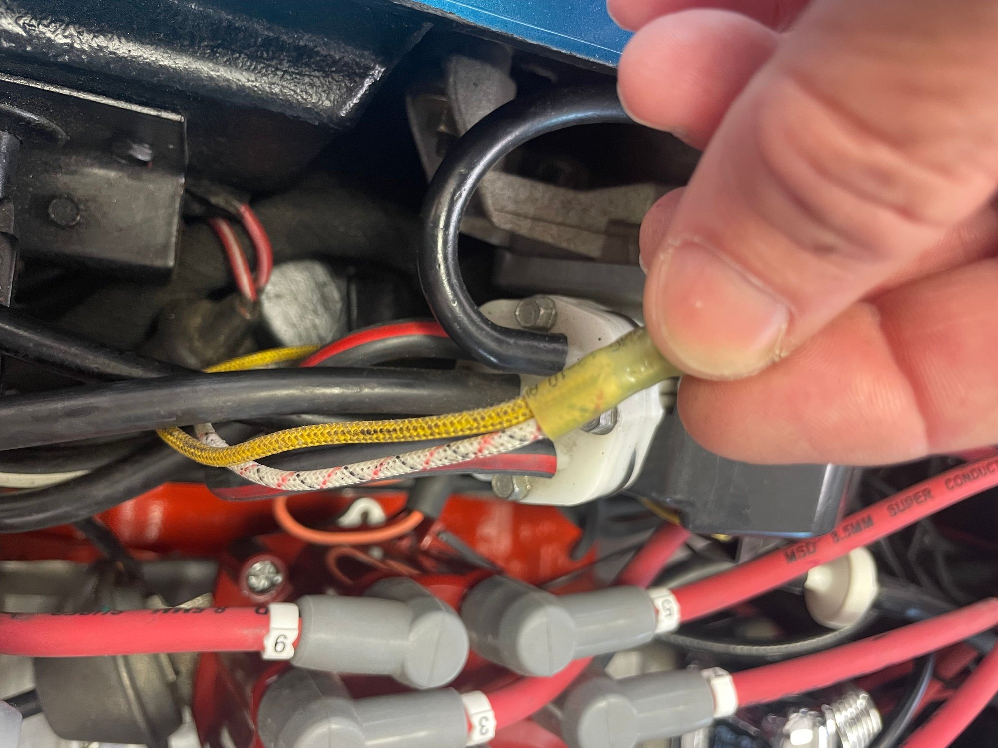

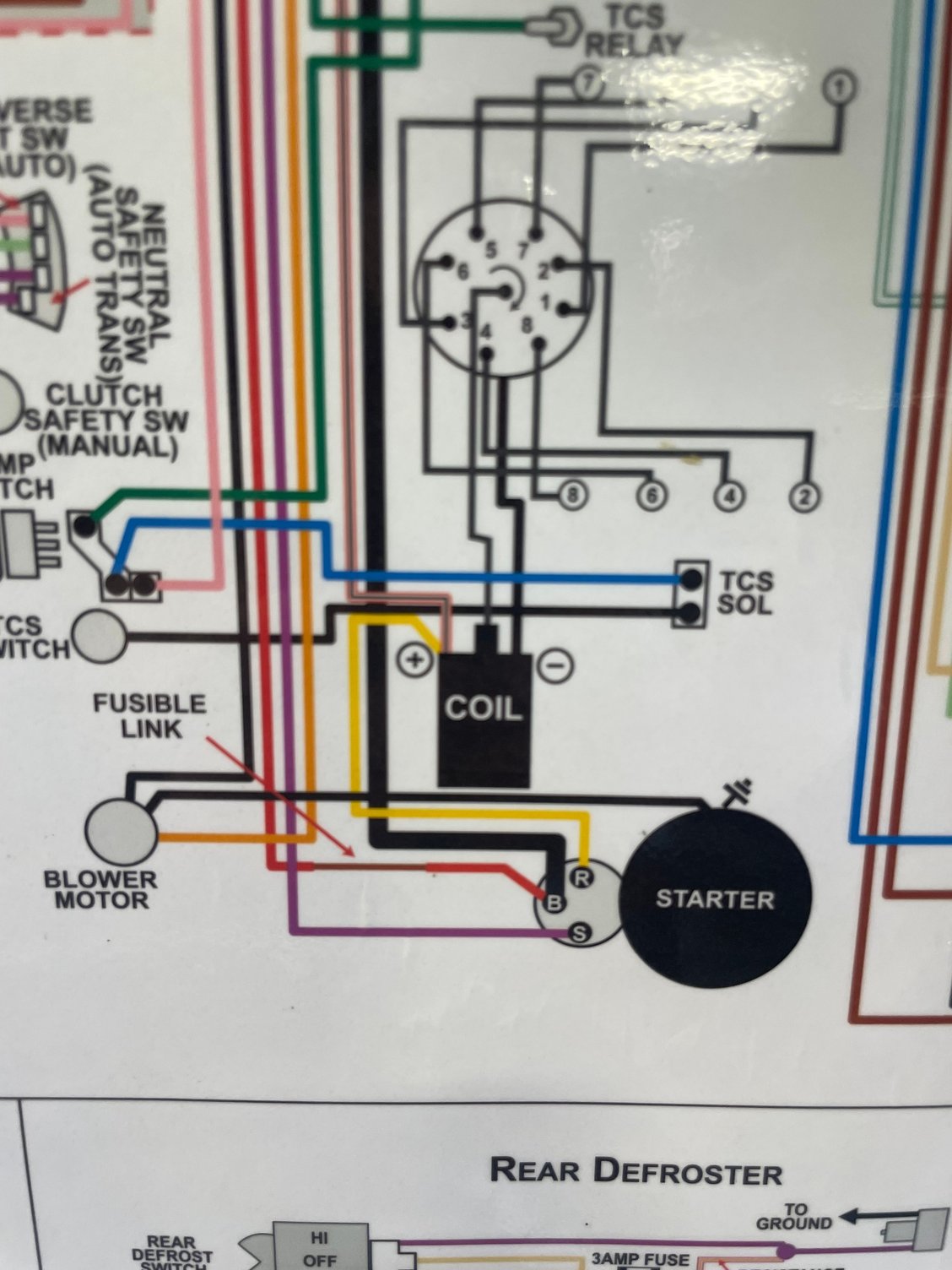

Maybe its hooked up wrong. I'm running an MSD distributor, MSD 6A ignition box and a blaster coil. Per the wiring chart I used, which was how it was when i got the car except i installed a new wiring harness but hooked it up the same way, it has the yellow wire and I can't quite tell but maybe white with red or black tracers? My camera and eyes are pretty bad. I do see on the chart that the white with tracer colors goes through a fusible link. So that needs to be replaced with a wire straight from the fuse block but leave the yellow? As you can see in the attached picture they are tied together just before feeding the MSD box. Which is the red wire that turns the box on and off. I usually unplug that when doing anything and i need to leave the key on so the ignition is not live. I do have three coils now and I'm pretty sure they are all good. Again been chasing a rabbit down a hole. Your suggestions are greatly appreciated!

Wow. This is nuts. I started reading through that post, just want to clarify the wires. The white wire with tracers that attaches with the yellow from the started that turns my MSD box on and off, do I need to eliminate the fusible link? Does my MSD 6A box need that or just a straight wire to the fuse box?
Ordering a new Delco U505 now!
