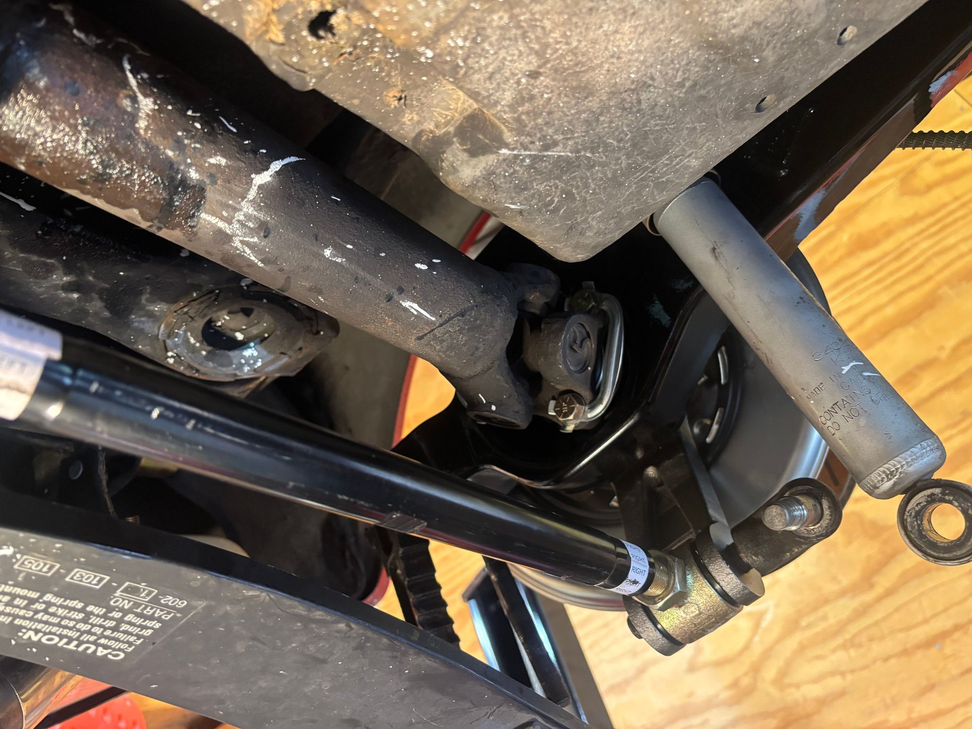

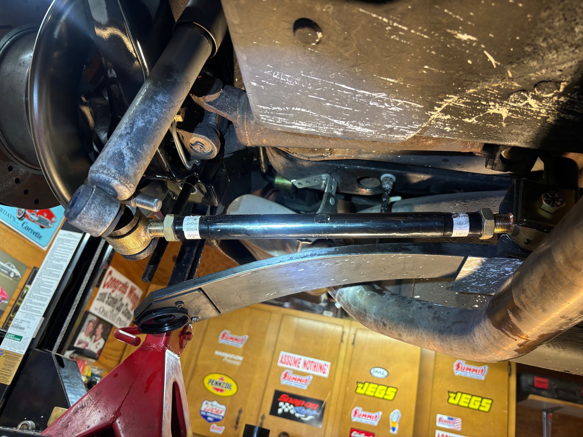

I went with heim joints- and made my own- 5 year old post- I'm sure the prices have gone up!!!
https://www.corvetteforum.com/forums...post1603861188
I bought/put together/made my own- think I was all in for $160 - about $20 less if you go with steel ends
I ended up with greasable moly heim joints- I used staggered sizes- 5/8" to 1/2" hole for the bracket-just like OE. No misalignment spacers needed- just cone spacers and a couple of thick washers- and it's a nice tight fit.
Used 3/8" flat steel to keep them centered. 4" grade 8 bolt and a nyloc.
5/8"X16tpi 1/2" heim only 1/2id X 1/2" width spacers are needed for bolting up.
The tube it's 13.5" Got them from Out-pace
