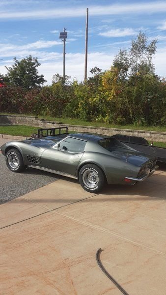

hello, new to this forum, wish I had joined a decade + ago but here we are... after owning a 2008 z06 and now this 72 lt-1, finding out the hard way should have done some homework on good mechanics to handle maintenance and repairs.
On my 72 L-1, 80k miles, had oil blow out into the cabin. local mechanic advised he tool care of it, this was likely the moment the engine seized, but got back from him and ran another 500 miles....then total breakdown (a lot of noise under hood) so pulled over and engine would no longer turn over back on again, had towed to a new mechanic... original motor, matching number vehicle. - new mechanic wants to replace the engine. we asked for it to be rebuilt and he is advising it's not an option.
Any recommendations out here for a second opinion shop in the Northern New Jersey area?
Thanks
Andrew

I feel bad for you, I’m sorry you’ve had these problems to deal with, find a reputable shop that can advise you as to how to proceed. Alan 71 recommendations on NCRS chapters near you is very good advice, surely someone there could offer some help and get you pointed in the right direction.
as a fellow ‘72 LT-1 owner, I sure hope you get things sorted out, from that one picture you posted, it looks like a very nice corvette, I would love to see it back on the road.
