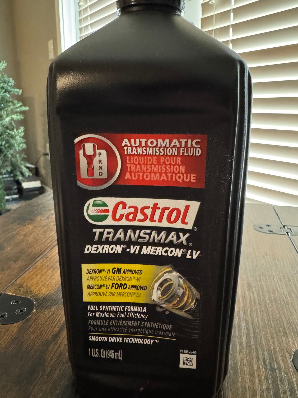

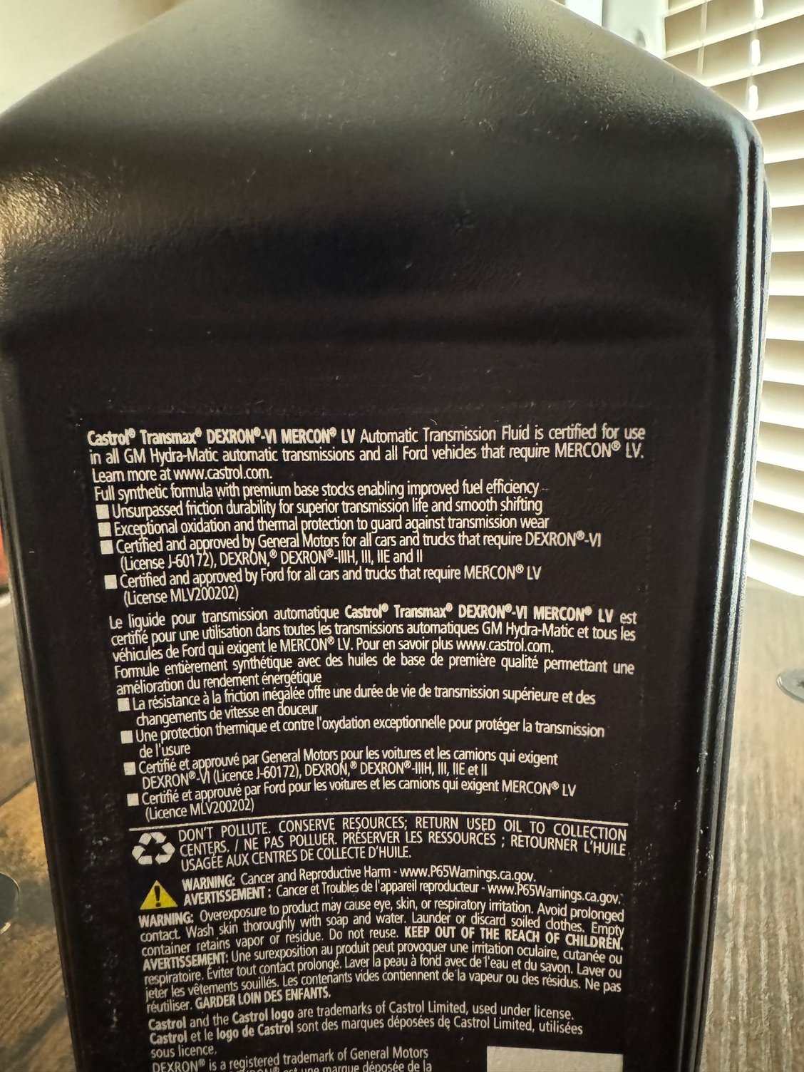

Is this transmission fluid a good full synthetic transmission fluid to use even though it says Dexon VI - Mercon LV? for a rebuilt TH400? On the back it does say that this is compatible with all GM Hydra-Matic trannys and I know the TH400's use Dexron VI. Ive done some googling and see that the Mercon LV fluid is NOT the same as Dexron VI. it seems like a lot of fluid I've looked at have been the Dexon VI - Mercon LV.
1. Am I able to use this fluid without any issues? or should I be looking for exclusively Dexron VI?

I changed my TH400 fluid a year ago but it's original so I didn't use full synthetic.
I forget what the classification was/is...
Youtube "Full Synthetic"....many brands do not come close to FULL.

Dexron 3, non-synthetic
https://www.napaonline.com/en/p/NOL75200

Pretty sure this is what I used the last time I serviced the TH400 in my '71

all brands-grades of DEXRON ATF are backwards-compatible; and have been since that fluid's inception. This is readily researchable via wiki and other sources
All that is rather well-known.

This is the same stuff I used in my TH400. Works fine for my car.

Dexron III. Valvoline makes it. I would not use synthetic.
