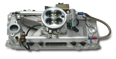

Whos's running EFI and which brand. One better than another? Thinking of making the switch.

http://www.ronsraceshop.com/products.asp?ID=620

Originally Posted by MassVette
I saw Zwede's Holley setup and liked the fact that he could still use his L-88 air chamber/cleaner. The air chamber wouldn't work with the above setup.

the edelbrock setup that summitracing is alot cheaper and you can still use the existing aircleaner setup. the part number is EDL-3550
for 3700 bucks id leave the carb on
Len, I have the Holley Commander 950 (same as Zwede's) on the 69 BB. It did fit under the L88 air chamber but it was close, I had to do a little tayloring. The air chamber hood opening was about 1/2 inch to far forward so I had to do a little fiberglass work. Zwede choose to machine a little off the throttle body to gain clearance between the air chamber and the top of the drop base, I choose to modify the drop base slightly at the front to get it to fit. It's close though.
If you go with Holley, get the wideband O2 sensor setup
I love the Holley Commander ECU and its programming ability. I thought about throwing the MEFI 3 ECU on Project RamJet in the trash and upgrading to the Holley ECU, but that's a project for later.

I think the modern FI kits are very cool. It does seem like a lot of money, but when figured into the whole project cost for most of us, not so bad after all! And you get rock-solid startup reliability year-round. I haven't finished tweaking the carb on mine yet, so a decision on FI will wait awhile for me...
Also, am I the first to notice and give favorable comments on how cool those vintage finned aluminum valve covers look with all that new high-tech FI hardware? Shame to think lots of that is covered up by the air cleaner base - so nice! I see sets of M/T's on ebay and I think - $35 a pair and they look so good! Do these old covers have oil drippers in them as well?
