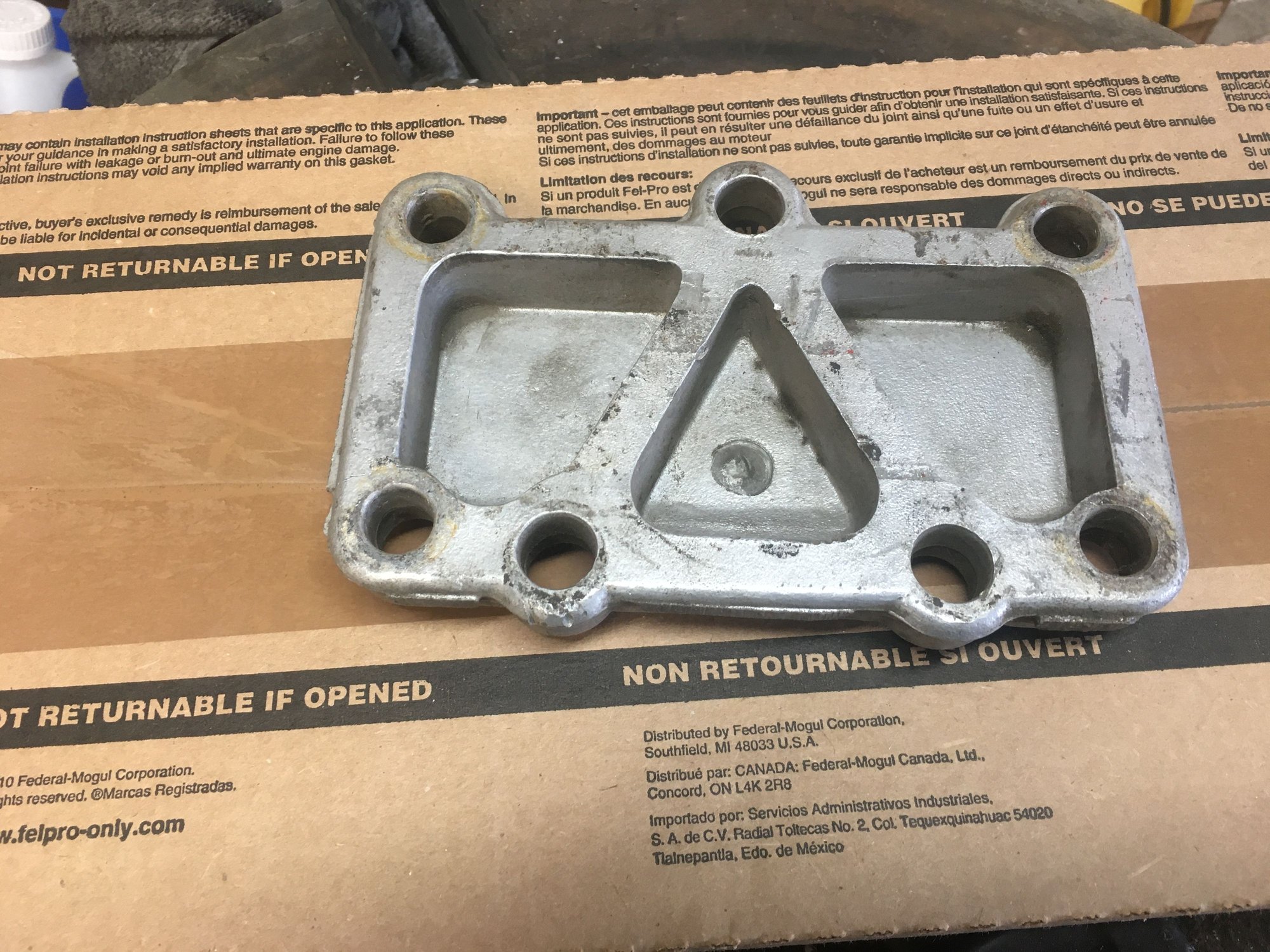

Old Mar 29, 2020 | 10:30 AM
69autoXr's Avatar
69autoXr
Joined: Jan 2004
Posts: 3,249
Likes: 210
From: Detroit MI
Long shot on a 15-year-old thread, but I see the OP is active here still. I am wondering if this is the part he was looking for?
Old Oct 29, 2025 | 12:38 AM
bren2426's Avatar
bren2426
1st Gear
Joined: Oct 2025
Posts: 1
From: Indiana
I just found this thread and I also am in need of this, exactly what is pictured from 69AutoXr
