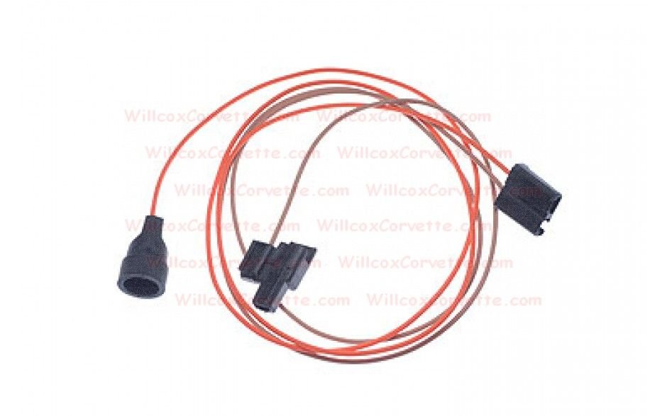

Today I looked under my car and guess what?
The switch was disconnected all together.
Now I put it back and traced the cables back to the kickdown switch at the pedal and to the relay on the firewall.
There the connector attaches to the relay but also to that relay is attached a green wire.
Green wire is cut in two!
What is that green wire?
