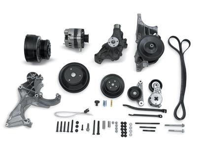

I know you said your not wealthy but this is a pretty good deal IMO. Like 750 for the whole set-up, may be more than you want to spend but it is another option.
