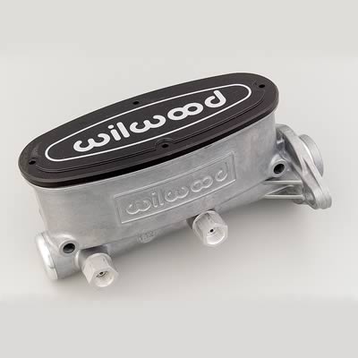

Since summit racing links dont link to the exact product click aluminum master cylinders then part number WIL-260-8556. This has a 1.12 inch bore. What is a manual corvette master cylinder bore? Could a master cylinder mod move me up a class in road racing?

It should be fine I'd think!
A manual master is 1" dia, Power is 1 1/8"
I have no idea about racing classes...

anyone know the bolt spacing on the stock MC? if that's correct it just might fit, the only other problem could be the center ring at the end of it, GM used several different sizes (I have a large one on my truck, it's much larger than the one on the vette)

I have a truck one on right now. Its from a suburban

I was looking at the plastic reserve version and you need to open up the holes like 1/8" to the outside to get them to fit.
