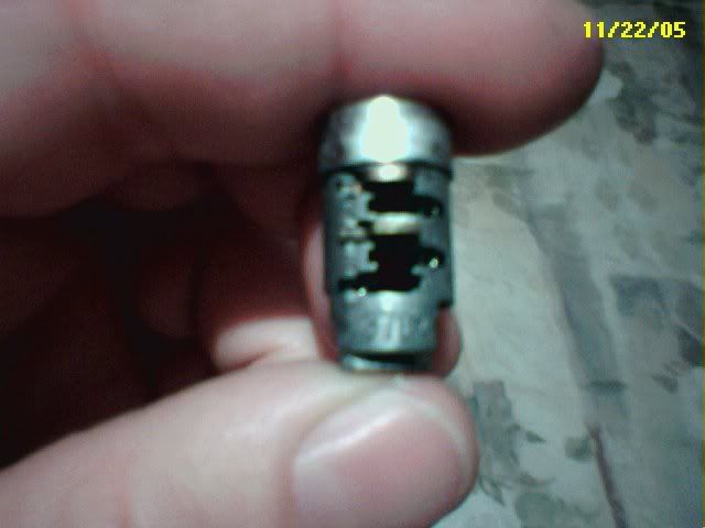

I just pulled my glove box lock ( it was already out of my car, redoing the interior) and if I could figure out how to attach a picture I could show you, but the code is on the clyinder plug inside the glove box lock on my 76. But unless you know what you are doing i would bring the lock to a locksmith, don't try to take it apart yourself. It is easy to get the glove box lock out, just remove the one screw holding the lock in the lid and push the plunger in to slide the lock out.

hey, i figured out how to show a picture....
anyway, if just above my thumb you can see the code, sorry kind of blurry, cheap camera, anyway just above my thumb you can kind of see the code, 37D3, thats what the locksmith needs. It is different for each car, so you have to bring your own.

You guys rock!! Thats all I needed to hear. I fully trust that the locks for the rear compartment are the same as the door and I could definately tell that there was no way those door locks have been replaced so they are the original ones. I am keeping my fingers crossed that the rear compartment area has never been replaced. I don't think it has been as the entire car seems to be original and in pretty good shape. Now I can get the door keys for the car, unfortunately the car cannot be moved from the garage until April due to 3 to 4 feet of snow outside. At least I can get the keys now since all I need to do is get the code from the rear compartment locks.
