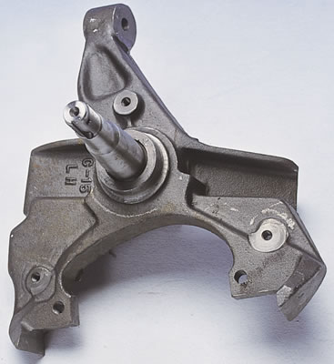

whats a drop spindle ?
It's a complete knuckle except the spindle part where the wheel bearings ride is raised relative to the rest of the knuckle by an inch or two or whatever. So the suspension sits at the normal height, but the wheel is shifted up higher. So the "spindle" provides the lowering and not the spring.

That's a VW drop spindle. The "axle" is moved up on the unit 2" from stock, which drops the car the same 2".

I lowered my 69 442 with a pair of Chevy S-10 drop spindles and by cutting one coil out of the front springs.
Rode and handled pretty good for what it was. Stopped better too because I used the disc brakes off the S-10.
In your case, the alignment shop should still be able to give you the proper alignment with 1/2 a coil cut. It does mean you will run out of adjustment sooner as parts wear. Drop spindles will give you the lowered stance without causing alignment problems. I've never heard of drop spindles messing up suspension geometry.
