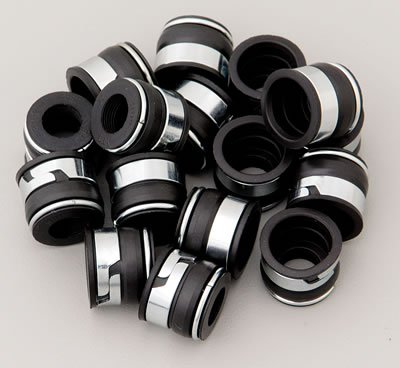

I am going to attempt changing valve seals for the very first time. What brand/type should I get for my stock 350?

Viton.

I am going to replace my seals tomorrow.. Also what you might want to get is the umbrellas that are pictured above..

so the viton seals can only be used if the stems have been machined?
otherwised ford umbrella or "vega' seals?

I had very good luck using Perfect Circle #VS-2 a few years back on my 1979 L-82. Also put the stock O-ring on with them. Ron B.

Originally Posted by driver68
so the Viton seals can only be used if the stems have been machined?
other wised ford umbrella or "vega' seals?
I have used both of these seals with good success in the past. I believe the Vega seals were even made of Viton or a very similar material. They did not have the metal reinforcing bands on them (as those above), but held up very well to cylinder head heat.
Normally the Viton as shown above do not require machining... Teflon seals on the other hand usually require machining. I have used (Perfect Circle) Teflon seals on a couple of vehicles in the past, but these are not normally recommended for street/daily driven use.
A lot of folks do like to double up with the stock Chevy "O-ring" seals, but my experience is that they very quickly harden and become brittle. I have never removed a set that didn't crumble as I was removing them. If you are using any of the above seals, the "O-ring" seals are undoubtedly a waste of effort... admittedly not much effort...
