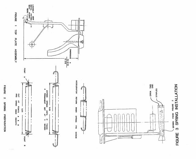

My 76 may have similar issues with sock. Slow acceleration does not have any issues, but under heavy acceleration, when RPMs reach 3000 or better, the shutdown begins. I was going to drop off to a mechanic for this unless there is a "reasonable" method of replacing or viewing the condition of the sock to verify condition and/or replacement. if you have a method of doing this, could you please detail it for me. Thanks.

There was a Chevrolet Service Bulletin on the 1976 Corvette where the fuel pick-up tube was too long and was restricting the flow of fuel. Also in that bulletin was a tip on inserting a spring inside the fuel sock to keep the sock from collapsing and restricting fuel flow.
This is the service information as reprinted in the March 2010 issue of Vette Vues Magazine.
For you people with 1975-76 Corvettes shortening the pick-up pipe so that its overall length is between 10 5/16 and 10 3/8 inches may solve your high rpm problems. For the others, the "spring in the sock" is probably a pretty good idea.
