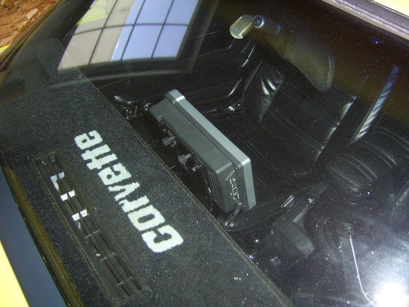

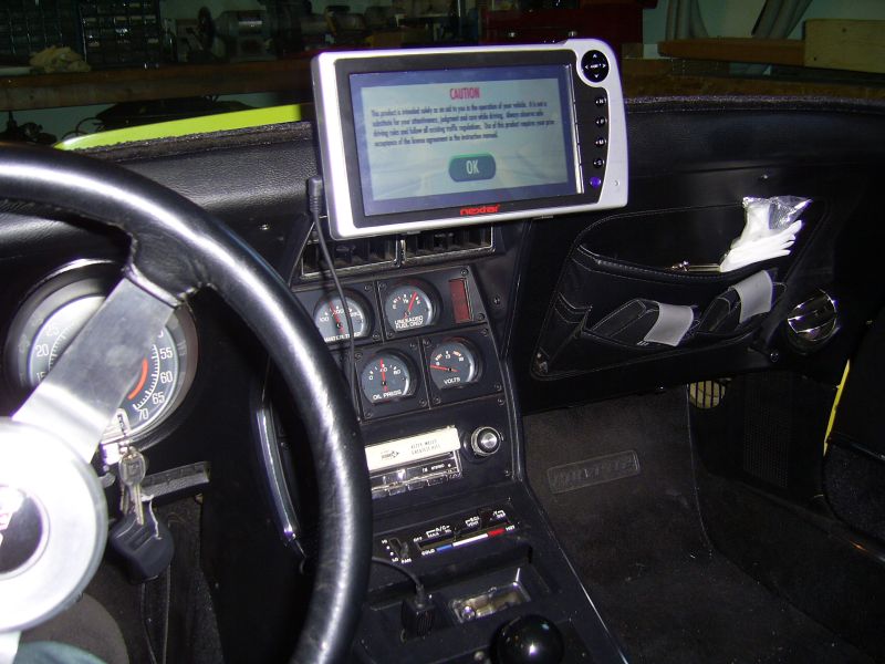

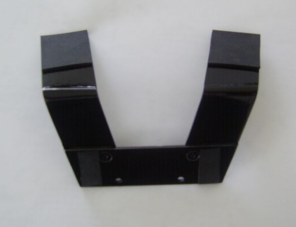

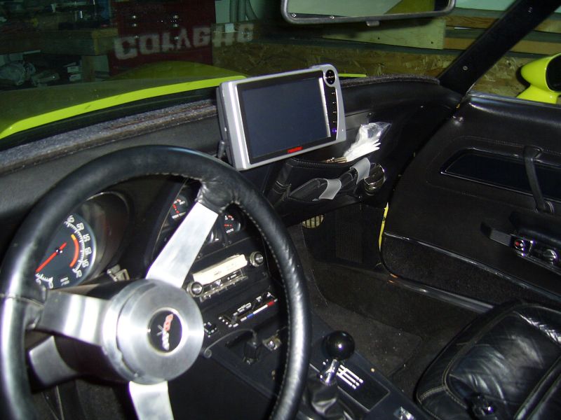

I have had problems trying to find a place to mount my GPS. There is not sufficient room between the dash and windshield. Other positions that I tried either blocked instruments or the vibration made it unreadable at times. So, this past weekend I fabricated a bracket that uses the upper two screws that retain the center instrument cluster. It worked great without any vibration and no cuts, holes or bruises to your interior. Here are some pics of what it looks like.

That looks really good. I will be putting my GPS in also but mine is much smaller. Good idea on the mounting location too...I like it. Do you have any visibility reduction? Looks like it towers over the dash there.

When you are 6'2" believe me nothing towers over the dash :-)
