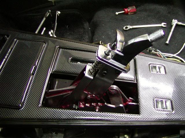

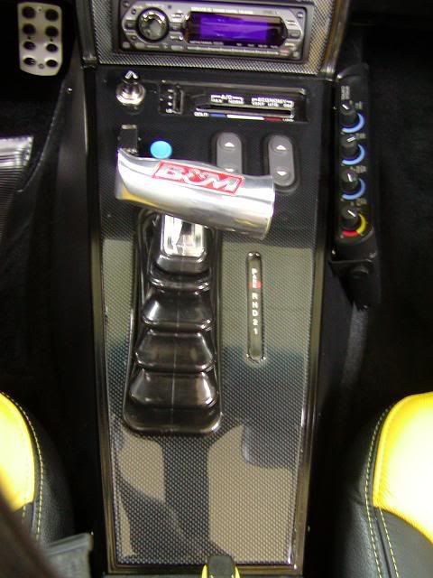

I had mine installed exactly like this, indicator and all, but I couldn't find anyone local to make me a shifter boot that would work. I wanted to remove the ashtray and install my switches there anyway so I just built the modified console. To get mine under the stock console I followed the same procedure you described, a brass drift and a hammer to square up the rear of the floorboard indent. And yes, this project is a PITA.
I was this far and changed directions:
My modified console that I decided to go with:
Jetmech, nice install by the way!

Thanks Gyopp. Actually I studied your pictures you posted before I started my install. Great info by the way. As far as the shifter boot my wife and I made the boot out of some aircraft leather I had laying around. Luckily the car is red. Thanks again for your posting. I need to get all of my pictures together and post them for some other folks asking for them. Your finished product looks very proffesional and I am sure gets loads of comments!

indicator brackets and light
Shot of shifter installed red spots are sealant sealing stock shifter mounting holes
shows cutout of support and also where paint on tunnel is missing where I massaged for fit of the shifter
This picture shows the cut out of the bottom mounting bracket and the grinding off of the forward plate for clearance Shifter is pulled back into first gear and held.
Right side of shifter with forward plate and notch that was ground for clearance.
An
other picture showing the tunnel mods. I installed rivnuts into the tunnel to hold the shifter down. There are 3/8" spacers under the back of the shifter.
Another shot. I hope this helps glensgages. Lookup Gyopp's post. He did a great looking install and that is where I got a lot of info. I am like you I wanted the shifter to fit under the stock console without cutting it.
