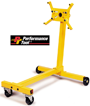

Save yourself a TON of downtime and $$$
buy one of these
and park your engine on it and leave it alone!!!
drop a Crate motor in and be done.... easy weekend project
