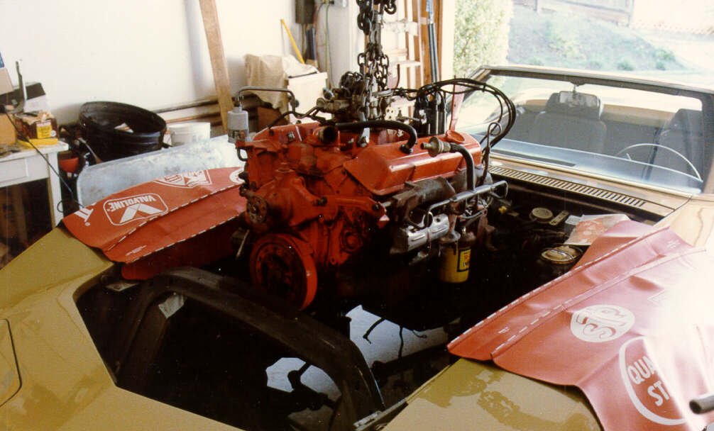

Here' my tech tip I wrote a few years ago.
https://www.corvetteforum.com/techti...=167&TopicID=3
I pull my engine and transmission as one. I recommend an engine leveler and remove your hood. As added insurance I put a piece of plywood on my radiator "just in case". I can tell you that my ZZ4 is not a DOG and I know that it is not losing approximately 30% of it's power as suggested above. It is probably putting down around 290 to 300 to the road.

When I swapped out the engine in my '69 convert., I left the 4-speed Muncie in the car, and supported it with a floor jack. I did the entire job by myself in my home garage with a rented cherry picker. With just the engine to be concerned about, it was easy as it came straight up and out. I was somewhat concerned about lining up the trans input shaft to the clutch, but when I got to that part, it went smoothly. I made sure the engine and the trans were level and aligned. After jiggling the engine and rocking the car back and forth a bit with the trans in 4th gear, it went right home. Here's a photo of it coming out. http://www.myruffhouse.com/Out%20with%20the%20old.JPG
I did the same thing but I didn't even pull the hood!!
I think ill remove the hood
