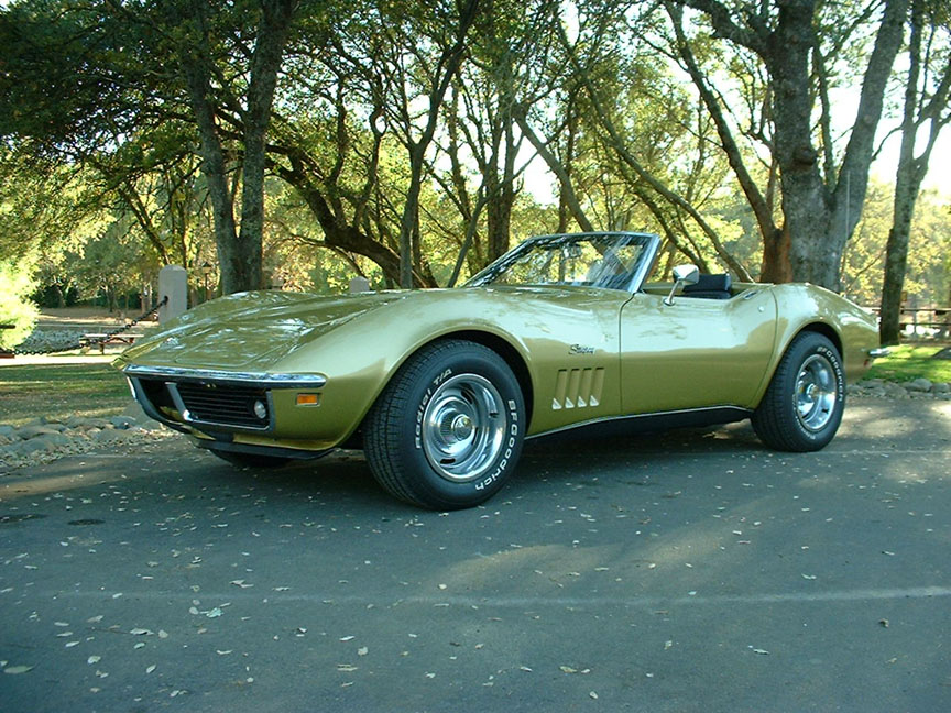

Hi mateo279,
For what it's worth, I put a GM LT1 highrise intake on the motor I built, along with a 4150 Holley and the stock aircleaner - is it what folks call a drop center? I think the Performer RPM is an approximtation of the LT1. When it was all together, I put dabs of Playdough on the top of the air cleaner and closed the STOCK, not LT1, hood and found I had about 1/2" of clearance at the closest point. The rim of the air cleaner is flush with the top of the chrome box covering the distributor now, I think it was about 1/2 inch lower with the stock base motor setup. Here's a photo http://www.myruffhouse.com/images/1969_Corvette_10.jpg (Please ignore the C4 logo, it has been replaced with a C3 crossed flag logo.)
So I would say, give it a try and see if your stock hood fits with what you have now.
