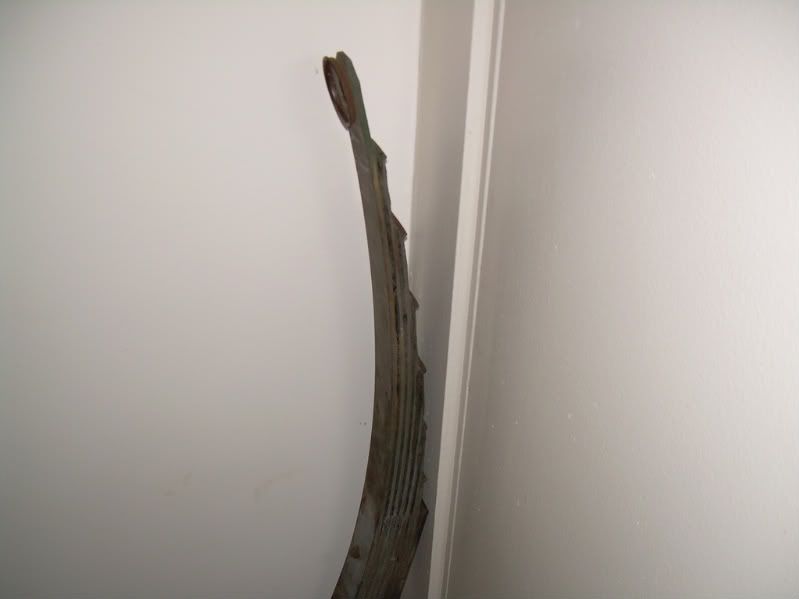

Originally Posted by neilo
Well i helped the guy put it in last summer and he bought it new. I am referring to the clamps towards the ends of the spring that bind the 3 or 4 longest springs together.
I got my factory one in the bedroom (yes I am single ) No clamps on it, stock. The repalcement I got has clamps- piced. Factory doesn't need them.
Old Mar 7, 2008 | 07:27 PM
neilo's Avatar
neilo
Joined: Apr 2007
Posts: 44
From: Worden Montana
Thanks for the pic it shows exactly what i was wondering about. What keeps the springs from spreading out like a fan. Is the mounting bolts on either side enough to keep them together? I went ahead and bought the spring just wondering if it is safe to install it.
the 4 diff plate bolts touch the spring, it's a very tight fit, also the plate bolts are torqued to 65 ft/lbs. like I said, they GM stock springs don't have them, and it appears the leafs 'seat' to the plastic liners very soon, so it won't spread, because it can't. C.
