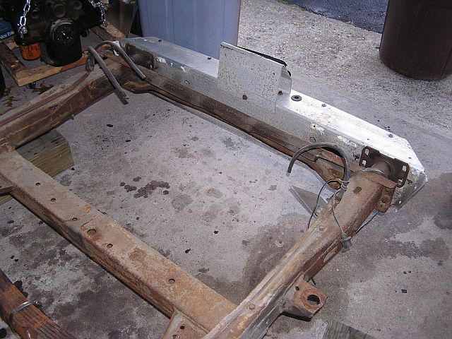

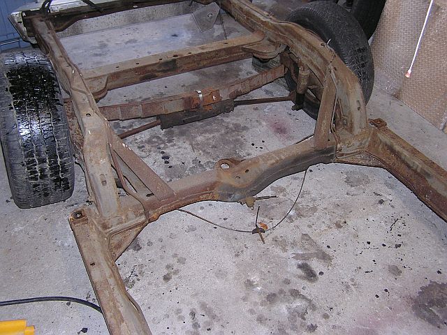

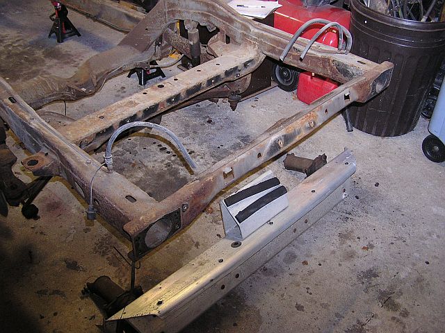

Can anybody tell me for sure what model year the chassis below is designed for please?
It was installed under my '76 but I'm sure it's not the original chassis. If anybody can give me clues on how to identify it accurately I'd be very grateful.
So far I've learnt:
- '68 chassis don't have the diagonal braces at the rear kick-ups
- the rear cross-member suits a rubber-bumper car
- a friend's '79 has a rear cross-member that is a different shape
- the fact that the welding on the side seams over the rear wheels is continuous (rather than spot) indicates it could be a later chassis
I can provide more photos if it'd help.

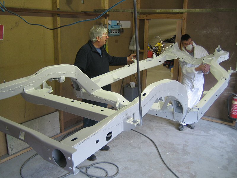

It's at least a '75 or newer. Try the driver's side frame rail, near the rear kick-up. (near the guy with the blue jacket) However, it may have been ground off during the sanding. I think I may have also seen it on the driver's side, upper, rear leg. All on the top surfaces.

That is a '75-'77 automatic transmission frame. Identifiable by round holes for impact absorbers in the rear crossmember that started in '75. The rear crossmember was changed again in '78, the holes were square and the crossmember had a different shape.
That's great information. Thank you very much.

I know someone said automatic but I see the bracket for the Z bar which would indicate a 4 speed car. Unless bracket was just welded. I was thinking 78 - 81 frame
My '76 is a 4-speed L-82.
This is another reason why I think it's the wrong chassis for the car. No frame VIN + wrong cross-member. But it does have the clutch linkage bracket.

What year did removeable cross members start. I know in 78 - 81 if you had a speed it was removeable. I think in 1980 - 82 all crossmembers were removeable wether Auto or Man.
Here's a pic of the rear of my 81 frame
Maybe a new frame from the guys in Michigan. That is why no vin. Your original may have rusted out.
Your frame looks the same as the frame on a friend's '79.

I could, except the chassis has a bolt-in crossmember and therefore can't be original. There's no point trying to pretend it's original.
Also, I've just finished painting it
I don't mind that it doesn't have a number. I'm just trying to learn as much as I can about it while I'm doing the body-off, so it's good to find out that it's a '75-77 chassis and therefore it is roughly correct (as are the components that bolt to it).

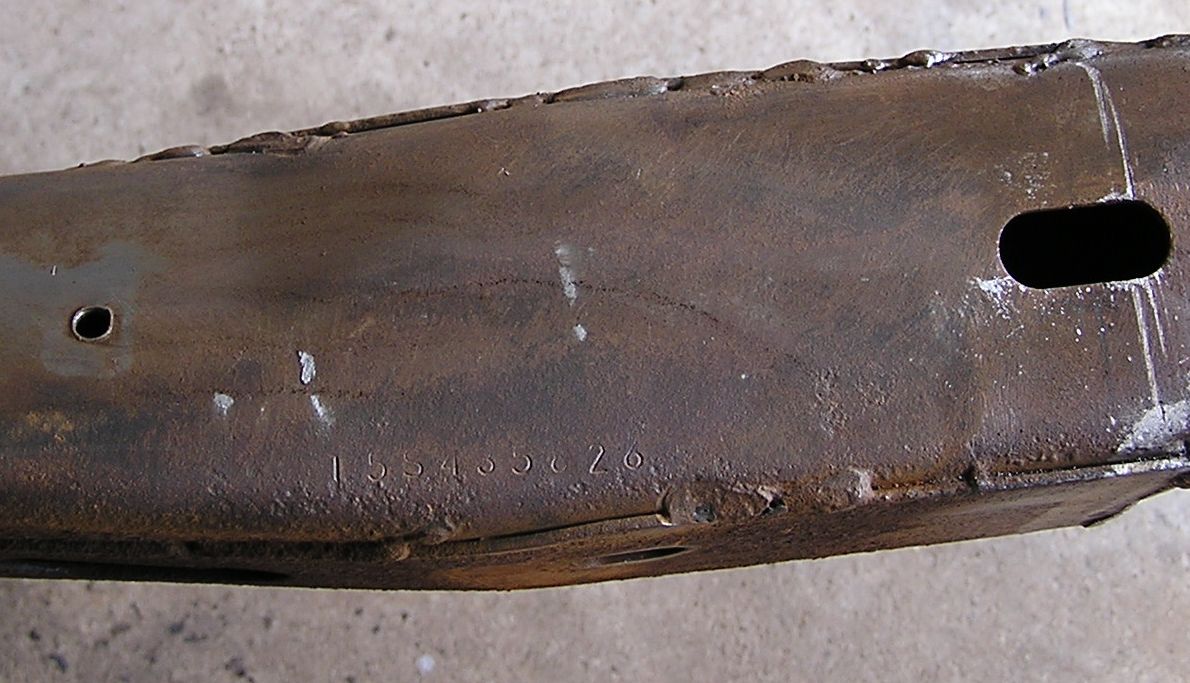

Here are some pics of a '75 frame w/numbers. This is the frame I used on my '73 with some mods.
