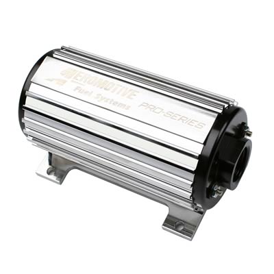

Aeromotive also sells a speed controller. The pump runs slower at low engine rpms. It runs at full speed above 3000 rpm. It's pricey. About $200.00. I have the controller and the Street and Strip "T" shaped fuel pump. I can't hear it when the engine is running. I have the factory 69 sidepipe mufflers.
