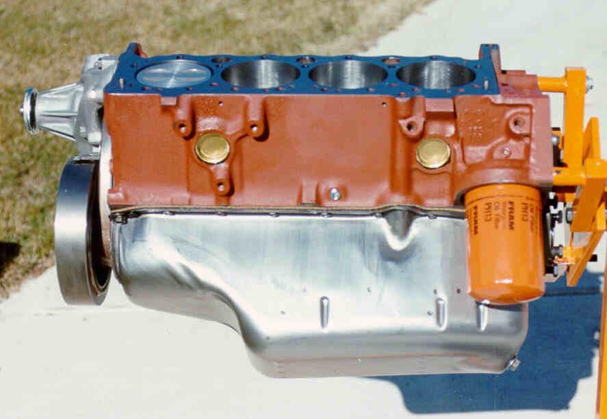

Here's a shot of my block during assembly. Note the silver color plug just above the oil pan rail, between the two freeze plugs. That is the coolant drain plug, one on each side. No need to remove the freeze plug.
Cheers,
Pete

Thanks, I notice them late last night after DB note. Hope to open them on Monday.
