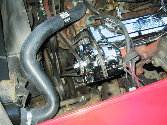

Got a 105AMP CS130 off eBay, NEW and Chrome.
Here it is installed.
Wish the rest of the engine compartment looked that nice!
BTW, the GEN light went out!!! Al is good! Thanks to all the advice and help!

Looks great, good work.
