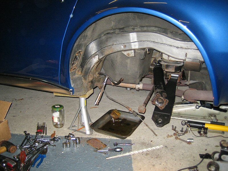

I removed one of my trailing arms on January 5th to replace the bearings and the bush:
While I had it off I thought I'd do a couple of other small jobs.

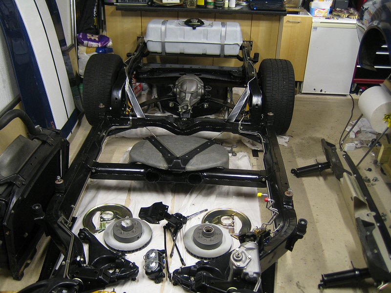

This is where I got to yesterday:
Full story here:
http://www.corvetteclub.org.uk/viewtopic.php?t=5429
While your T/A is off I'd check the condition of the diff. Maybe remove it, take the cover off, check the gears, and replace the lube. Chances are it's never been changed.
And I wouldn't do just one T/A. If you're doing one then you should do them both IMHO.
