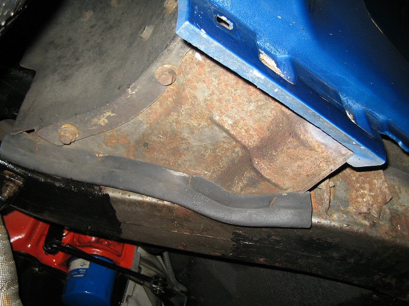

Pre disassembly on my '76:
That's the driver's side.

Thanks BenUK, the photo of your shields look just like the ones on the floor. I do have an open area there where the sidepipes come out. I'll see if they can be installed without pulling the headers. If not, it won't be a problem as the beast will never be driven on wet roads.

I installed mine with the side pipe headers in place. I would recommend you install them. THey help keep your engine bay clean.

They also give the inner and outer fenders some rigididy (stiffnes).
Being fiberglass, I'd be worried about cracking the fenders or inner wells from flex without running the braces.
