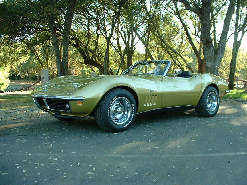

I've had them on my '69 convert. since, oh about 1972 or so. Not the same tires of course. I've had BFG Radial T/As and Goodyear Eagles. At full lock the inside rear of the tire rubs on the frame, otherwise they don't touch anywhere.

If you go to the 255's there may be an issue with trying to get the wider tire in the spare tire carrier. I had 235/60's on my 73 and had trouble getting the spare in and out of the carrier. Also the speedometer diddn't read correctly. I just bought 5 new BFG' radial T/A's in a 225/70, no rubbing anywhere, the fully inflated spare fits nicely in the carrier and the speedometer reads accurate again. they're identical to the tires on "PETEZ06" 's vert above. <<Steve>>
