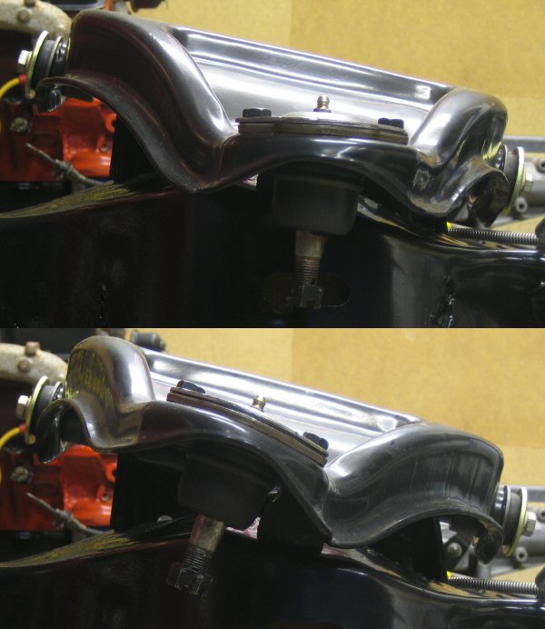

BenUK's Avatar
BenUK
Joined: May 2005
Posts: 1,145
Likes: 5
From: South of London, Engerland
Originally Posted by 72LS1Vette
If you look at the upper arm, the ball joint should be tipped toward the rear of the car. I would guess the car would be undriveable if the arms were reversed because the suspension geometry would be so far off.
I don't think the suspension could even be fully assembled with the top arms swapped left-right. The upper ball joints would be at an angle preventing reassembly.
Camera horizontal:
Top photo: correct A-arm.
Bottom photo: right-hand A-arm fitted to left-hand chassis mount.
When the wrong arm is installed, the ball joint is too far forward and tipped back too much.
