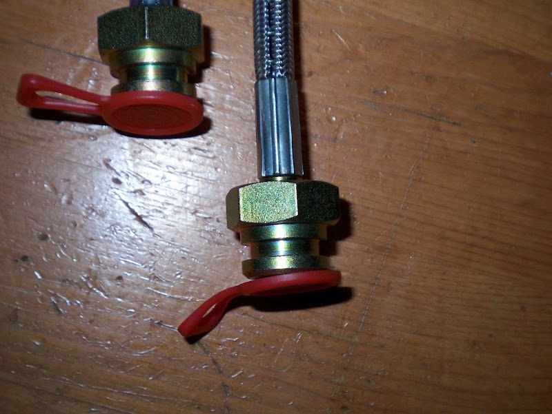

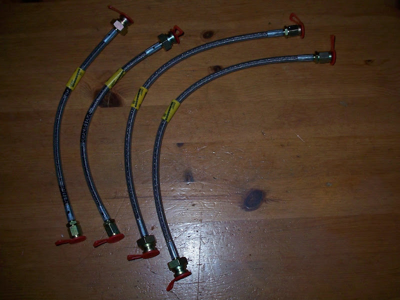

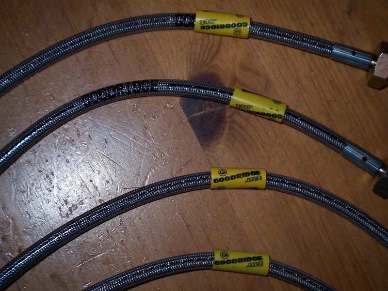

From: Hazerswoude-Rijndijk Zuid Holland
Solved the same issue, bought myself new Goodridge SS lines.
I know they are only hoses but look at them what quality, excellent. Braided with silicon cover. Guaranteed forever.
